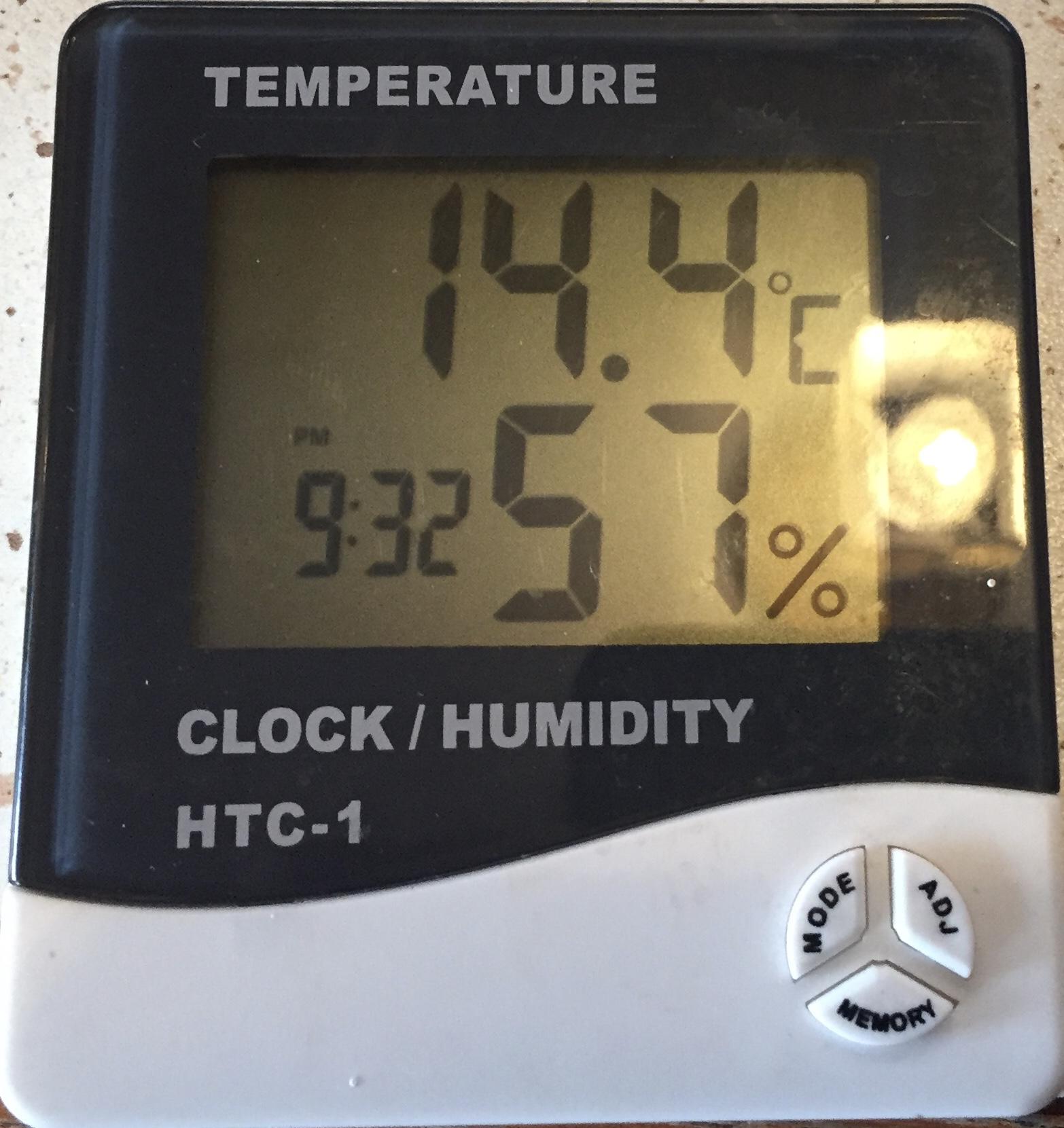

12.9*C in my new top bedroom at 7.45am today (& only 14.1*C at 9am)!! I've been giving them these figures too over last 2 cold weeks.

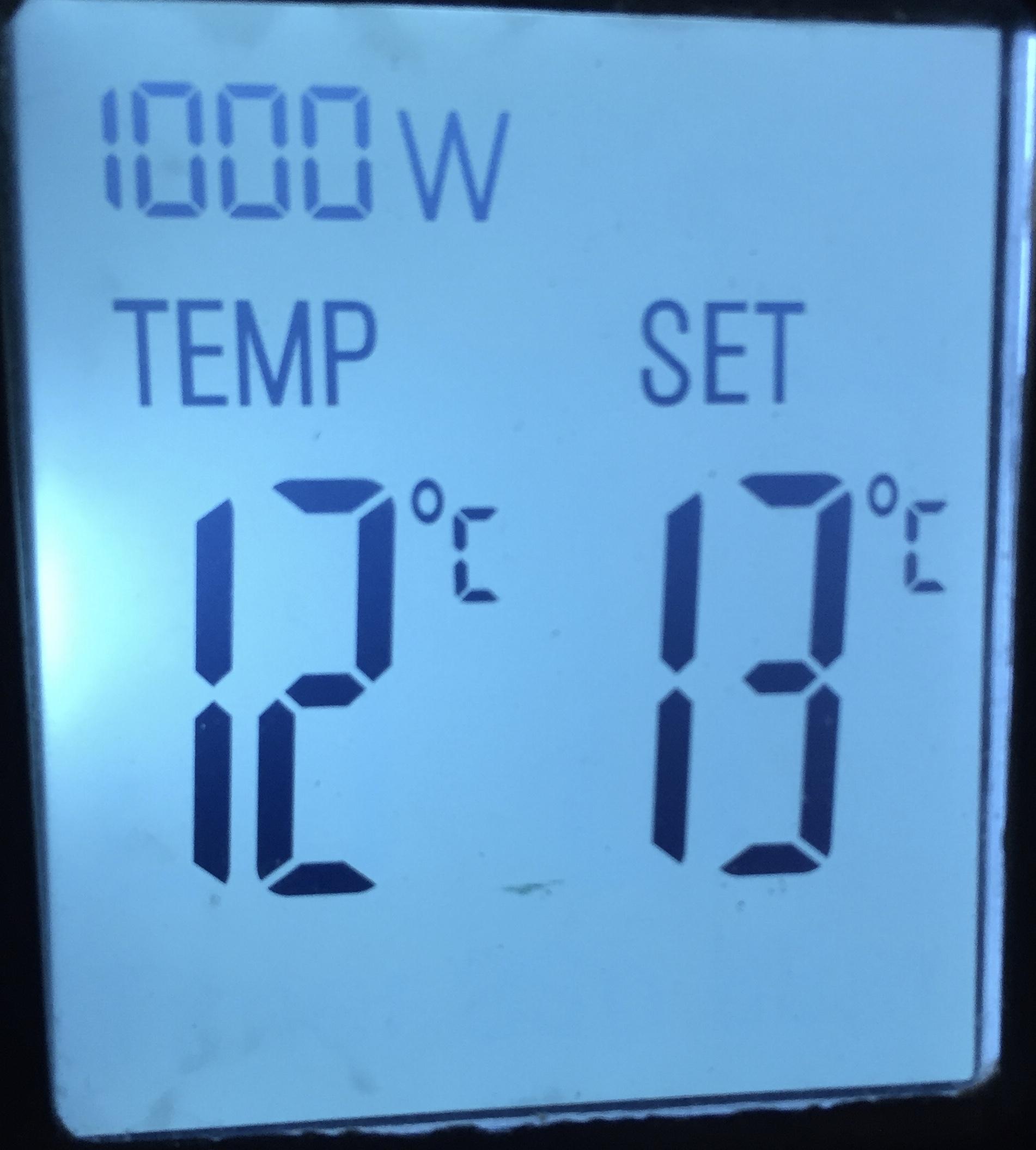

Living the dream mate I only set my heater to 13c and feel happy this morning as the temp is  14.4c  (no need for a reply....  it just gets my goat that you whine  about being cold all the time)

@Cpd well you might be living in a dog kennel I dont know. Sorry but I'm cold at 8am simple as.
0.4*C increace in 4 hours in a new build room. You think I shouldnt complain about this/ a system with repeated faults, this poor performance seemingly another. Wrong- I bloody well should be complaining. & many saying here its not even fit for purpose.
