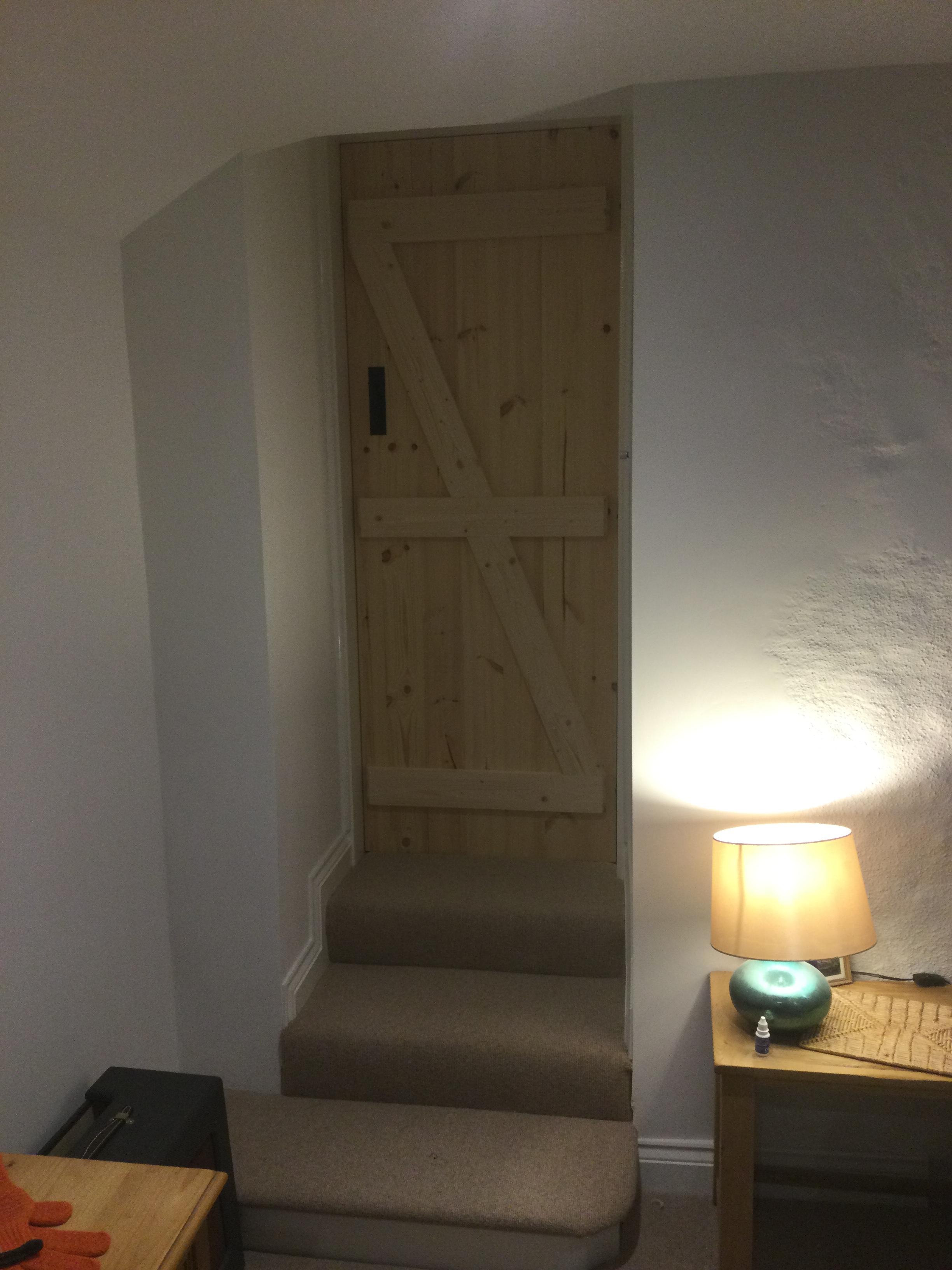

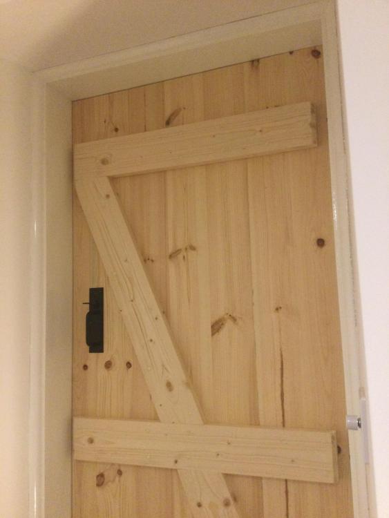

@Adsibob good well i did decide on three equal steps as you can see here.. and my door hung at last. Mm precision needed to do the hinges on frame 1 st.. tricky.  Pesky plant ons to do, latch to chisel out on architrave/ far the easy bit.
Its perfectly skimming carpet, perfect 3 mm gap around.. but ground floor doors swell and contract alarmingly, so if i get any of this happening im stuffed. But mm spot on as is, prolly a smidge too much tbh.

@zoothorn that looks fantastic, well done.
If your door swells in the summer, just take it off and take some off with a wood plane (incrementally... you don't want to take too much off).
