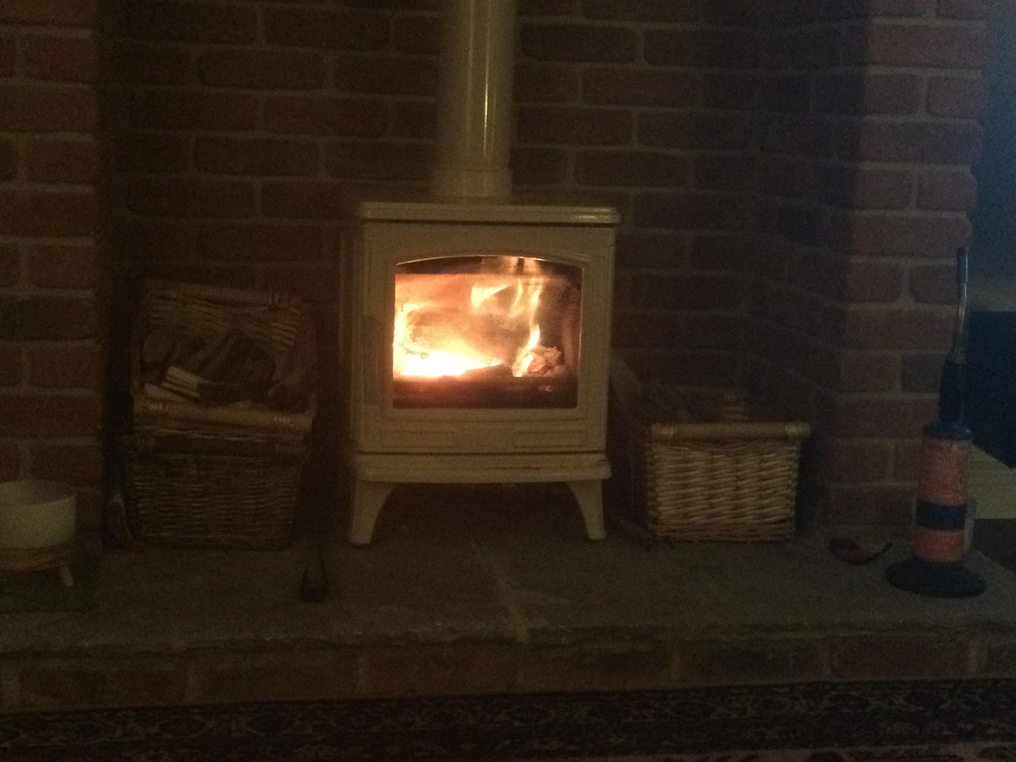

Because the house is up to temp (21.5’) and DHW tank full of hot water (48’). Oh, and because the wood stove is lit taking the lounge up to 24.7k (phew). Even tho it’s freezing outside (I know because I just put the chickens in.  Bbbrrrrrr.)
smug emoji
Edited by joe90
