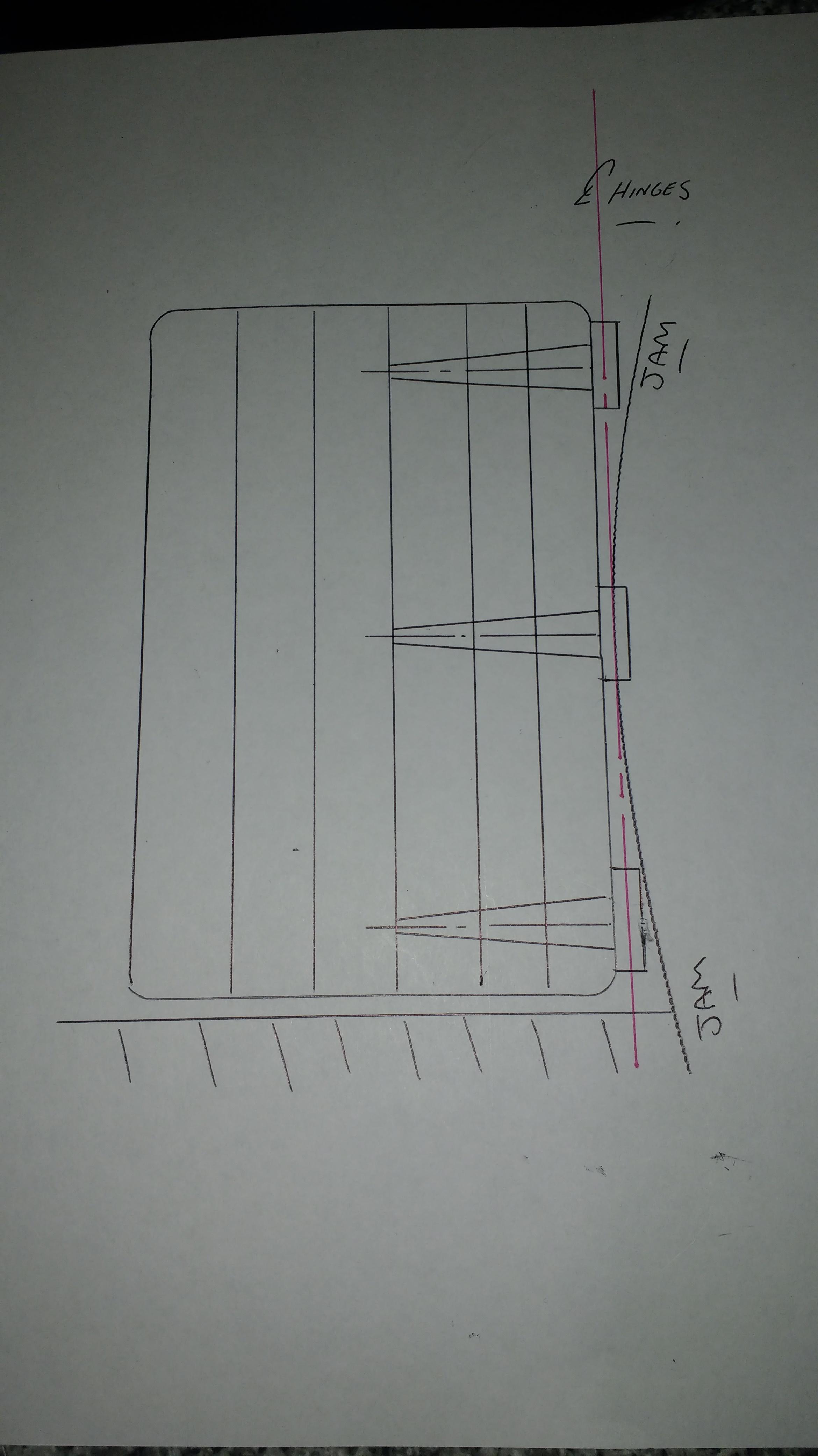

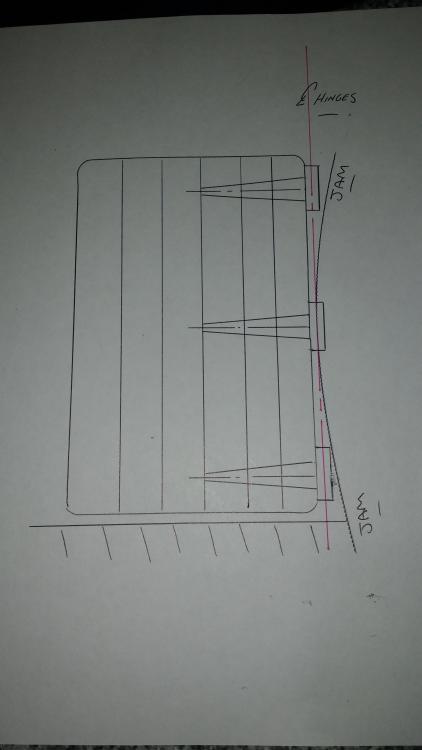

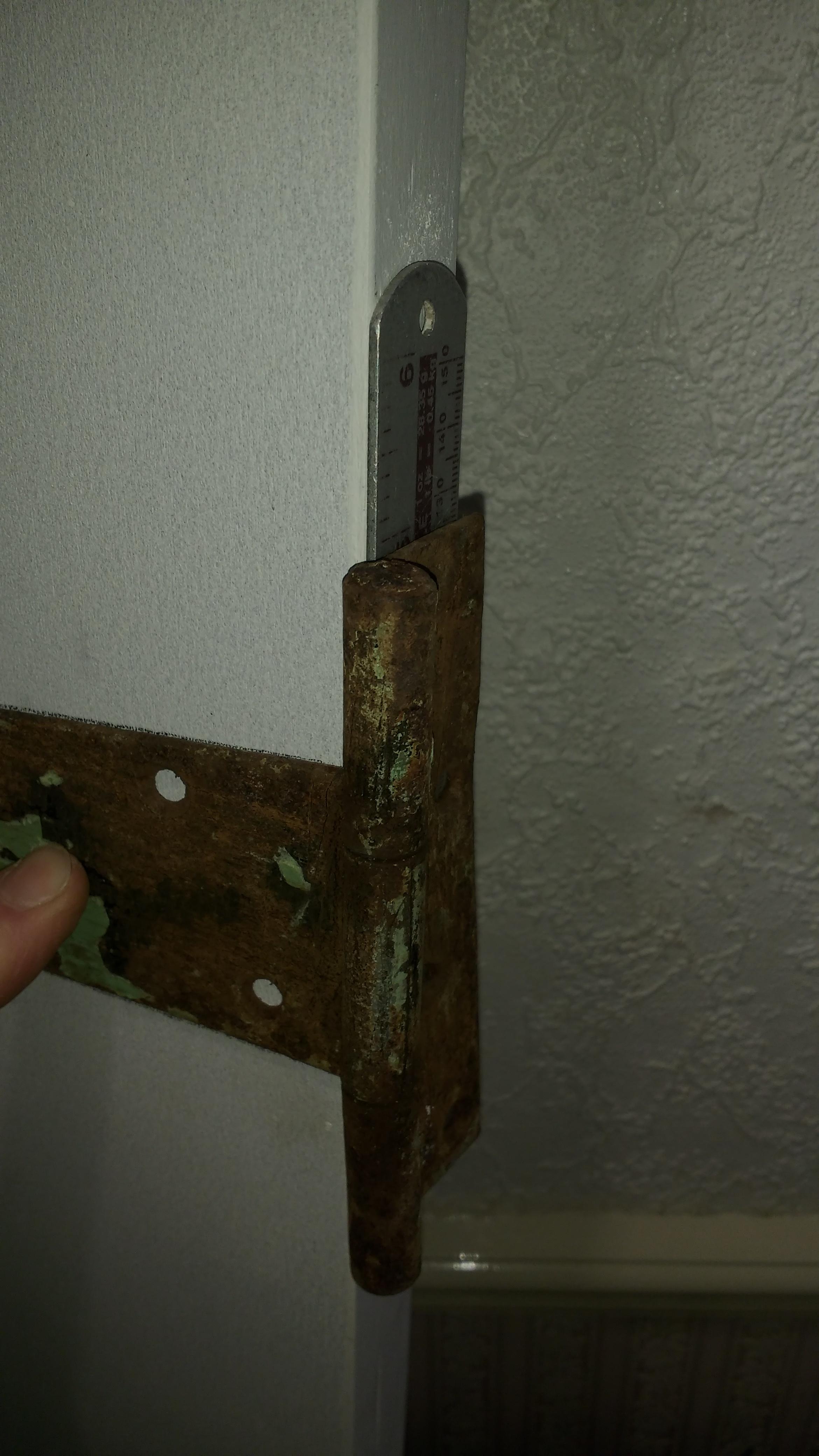

@Onoff i get you idea of centeline, mid ledges etc spot on, & all 3 marked on door.. but my plan was after this, to fit hinges to frame 1st.
I think your reply with 3 useful pics, is to fit ( as is usual, understand this) hinges to door 1 st ?
Now bc of this damn bow in of frame, i think fitting hinges frame 1 st is advantageous, and your way/ usual way is at a disadvantage. But i cant remember why. Bllx. Something to do with correct gaps and door opening right im sure was thinking.
 Can you make any sense out of what i cant actually remember?!

Your door is your straight edge hopefully. Certainly a darn sight straighter then your bowed jam.
Your 3 hinges MUST all be in line!
This gives you a constant to start with at least. If you're unable to straighten the jam you have to live with it. Pack as required.
The only way you might get all 3 recessed into the jam is by first packing the hinges out a bit. Otherwise the edge of the door at the middle hinge (in my sketch above) will hit the jam. Hope that makes sense! Packing the hinges out a tad before screwing to the door gives you some wriggle room. The recesses would of course all be slightly different depths.
It'd help if you knew how far out the top and bottom positions were. Out of interest did you ever buy a laser level (suggested I think during the kitchen build)? Dead easy to see how bowed your jam is then. You just line it up on the jam edge and measure to the laser line. Surprising too sometimes when you've always relied on a long level up until then.
