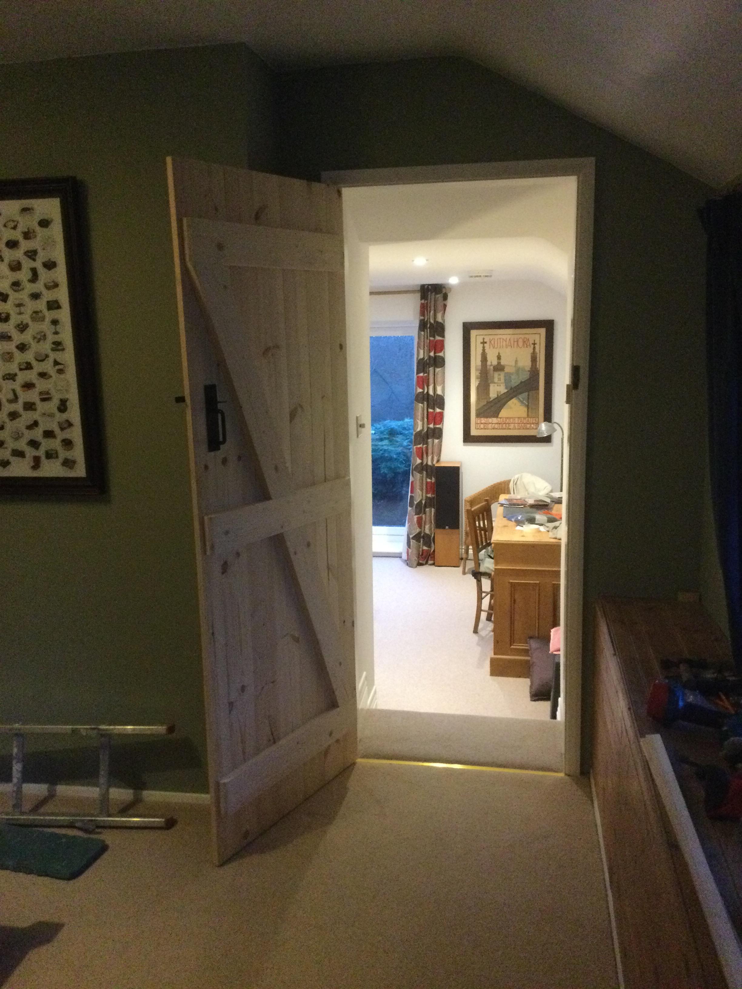

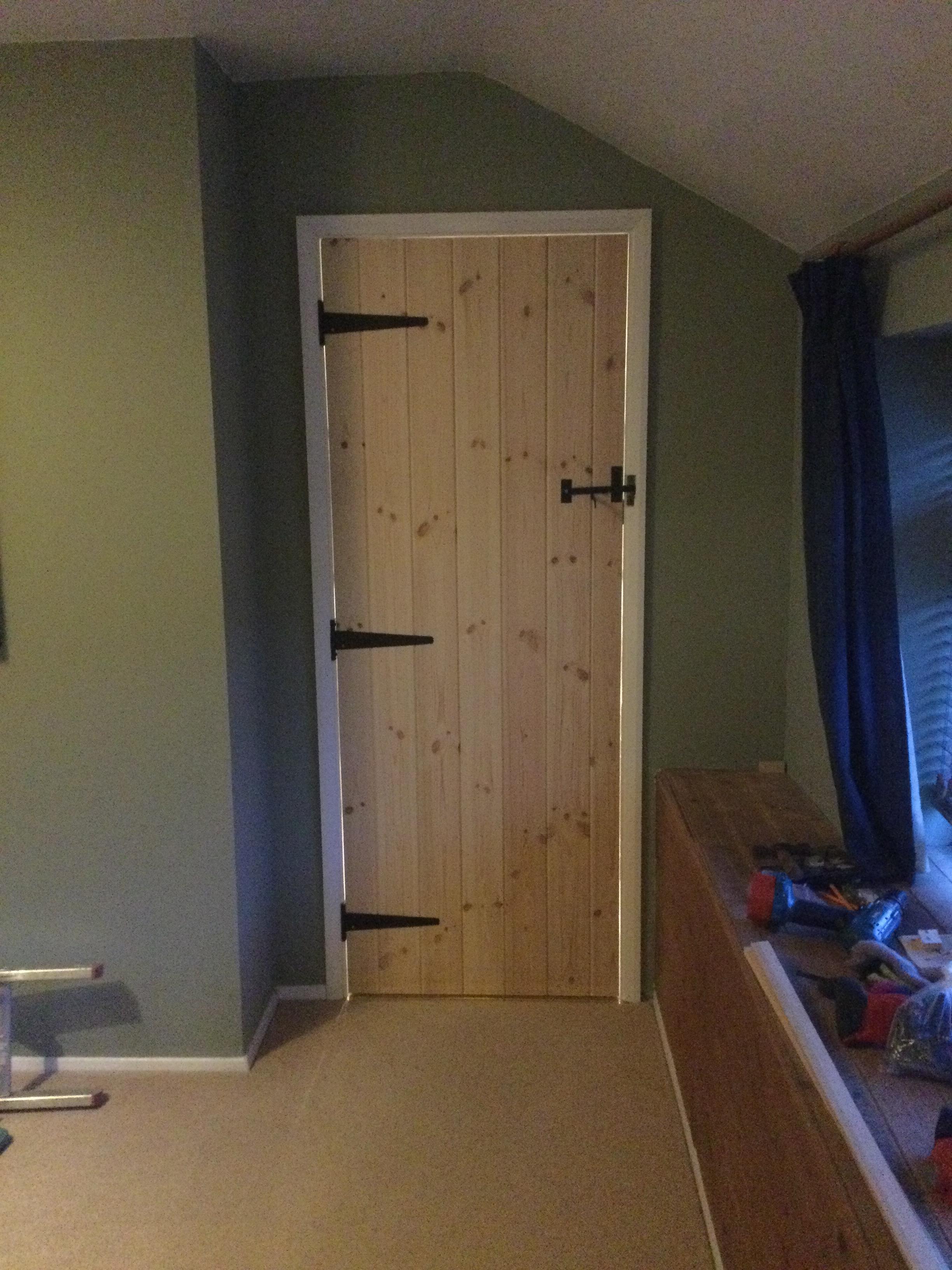

All along I could have sworn the hinges were going the side the lock is! ?
Yes i saw you thought this.. but didn't matter I could still follow your tips.
Yes hinges were originally going that side.. but thought door open might obstruct window. Also same now as bed2 doors hinges. The right choice.. i think.

I'm NOT saying do so at all but a little embellishment you can make with these doors is to run a router around the edges of the ledges and braces. Rounds the edge over and saves you catching your arm, hip etc as you brush by.
Done exactly this, not on the diagonal braces but the 3 ledges. Copied my orig C1830 kitchen door's ledges. I'll do a closer pic later.
Onoff whilst your there.. One irregular ditty to think of before i nail on plant ons: my latch/ handle side of door has a bit of a warp, 5 mm only, but if i  were to set my 3 x plant on strips perfectly 20 mm door depth ( plus your 1mm OCD paint allowance!) all around..
the top  of the door would sit 5 mm off the plant on,  & the middle of door correctly sitting on it. So my thinking is - follow - the slightly irregular door warp profile & add plant ons accordingly.. so it'll sit perfectly onto them, resulting in it closing a little proud of the frame, on the face side top rhs but hey so what.
Is this is preferable to fixing plant ons perfectly @ 21 mm depth, all round.. & having an annoying gap between door and plant-on due to the warp? Or do i sort of set the latch hook plate in a bit, & sort of squeeze the door closed/ forcing the door a little each time closed.

I don't suppose Onoff has a clue about my plant on question.. anyway need bloomin nails for them now. lost heads best?
Got a really good fit of my latch on the catch, snug & tight onto the temp stopper behind, pleased, right faff to do this.

Looking good mate, personally I hate doors that rattle, so if there is a little warp that means the door is tight when it’s shut that is a good thing, plus fir an old cottage things are allowed to be a little wonky!!! (Yes lost heads).
Agreed. Call any wonky bit character!

Ok understand my plant ons best follow the door contour. Thx.
