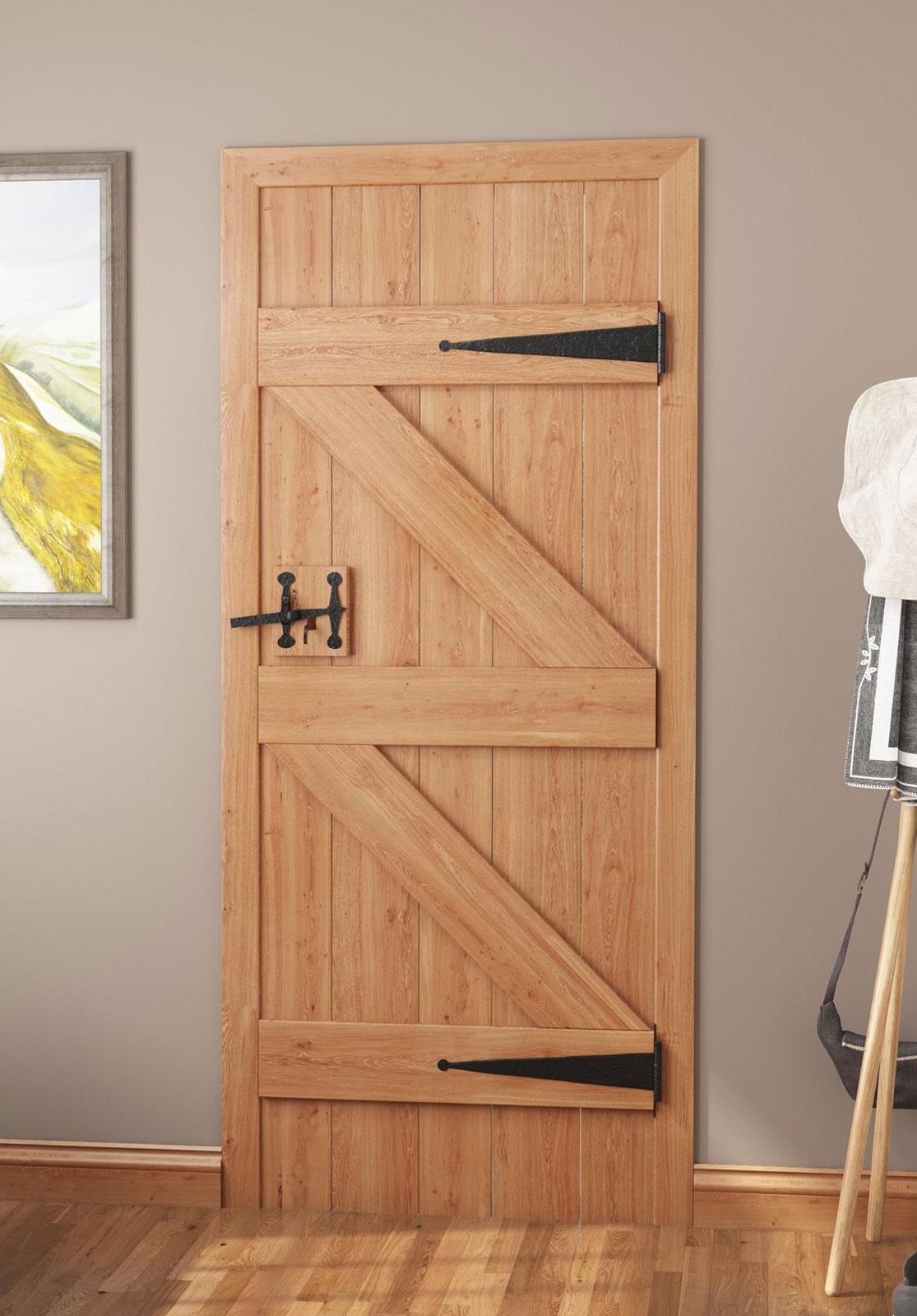

Aha ok that makes sense. Right hinge here ( not fixed obviously). 10" long the door side: i hope with 3x instead of 2x like my other bedroom doors i think 12" jobs, they'll be sufficient. Door is bit thicker @ 20mm (plus 25mm ledges, chosen just in case I need to put PIR on the back).
@zoothorn, cracking job and duly liked. Can I ask why the hinges are going on the 20mm door and not the 25mm ledges like this one? I'm not 100% sure what way your door is opening, into your new room like this one?
Or is it that you come out of the new room, up the couple of steps then the door opens into the old room with the hinges on the left?
I tend to draw a light centreline on the ledge and fit the hinges to the ledges first. Then prop/wedge the door in the hole and mark where the hinges go onto the jam.

@Onoff no sorry my photo is misleading, hinge just plonked on for idea of how far in it should go, and not even on the correct side here (it'll go on the other 'front' side, 3x of them on the ledges.. unless 2x is recommended instead).
So in your photo, mine will be different: as you exit new room, up 3x steps the door's ledge & brace side visible (& thumb latch will have to be on the LHS the only caveat), and door will open away into the old bedroom, with hinges on the RHS as you walk thru.
The hinges will be in old bedroom side (the architrave side) with the 'front' of the door this side, and the wee latch thing on the RHS.. which will look a bit odd but no choice. So my ledge side of door.. will sit on the plant-ons. This is 'goofy' as it were (snowboard talk, I think).
I understand that fully...which is a first! ? Sounds like a plan!
