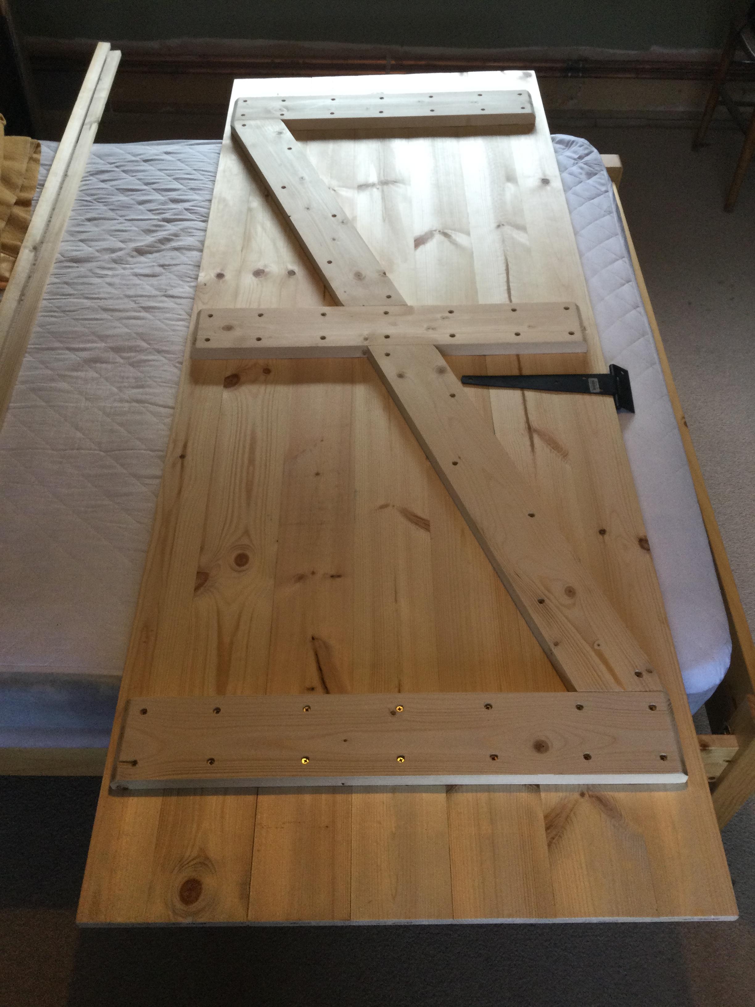

@joe90 or @PeterW or @Onoff I'm just continuing with the door fit. What to do next..
Ive got it trimmed best I can do, hopefully 1mm above carpet or so opening out, 4mm gap to frame above (2mm gap hinge side, 4mm gap latch side).
I expect it expand a bit, being a very moist climate (black mould @ french door reveals already formed), so given an extra few mm's up/ down: I assume this is the more likely 'axis' it'll expand rather than the ledged L to R.
Ok is the next step to whack on my frame plant-on 3x strips? @ exact 20mm depth, as per my door thickness? I guess so.. but just checking 1st. Then Ive got a stop all round, to offer door up very exactly using placcy packers I think is the idea.

Yes good idea re gap, I hate sticky doors and people tend to forget about paint thickness. Personally I like to hang the door including the catch first then apply the stops to fit the door exactly.
If you recall one of your other threads we said to close your door then plant the door strips on using 1mm packers between them and the face of the door. When you prime & paint it'll take up that 1mm gap.
Ok so you're proposing not fit the plant-on stops next then.
I understand your reasoning to hang door 1st/ to get the more ideal fit onto the stops.. but I don't know how I can hang it & position it etc, without it falling fwd into room without the stops being there 1st to help me.
Hi Onoff. I do recall the suggestion, but now coming back to this info actually doing the job, I can't quite understand it.
Ok firstly I'm not painting it/ leaving natural as other doors are, it'll darken over time (& less faff too).
Its the '1st close door > then offer plant ons up to it' idea I can't see how (to close door without plant-on there 1st) at the moment.
@zoothorn 3 temporary scrap pieces of door stop (or anything else) tacked onto frame where hinges and catch will be, something on the floor to give required gap. What hinges are you using?
Aha ok that makes sense. Right hinge here ( not fixed obviously). 10" long the door side: i hope with 3x instead of 2x like my other bedroom doors i think 12" jobs, they'll be sufficient. Door is bit thicker @ 20mm (plus 25mm ledges, chosen just in case I need to put PIR on the back).
Nice, right, prop the door in the opening with gaps as required and fix hinges, simples ?

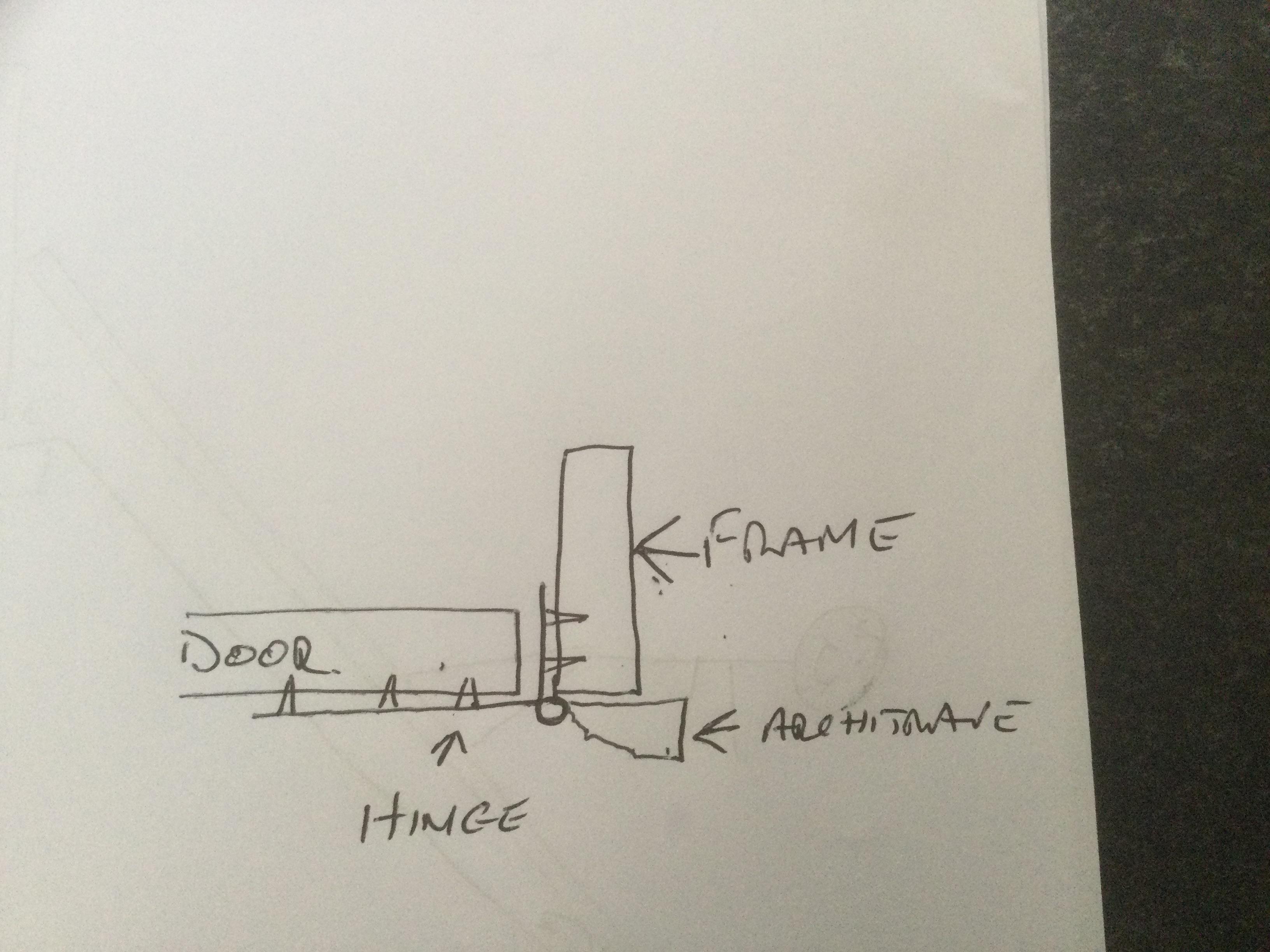

But the hinges: so I 1st fix to the door (presumably) with hinge pivoty mid bit just off door edge? or just on it?
Then its where to attatch hinges to, on the frame. Ok my architrave strips are on perp onto the door frame.. so do I need to whittle out sections of it to fit hinges to? (so when door's closed the hinge is all on the same "plane").. or can I fit hinges perp to this, onto the inside of the frame itself?
IE do I have a choice where hinge fixes to, frame side?
Ah, if you have architrave fitted that’s awkward as these type of hinges are usually fitted “on the same plane”. So you either need to cut out a section of architrave fir each hinge or!,,,, you could do like this BUT the countersink in the hinges on the frame side fir the screws will be on the wrong side so you will need to carefully countersink the hinges WITHOUT going right through ?

Screws: my black hinges didn't come with any, & my fab diy shop I can test a screw for size, is shut (no plant pots in town too! bah).
So could you advise? hinges have quite big 6mm W holes, with top of countersunk splayed bit 10mm W. thx zH

Worth a punt https://www.ebay.co.uk/itm/20-Pieces-Pack-20mm-Long-4mm-Black-Finish-Countersunk-Cross-Head-Wood-Screws/264948545921?hash=item3db029f981:g:XawAAOSw8DpcL3OH
@joe90 thanks/ gives me a good start. Do you think I might need longer & maybe m5? if my ledges are 25mm.. don't I want them to go thru this, & onward into the t&g (20mm thick) a bit too? or is say M5 x 30mm ott..
@zoothorn from your photo I thought your hinges were going on the 20mm? Not the 25mm?, whichever you think is best for the timber your using. If the hinges are going on the cross ledges (20 + 25mm) then go for 40mm, longer is best.
Edited by joe90
Yup sorry my pic was only meant to show hinge, not also where its going. So they'll go on the other side of course, & @ the 3x ledge positions (I guess is sensible.. or do I put the lowest one up a bit-?).
So m5x 40mm maybe. nice slotted ones ideally, but seem £alot more than philips. thanks.

small price to pay fir getting it right ?.
