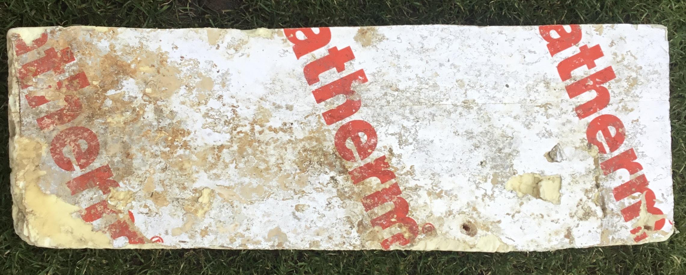

Cpd Posted February 11, 2020 Posted February 11, 2020 When one of my local BM we’re clearing up they gave me 4 sheets of 50mm PIR insulation, it had been out in the open for a few years and the foil was damaged so they wanted rid of it. I took it home and left it in the shed for 6 months to see if it misshaped or anything dramatic but it stayed the same, i only have a small bit left (5 years old in shed...) but just checked the edge and it’s still bang on 50mm and still super straight / no bending like what i get with off cuts of calotex. If you someone can identify it it from what is left of the manufacturer label it might be worth finding out a bit more about it.
A_L Posted February 11, 2020 Posted February 11, 2020 18 minutes ago, Cpd said: If you someone can identify it Xtratherm? https://www.xtratherm.com/products/xt-tf/ 1 1
Declan52 Posted February 11, 2020 Posted February 11, 2020 9 minutes ago, A_L said: Xtratherm? https://www.xtratherm.com/products/xt-tf/ I used mostly xtratherm in my build. At the time they had the best deal around and bought straight from them. They are based in southern Ireland.
