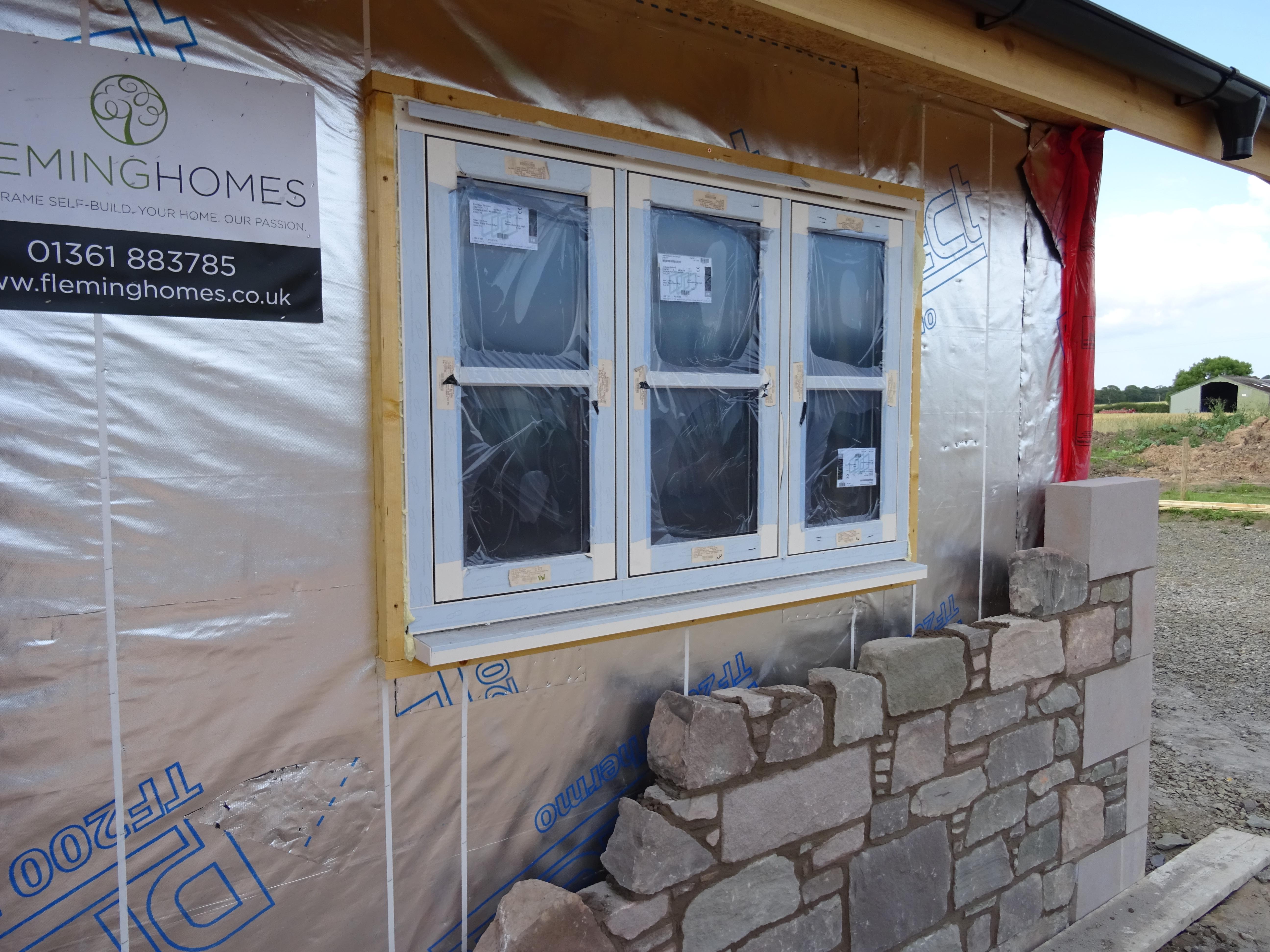

When to install windows and doors in TF build?
Redoctober replied to Andrew's topic in Windows & Glazing
Agreed with above comments - we put our windows into our TF before the external skin went up - Just a pointer though and I'm sure you won't make the same mistake as I did - make sure the windows protrude from the frame sufficiently as to allow the fire batons to work - I initially had them set flush - which was the mistake! See images below for how they should look. -
