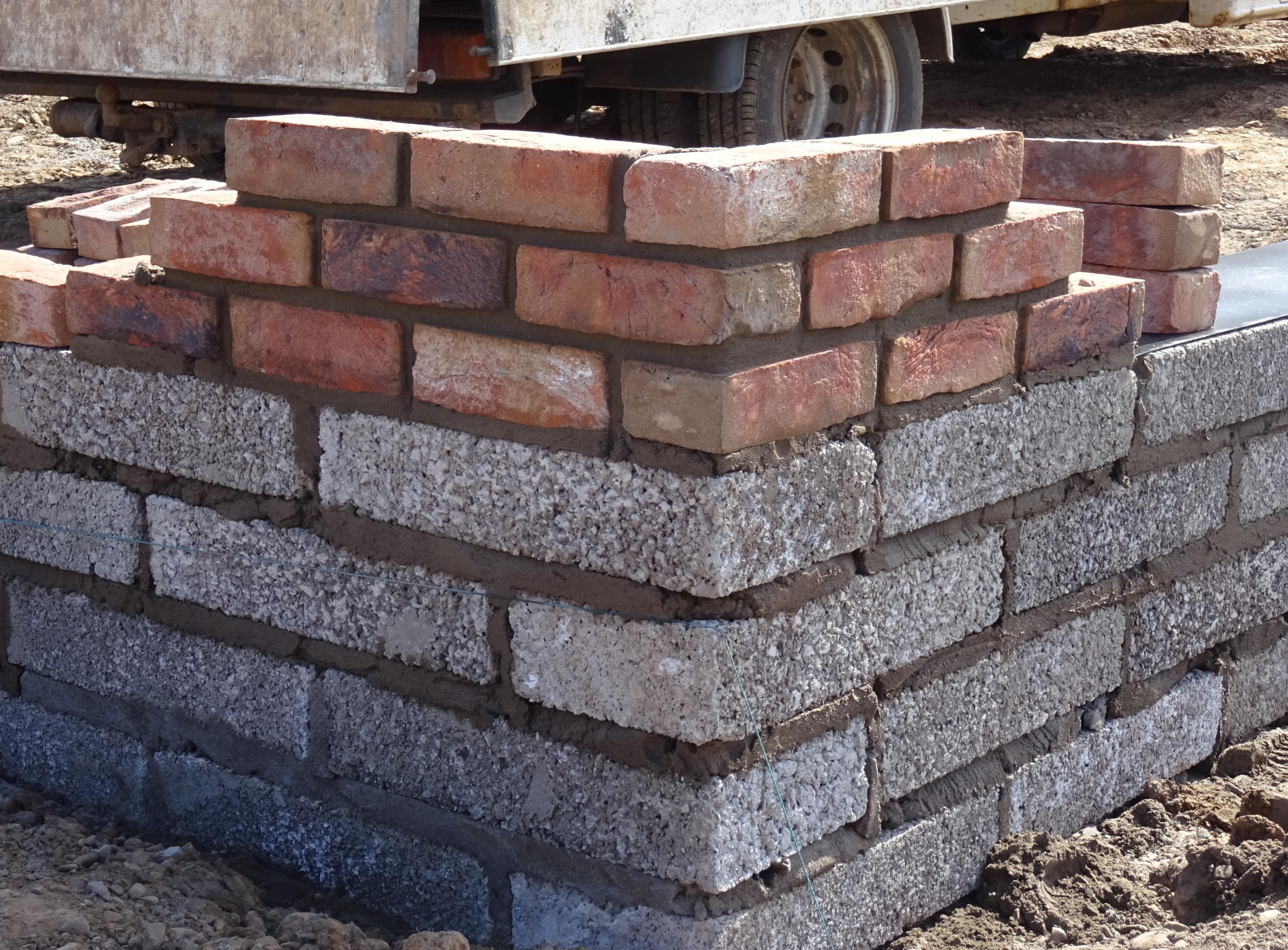

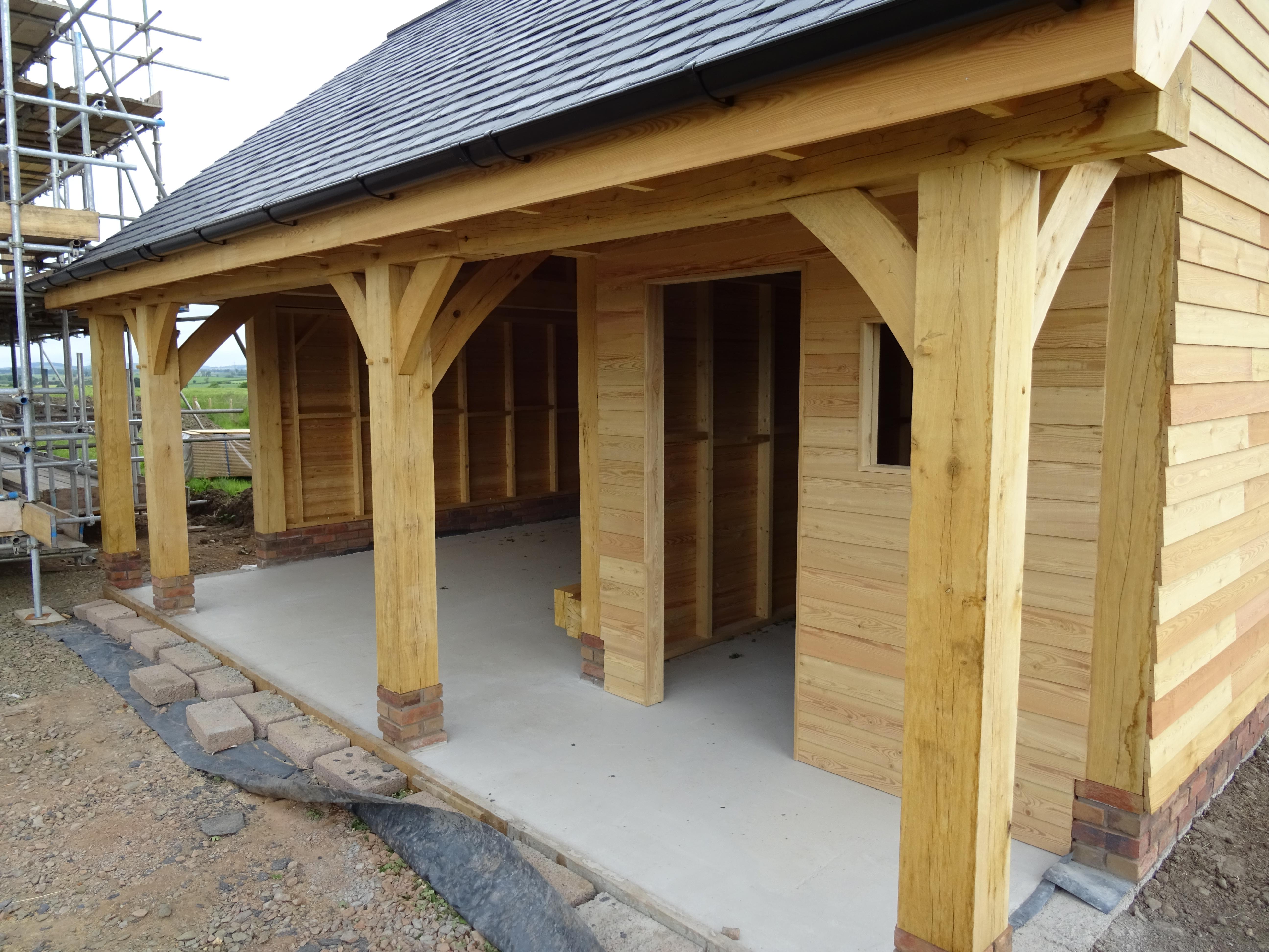

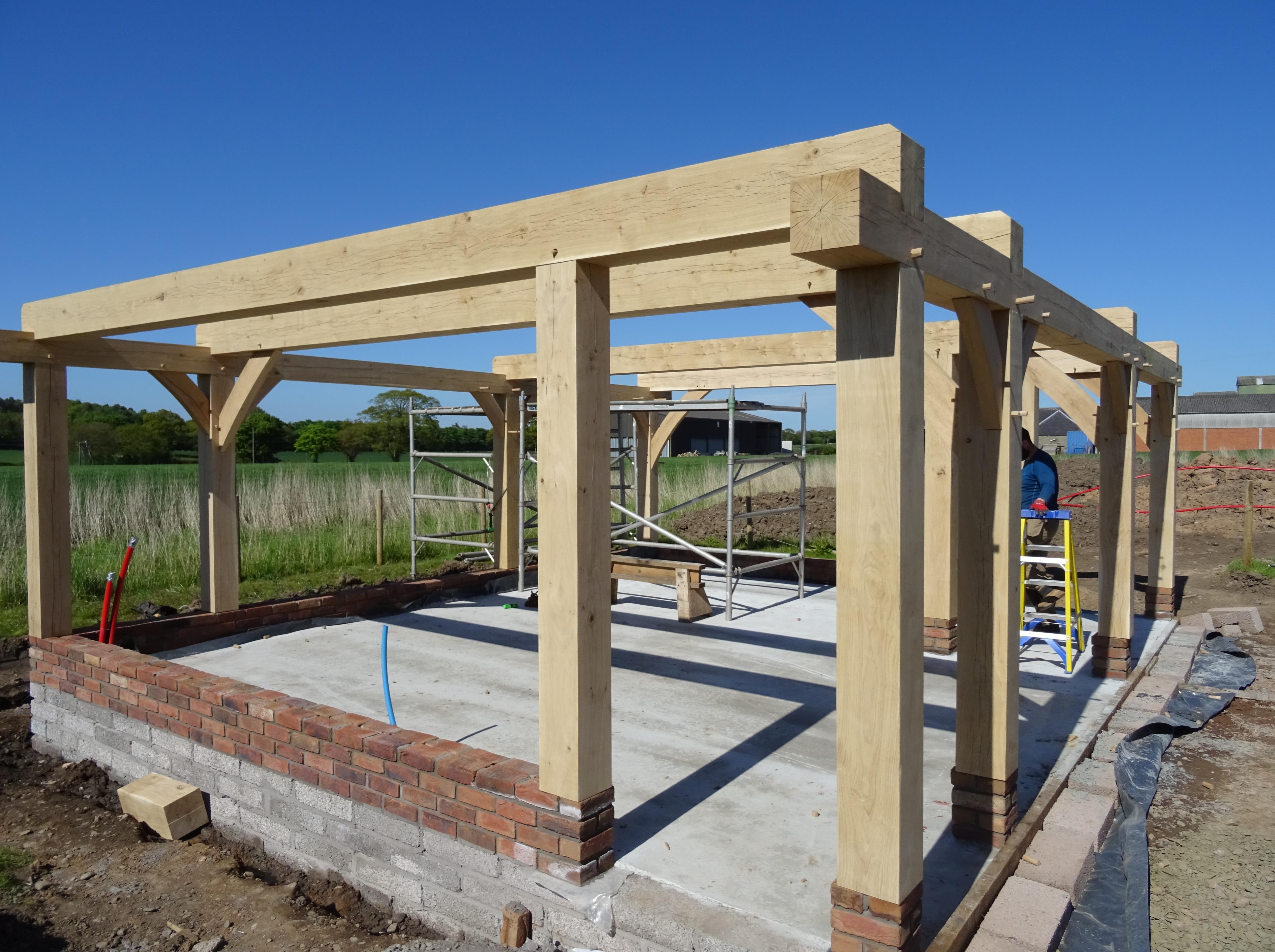

We have a timber framed carport and combined shed that is built upon a concrete slab with a twin dwarf wall. The bricks are a range of heritage bricks from a builders merchant so nothing specific as to needing to be an engineering brick etc. We dont have a damp proof course between the supporting bricks and the oak posts as they are protected by the external larch cladding. I'm sure a competent bricklayer / builder / DIYer could lay the bricks. See images below. Although everyone has their own reasons for doing something or not as the case may be for @Carrerahill, I'm very pleased with our timber frame construction. It is oak framed with larch panels, so I don't intend it to be going anywhere anytime soon! That said, I won't be doing any welding in it either. ?
