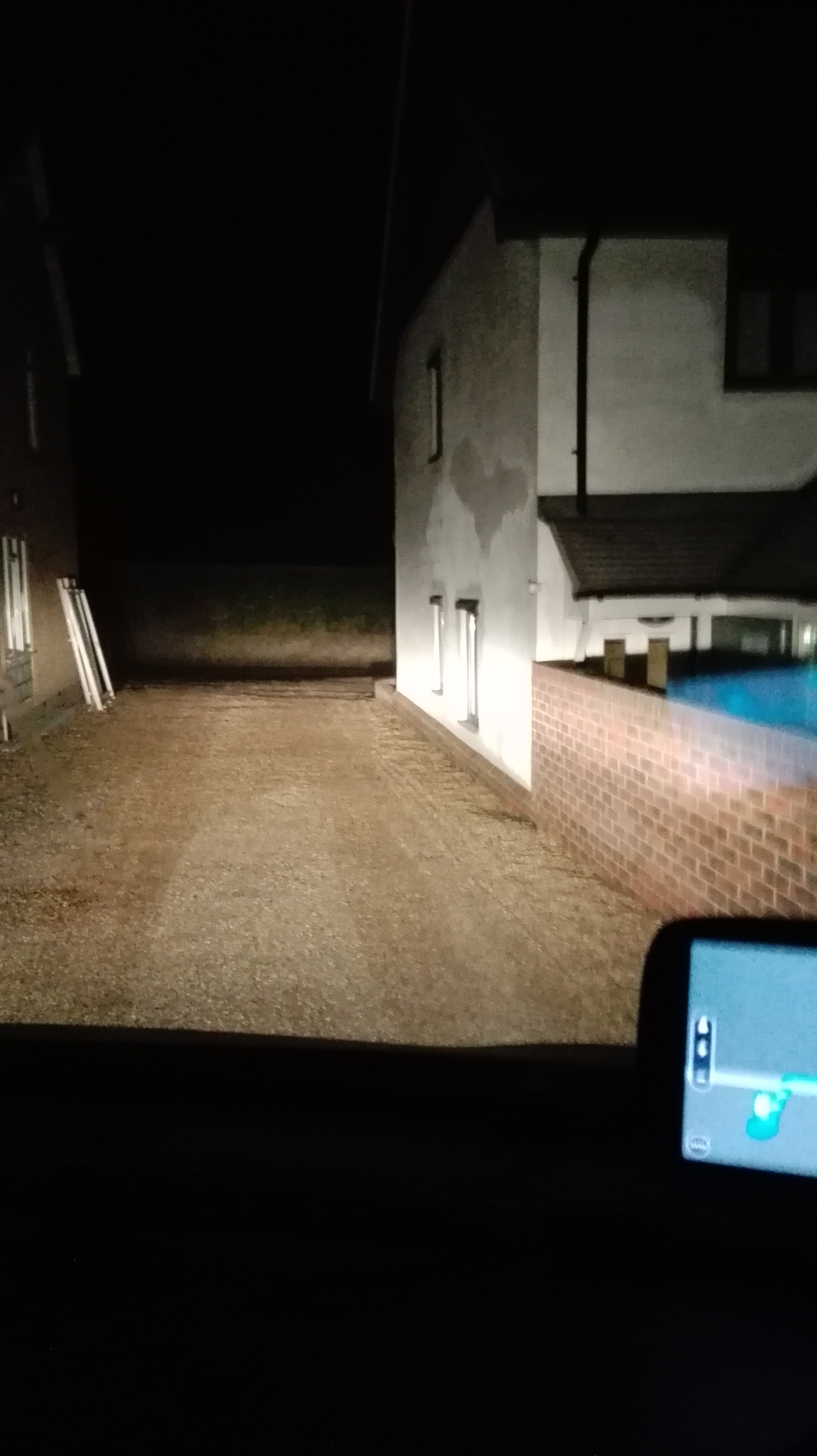

  14. They are more thermally efficient on paper but not in the real world. The 2 wet looking patches that fall away from the upper window are cracks that can easily be seen in daylight ,the lighter coloured areas had frost on them. glad to hear that about your walls @Declan52, could you give me a detailed breakdown of them please? mine have got bed joint reinforcement, which was a bit like a toy train track. that camera looks the dogs dangles!
