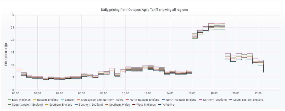

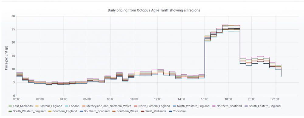

  10. https://octopus.energy/blog/outgoing/ - the wholesale price is multiplied by the M_tariff figure, plus the B_tariff fixed rate all the time and the C_tariff number between 4 and 7pm. Back calculating from the tariff graph above to work out the wholesale rates, exports after 4pm yesterday would have been paid about 12p/kWh. Before then it would have been about 4-5p/kWh: a bit lower than the import rate, but virtually identical to the overnight cheap rate. Essentially that means there is no benefit to using PV when produced as opposed to exporting it outside the 4-7pm window and using overnight cheap rate electricity. Within the 4-7pm window, there is a positive incentive to export as much as you can. Values are based on the South Eastern region where I am - the logic is probably quite a bit different in Scotland for instance.
  11. Is that still true? In a world with fixed tariff rates which don't change with demand then it makes economic sense, but from an environmental point of view it doesn't and smart meter tariffs mean it makes economic sense to shift demand too. They're also quite a bit easier to deal with than self-consumption as they've got a far larger applicable market at the moment. To give an example, you need 10kWh for water heating at some point over 24 hours and are on Octopus Agile/Outgoing: Using this between 2am and 4am will cost 50p. If you have a PV array producing the same amount of power between 11am and 1pm you could export it for about the same price. However, if you've say got a west-facing array which still produces after 4pm today you're much better off exporting than self-consuming: you'll be paid about 12p/kWh to export compared to the ~5p/kWh you would pay for the same electricity overnight. It's also significantly cheaper and easier to use a smart time clock to shift the demand rather than batteries - and price is a pretty good proxy for environmental impact since the low emission forms of generation all have essentially zero fuel costs and so will want to generate whenever they can. It's not perfect, but with increasing amounts of wind on the grid the odds are that this will work out best over the course of a year. Certainly the cost difference isn't big enough to justify spending very much on load shifting - at most you could justify something which uses weather forecasts to predict daily PV generation and load shift based on expected exports and export/import prices.

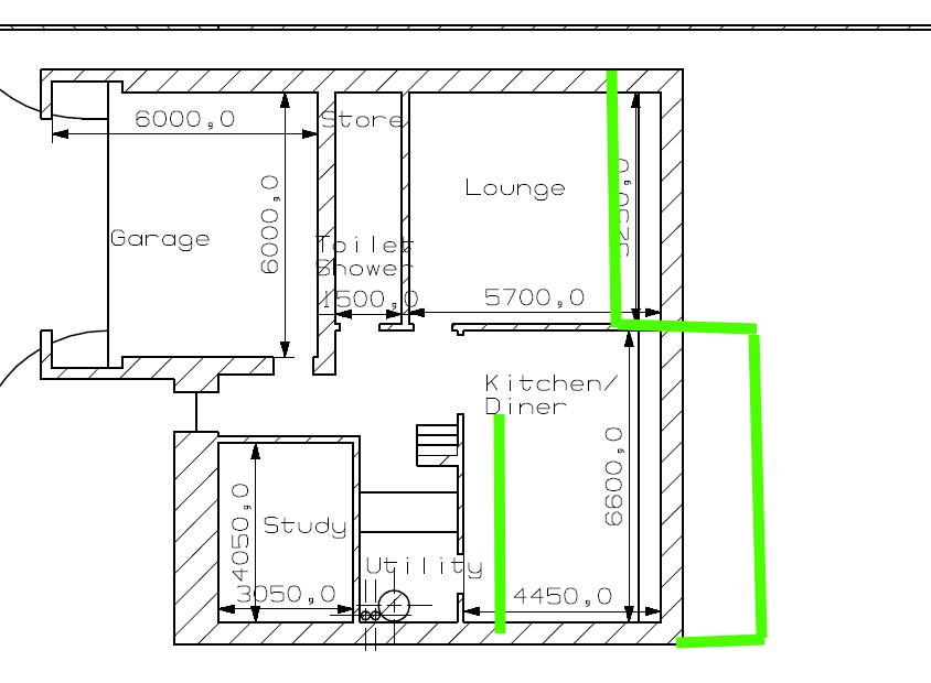

  15. I'm attempting to do both sequentially - This thread is part of the wishlist -> design -> price loop, which I'm trying to do myself as a reality/sanity check. Accuracy isn't critical, but I want to ensure that the wishlist is a sensible one (i.e. cut out the things we can't have early) and that the budget is realistic for the wishlist. Essentially this is a GO/NOGO decision and the costing can be quite approximate. If (1) is a go, we then set a budget and a wishlist and go to an architect with it to get as much as we can of the wishlist. This is actually proving to be a very valuable exercise in showing me that I don't necessarily know what my requirements actually are That's more or less the plan, the only difference is that I'd like to do a slightly more detailed cost breakdown so that I understand what is the main cost drivers are - I'll bet that there are several things on the wish-list that are far more expensive than I currently appreciate, but unless I go through this exercise I won't really know what they are. It does rather. I'll have a think about that - 95% of the stuff can happily go to the loft (with a proper staircase) or a large shed in the garden (much cheaper than a garage), it's really about the cars. Having them in a garage is something I want, but it isn't necessarily something that it's a good idea to want.
  16. It isn't that I don't believe that more could be done with the site - I'm quite certain of that. What I'm struggling with is what **I** could do with it. We had an architect involved first time around (with the refurbishment/extension) and the process of finding out that we couldn't have what we want was pretty painful, both emotionally and financially. What I'm trying to do here is slightly backwards: work out what we want, and then decide if it would fit into the budget or not. If it doesn't, then it isn't going to happen - given that the whole process would be both expensive and painful then it isn't worth doing for us if we end up with something more than slightly compromised to fit our budget, we'd probably just move house and end up with a different set of compromises. The shape of the design in my head has certainly changed noticeably during the thread, albeit not massively so. A lot of it is reconciling what we want with what others are likely to want in future if we ever need to sell (e.g. if moving jobs) so that we don't build something nobody else would want. The upstairs/downstairs balance of the house is a good example of this. That was the intention, and all the comments are certainly massively appreciated even if I'm not necessarily adapting to them yet. I tend to spend quite a bit of time mulling things over before I act on them, and we don't have a drop-dead date to make a decision by. I was once described by a crusty old RAF Flight Sergeant as someone who "could tell you the square root of a jar of pickled eggs but couldn't get the f***ing lid off". I think that's quite apt here - what I have is a design that I know inside out, but the lid is still on...

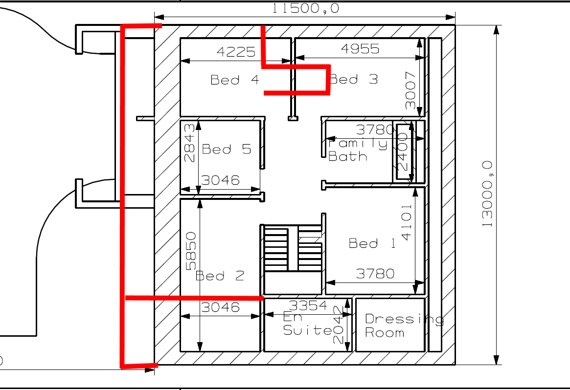

  17. Hmmm... I've done that at a fairly high level: the rooms link to each other as we want them, more or less, and are mostly biased towards the garden which we also want. I've not really done anything to link them to thinks beyond the house though (patio area, where the other houses are, etc.). One thing I'm wary of is that I'm not trying to be the architect here - I've got the wrong mindset, frankly. What I'm trying to do is - cheaply - generate a design which from a size and complexity point of view roughly matches what we would end up with. I can then cost it out to see if what we want to do is feasible or not. Thing is, I've already done that - or at least I thought I had. From the reactions, I'm starting to suspect that either my requirements are non-standard (entirely possible - my wife for instance will happily work all day long in a darkened room) or that my translation of the sizes on the plan to the real life experience of living in them is flawed.
  18. Something more like this, with the extension being ground floor only, possibly with a skylight over? That would give the dining area a SW facing window and make the lounge a little less dark as it wouldn't be quite as deep. Would also allow me to open up the staircase a bit wider to act more effectively as a light well from the skylight. It would also potentially concentrate the patio area in front of the lounge, tying everything together a bit better and not increasing the intrusion of the house into the garden. The NE wall would be facing an ugly concrete garage and an old shed (both right on the boundary), so unlikely to be an issue. I've not really even started thinking about glazing yet, assumption so far is that rooms which need natural light on the end faces can have obscured glazing (en suites and probably the utility) but that I'd prefer to use it for light only as the view out is pretty fugly by comparison with the front and rear.
  19. Sadly there's a problem with that. As an engineer, there is delight in a rational, efficient solution and you're extensively trained to think in a particular way. That spills over in all sorts of ways - including lifestyle to some extent. <example of engineering thinking> The bit I think I'm struggling with is that there are views to the front (on the upper level anyway - on the lower level it's whatever I can salvage of the garden from being turned into a car park) and a big garden to the back, but nothing to either side. That means the glazing needs to be orientated towards the front and back (anything to the side is looking at a fence or a blank wall), and the house needs to use as much of the width of the plot as it can (currently I've left 1m to either side). That then means scaling the volume is a matter of making the house shallower or deeper. </example of engineering thinking>

  24. Garage being placed for the best light is unfortunate but unavoidable if I'm going to have one - if self-driving cars ever become a thing then it's getting converted into another living room! I think it's pretty much unavoidable, and since the plot isn't all that wide it pretty much has to be in front of something if we're going to be able to get either car out on demand. That's a major irritant at the moment. Initial design had the kitchen and lounge swapped, with the utility behind the garage and shower. Problem was that only worked with a significantly deeper house - otherwise the kitchen is just "too small" according to my wife. We also want the house facing towards the garden so far as possible - it's a choice of light+road view or a bit dim+garden view. Like anything else, you can't get everything you want. I'll have a think, but I suspect a kitchen/living room/diner combined is what you'd need for a dual aspect and that probably wouldn't suit the way we live. Modification to upstairs shown below based on suggestions so far - push the front wall forward ~700mm bringing the design closer to a square (excuse the not-to-scale lines). That evens out the size of Bed 3 and Bed 4 and allows a ~2 x 1m space to be created - initially that would probably be wardrobes for each room, but it's above the downstairs shower/store so providing water and drains should be a doddle in a few years if needed. I've flip-flopped a few times about flipping over which of Bed 1 and Bed 2 is the master - at this stage it doesn't really matter because shifting a partition wall slightly is really all that is needed to change over, if that, and that will have no cost impact.
  25. Already doing that - stairs continue to loft level, and I've got a Velux in the top (cathedral ceiling). There's a ~300mm gap in the middle for the light to come down - should also help with stack effect in summer.
