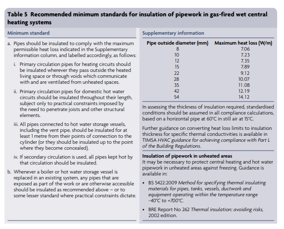

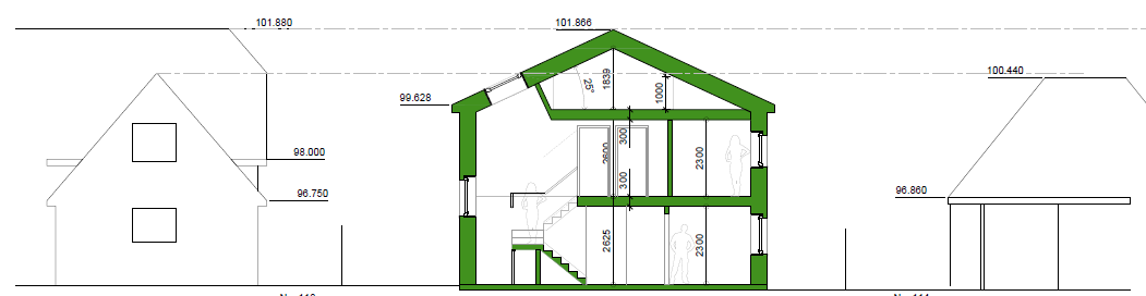

  2. Digging further, looks like you're supposed to insulate them for 1m away from the cylinder if it's heated by a gas boiler: There isn't any equivalent guidance for heat pump systems - I would just insulate the 22mm pipe from the cylinder the the manifold since that pipe will be seeing far more frequent draw-offs so would probably benefit from it. https://assets.publishing.service.gov.uk/government/uploads/system/uploads/attachment_data/file/697525/DBSCG_secure.pdf

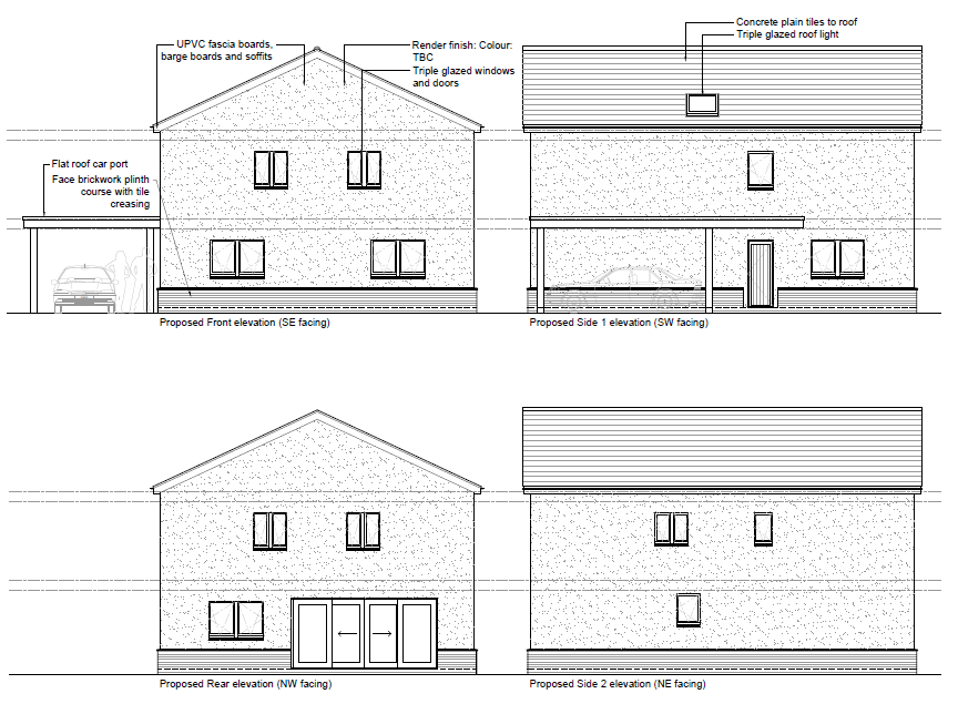

  3. Not massively worried by the SW windows since they're ~5m from a blank wall on the house next door. I'm pretty sure that all the windows except for the ground floor at the back are massively undersized though, and that the current layout of them is fugly. I've asked for the sizes to be checked before it goes to the QS, the shape and alignment can wait for the time being but we would certainly want it to be revised before submitting for planning.
  4. The only bit I can find is: Note that primary pipes are those between the heat source (ASHP in your case) and the hot water cylinder - lagging these is a good idea anyway, as is keeping them as short as you can. Pipes from the hot water cylinder to the point of use are secondary ones. The reality is that unless you use the secondary pipes very frequently they will have cooled down before the next use no matter how well lagged they are. The one exception to this is if you are running a secondary return hot water system because the hot water cylinder is a long way from the point of use - if you are, then the pumped circuit absolutely needs to be well insulated since being shared across a large number of draw-off points means it will be running far more frequently and will be kept hot to minimise draw-off time.
  5. Is there any benefit to lagging pipes from cylinder to point of use? If it's 10mm the amount of energy lost in just letting it cool down should be pretty trivial unless you've got very long runs. The primary circuit from ASHP to UVC does definitely need lagging though.

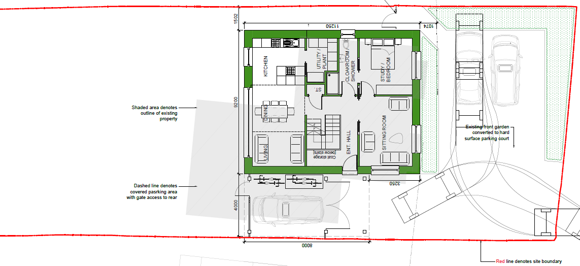

  6. We're trying to. We've had a lot of time to think about this - we originally bought the place almost 4 years ago with the intention of doing a major refurbishment and loft conversion, but the more we looked at it the more we found was wrong and it's ended up being cheaper to knock down and rebuild. Unfortunately, that required a significantly larger budget and we didn't have that until recently. This particular practice seems to make very conservative assumptions about cost of ~£2500/m2 based on their previous projects, which seems to come from the fact that they primarily do Passivhaus and that tends to attract the sort of clients who tend to gold-plate everything. Given we've been pretty clear our budget is quite a bit below this, they're trying hard to keep things small and simple to control costs, and I suspect that if you strip out the gold plating they're maybe trying a little too hard to keep it compact. QS report (due in a couple of weeks) should give us a good understanding of whether that is the case.
  7. Pretty much matches our thinking, there are several details that should let us get a few hundred mm more height and 2400mm internally is definitely our next priority. The ground level at the front is ~200mm higher than at the back for instance, and the street scene is very varied so we really shouldn't have any issues getting a higher ridge line than the neighbours at planning (to the extent that the parish council recently had to employ a barrister to oppose the district council granting permission to a load more new builds outside the settlement boundary in direct contravention of the adopted neighbourhood plan). This particular practice did a very similar sized house in the next village over where they had a major issue with the council about ridge height, so I think they're a bit once-bitten. However there are a number of differences (for instance it's inside an AONB, we aren't) which I'm gradually getting through to them. I'm not too concerned at this stage - what we've got is acceptable, and is very representative for costing. Plan is to go for pre-application advice with a strong steer to push for an increased ridge height over next door by maybe 300mm, but we need to get the QS numbers back first and then revise the design accordingly if needed - we'd quite like to stretch it a bit front to back if budget allows, probably adding ~1m on the front and maybe a little on the back.

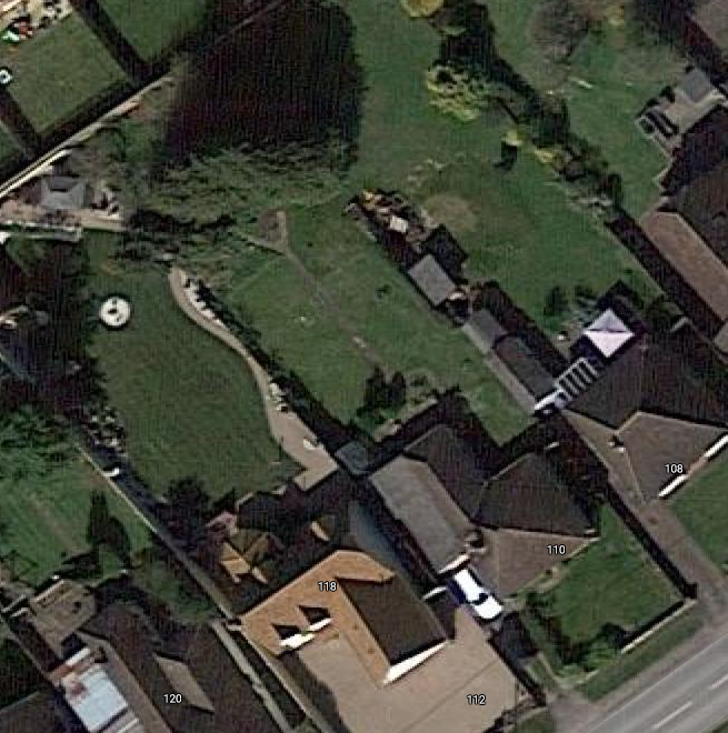

  8. Sorry, forgot to include that. It's the house labelled "110" in the centre of the Google Earth snapshot. We're thinking about pushing the house back on the plot a bit so that the back wall is aligned with the current back wall, but that's something we'll discuss with the architect before we submit for planning - also planning to get them to push for an increased ridge height so we can go to 2400mm rooms and a more normal roof pitch. Due to COVID the guy doing the design hasn't actually been on site although someone else from the practice has - plan is to do so before we submit for planning to make sure we haven't missed anything. I **think** that because the ceiling height is so low and there are no windows the loft doesn't count as a habitable room and therefore there should be no impact on building regulations - we're still very early in the design process though so switching between stairs and a loft ladder has virtually no impact. We definitely want permanent stairs though - my wife in particular is a bit of a hoarder someone who doesn't like to waste anything and carrying crates of stuff up a ladder is enough of a pain they end up lying around the house for ages. The architect tried to just continue the current stairs up but there isn't enough headroom.

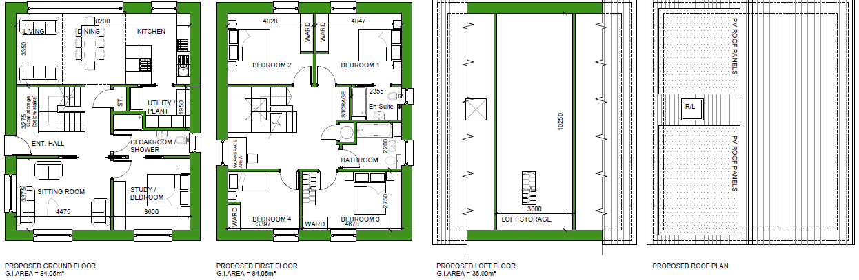

  9. First set of plans back from the architects, we're fairly happy with the layout but I figured it would be a good idea to stick them on here for feedback from the buildhub hive-mind. Please ignore the fact that the outside is fugly at the moment - the current window positions are carried over from a previous iteration of the design which was a 1 1/2 storey version with very restricted headroom upstairs - that's being changed at the moment. It's off to the QS for initial costing at the moment before we start thinking about the details.

  11. Who is the opposition from and what do they want to achieve? My wife isn't too fussed about how we heat it but really wants active summer cooling. Past that she doesn't really care how it's achieved.

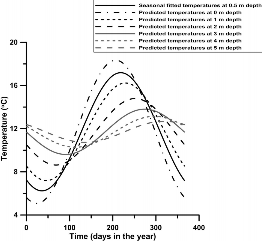

  17. I think that's a little pessimistic. "Depth" is a pretty good proxy for distance from outside air here, so the rims of an unheated room will get that cold but the centre will be significantly warmer. Add in the impact of the losses and the fact that soil is a pretty poor thermal conductor with a lot of heat capacity, and I wouldn't be surprised to see 15°C at the centre of a room where the floor is at 30°C and the insulation is at or about building regs minimum. The floor losses approach is a good one though, and easy to do: essentially you're modelling the amount of insulation that is required to have a temperature difference of (UFH Flow Temperature) - (Room Temperature) across it for the design heat loss of the room. For an example, assume 80 W/m2 of heat required with the mean water temperature at 35°C. "Radiator" floor U-value is the building regulations minimum (0.22 W/m2.K) : assume the ground is at 5°C so that's 3.3 W/m2 lost we want to maintain with underfloor heating. Lambda value for PIR is 0.02 W/m.K. 3.3 W/m2 = (Lambda/thickness) x (35-20) 3.3 = 0.02 x (1/Thickness) x 15 Therefore you need an extra 90mm of PIR to keep heat losses the same comparing radiators to underfloor heating in this particular scenario. That's probably a significant overestimate - you gain from the insulation even when the heating isn't at full power - but should give some idea of the impact of running warm floors. If you keep the minimum building regulations value and accept higher losses, you're effectively doubling your losses to ground (+3.3 W/m2).
  18. It isn't 30°C though, there's a very long time delay (several months unless you have a lot of groundwater flowing) between the air temperature and soil temperature under a slab. 150W is more realistic - essentially this is the same reason that GSHPs get higher COPs than ASHPs in winter. That level of insulation is still rubbish and will cost you a lot over the lifetime of the insulation, but it's important to get the numbers right. There are two issues here: Stopping working - they'll have a rated minimum temperature, for instance for Panasonic it's -20°C. Coldest temperature ever recorded in the UK is -27°C, so if you're in an exceptionally exposed location it may be an issue. For 99.9% of the population they'll never see anything that cold though. Tepid output is a sizing issue, not one inherent to the technology. **Some** ASHPs can produce higher outputs at higher temperatures, and if somebody hasn't read the manual correctly and installs one which can only provide the required 15kW at air temperatures above 10°C performance isn't going to be good enough. The only way that GSHP is going to be cheap is if someone installs a shared ground-loop system in front of your house. If that happens the only infrastructure you'll need is a couple of pipes from it to the heat pump location. If that doesn't happen, it'll stay seriously expensive unfortunately. A thermal store isn't likely to be a good match here unless you absolutely want to heat with wood (where it's required for safety reasons). Because of the way they work you need to store the heat in them significantly warmer than your hot water temperature needs to be, which in any case is the hottest water in the system. That really cripples the heat pump performance, you're much better off segregating your domestic hot water and space heating requirements as a result. Compost heating is a thing, but not practical on a domestic scale - you're looking at the best part of 100 tonnes of compost to provide a decent flow rate of hot water.
