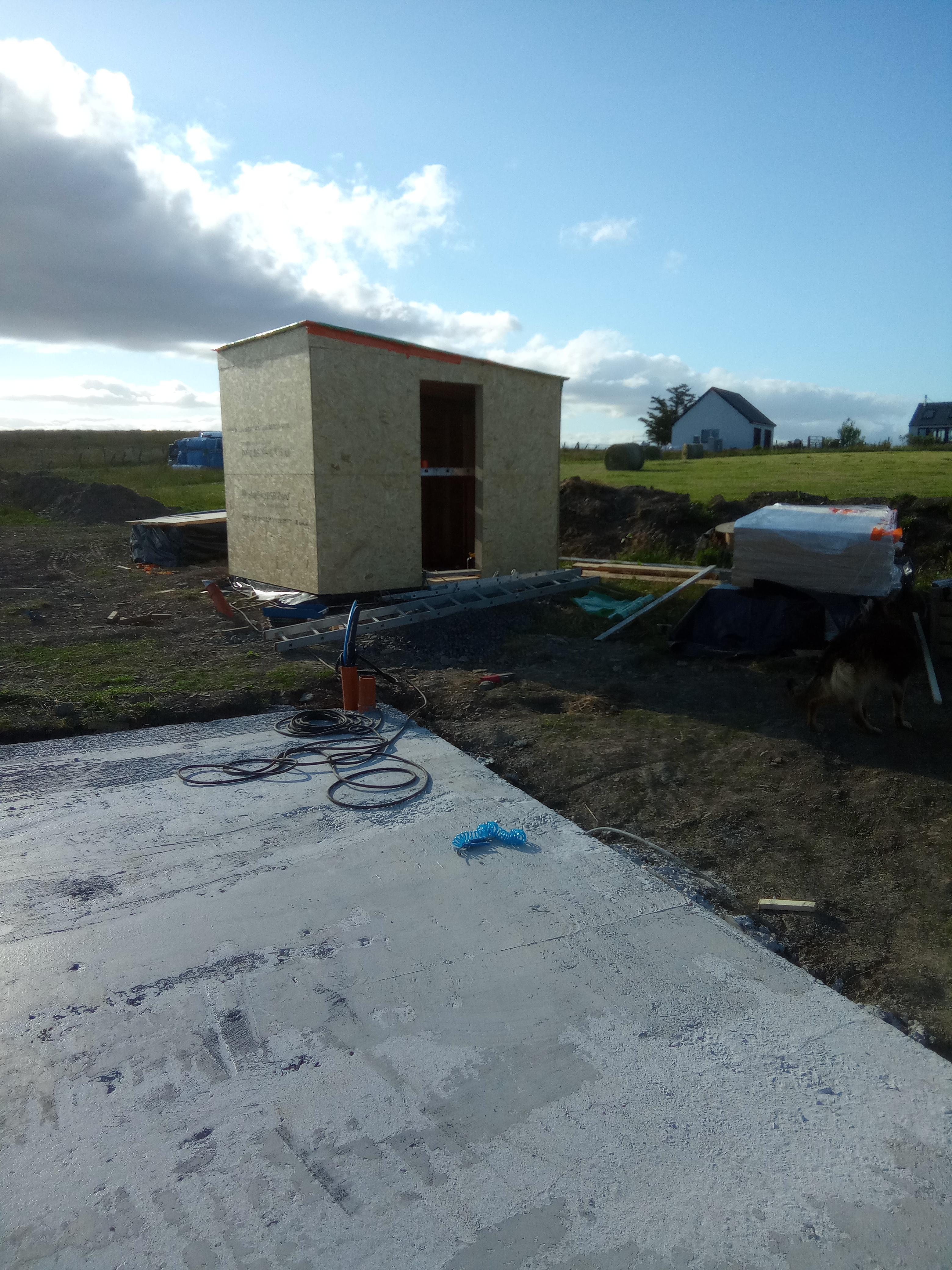

Our project includes some pods/ cabins and an amenity block. This amenity block will be initially used for the purpose you describe. Washing machine / dryer and our work clothes. I've been building this, this week but it's not attached to the static.- 14 replies

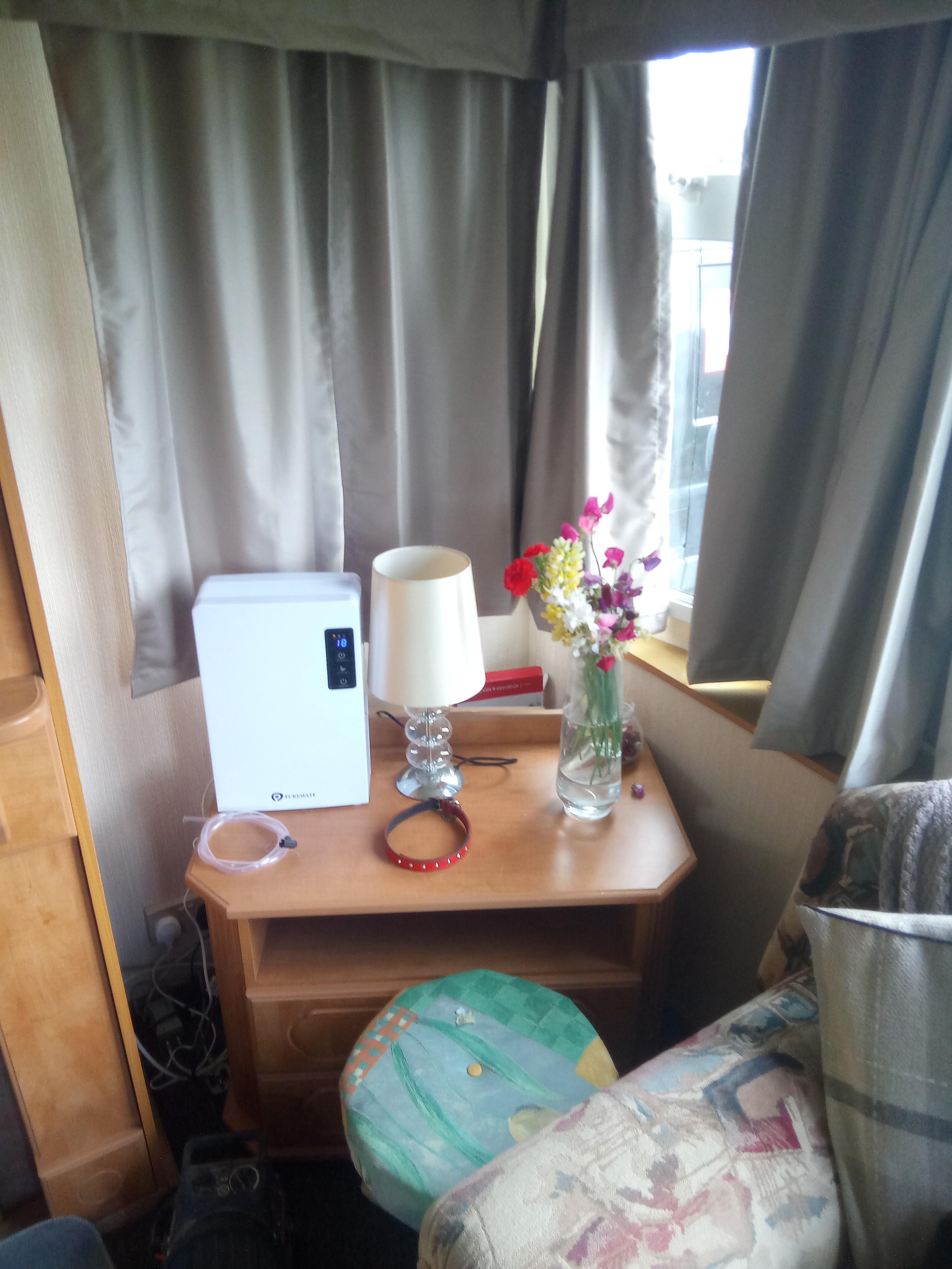

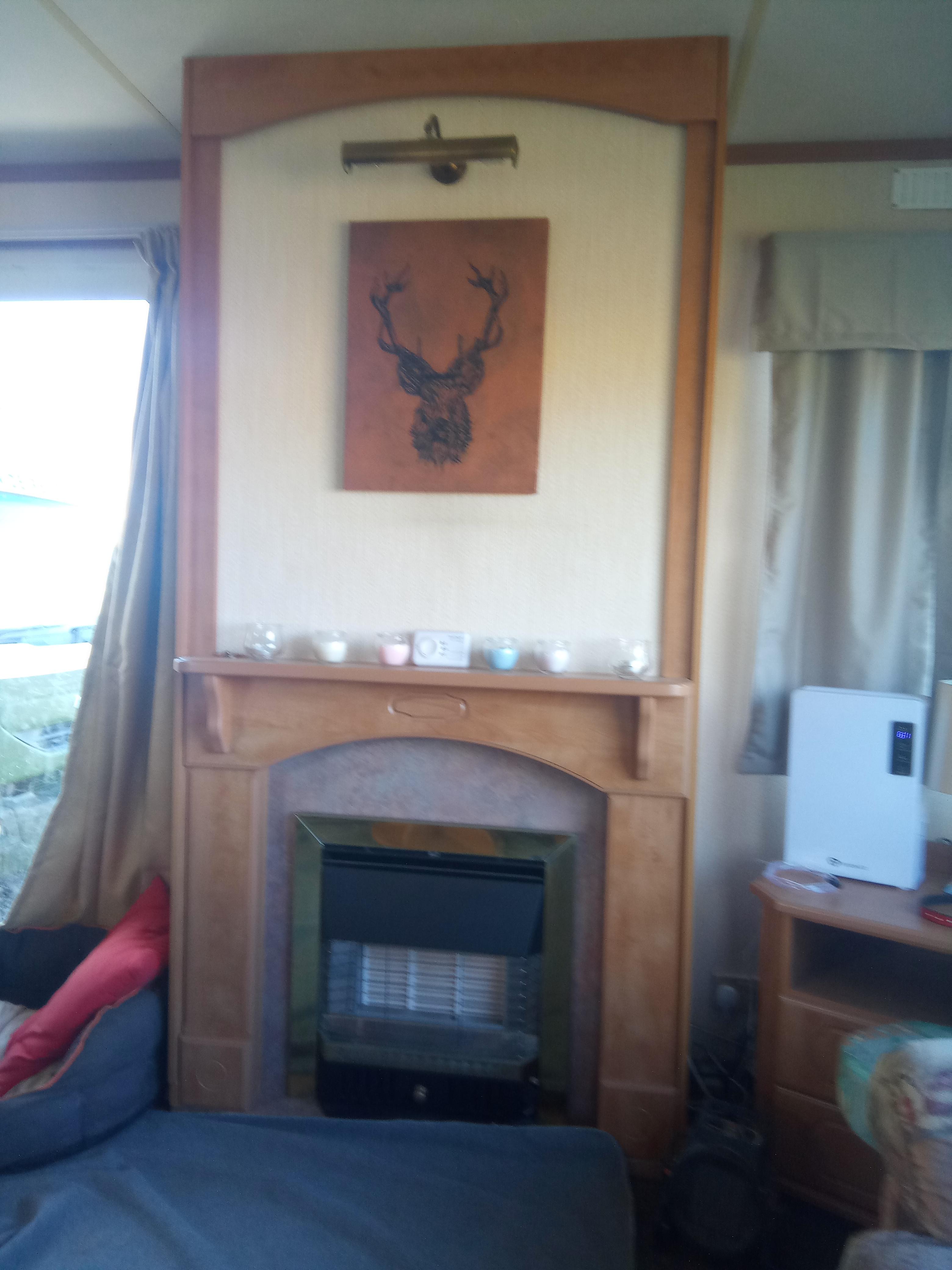

Its obvious I will need to improve the heating in our static. ( As well as the drafts). This fire can be on for an hour and you wouldn't know. I've been offered a 6kw (wood burning stove) for free, that will fit, but thought I'd seek the advice of those who've trod this path previously. Background: We don't have any wood lying around except the offcuts from framing. The 2kw heater does get the place warm. My plan is to remove the fireplace and wooden sides, install a base probably some form of paving. A heat shield at the back. The stove flue will be a short iron adaptor and then twin wall as soon as I can. Existing through the enlarged existing hole on the roof I've got a cheap thermometer so can check the surrounding temps. Is 6kw too large, I know I don't need to fill it to the brim but? Any suggestions for a cheap but acceptable heat shield. Any other suggestions before I take the plunge. It's been lovely up here the last few weeks but the caravan still drops to 15deg overnight. Winter will be long and hard if I don't sort this. Also any tips on improving the drafts on the single glazed windows? Thanks in advance.

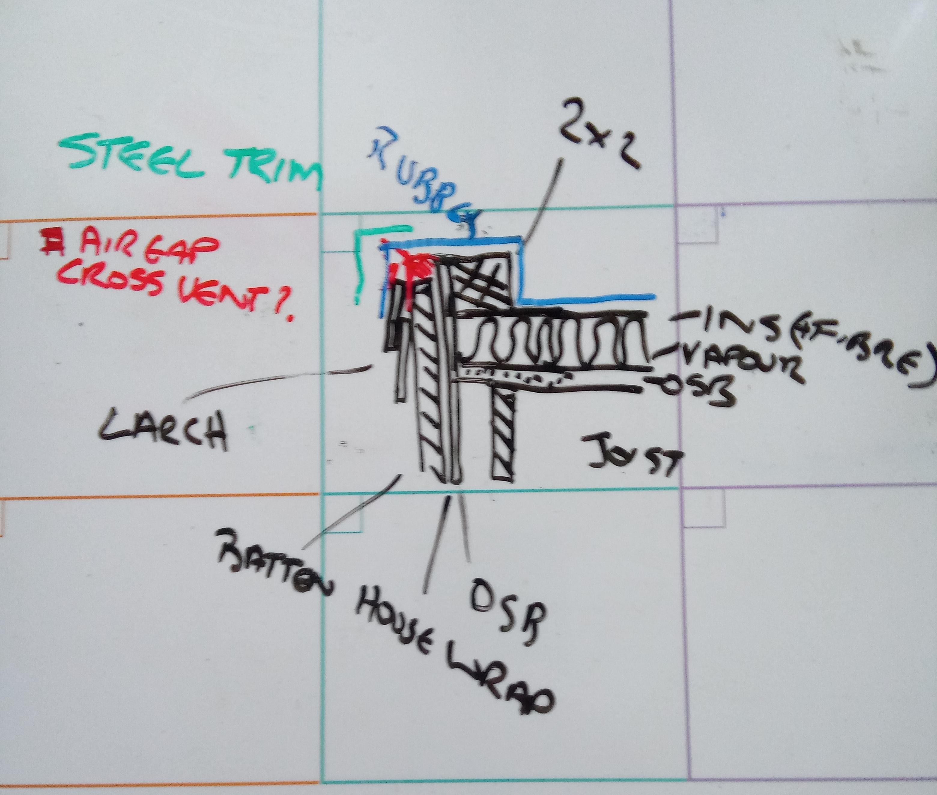

Excuse the poor cut and pace job, but I still see issues with Air tightness. At the sides of the doors where the pocket is, when the doors are closed there will be a gap internal and external into the pocket void? maybe "sealed" with brushes, and wipe seals? but not air tight. You will also have 2x width of sash opening internally waiting to accommodate the opened doors? what do you do with that space?
