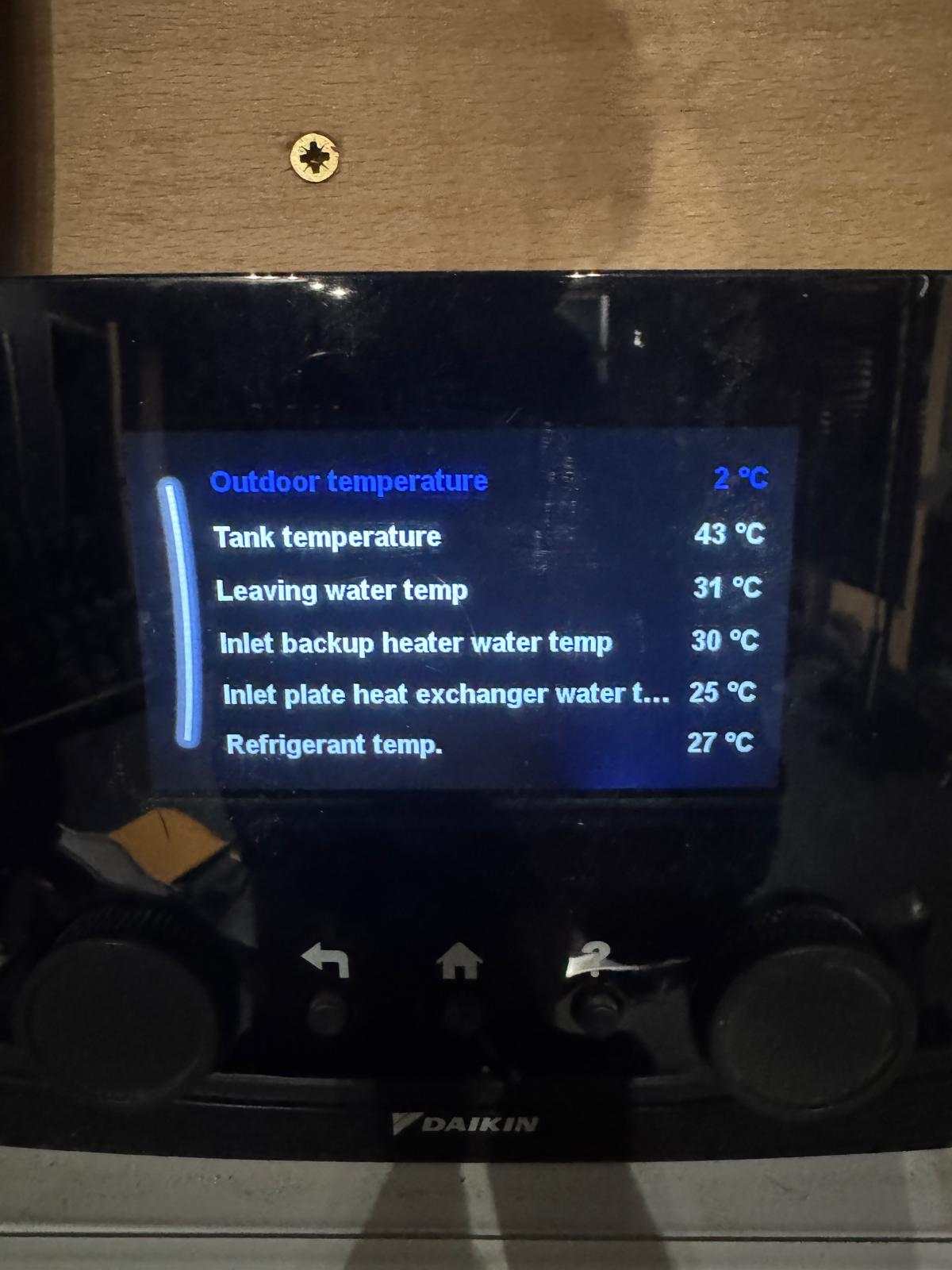

  1. We've got 8 zones, split across 4 UFH manifolds and pumps. How would I go about balancing the flow rates either side of the buffer? No, not running for short periods, it's on 24/7, minus a 3 hour window where the electricity rate is higher, so we don't call for heating demand during 4-7pm, but that's it. Weather compensation curve is set to max 35c at -5c external temp. I could try increasing the external temp to say -3/-2?

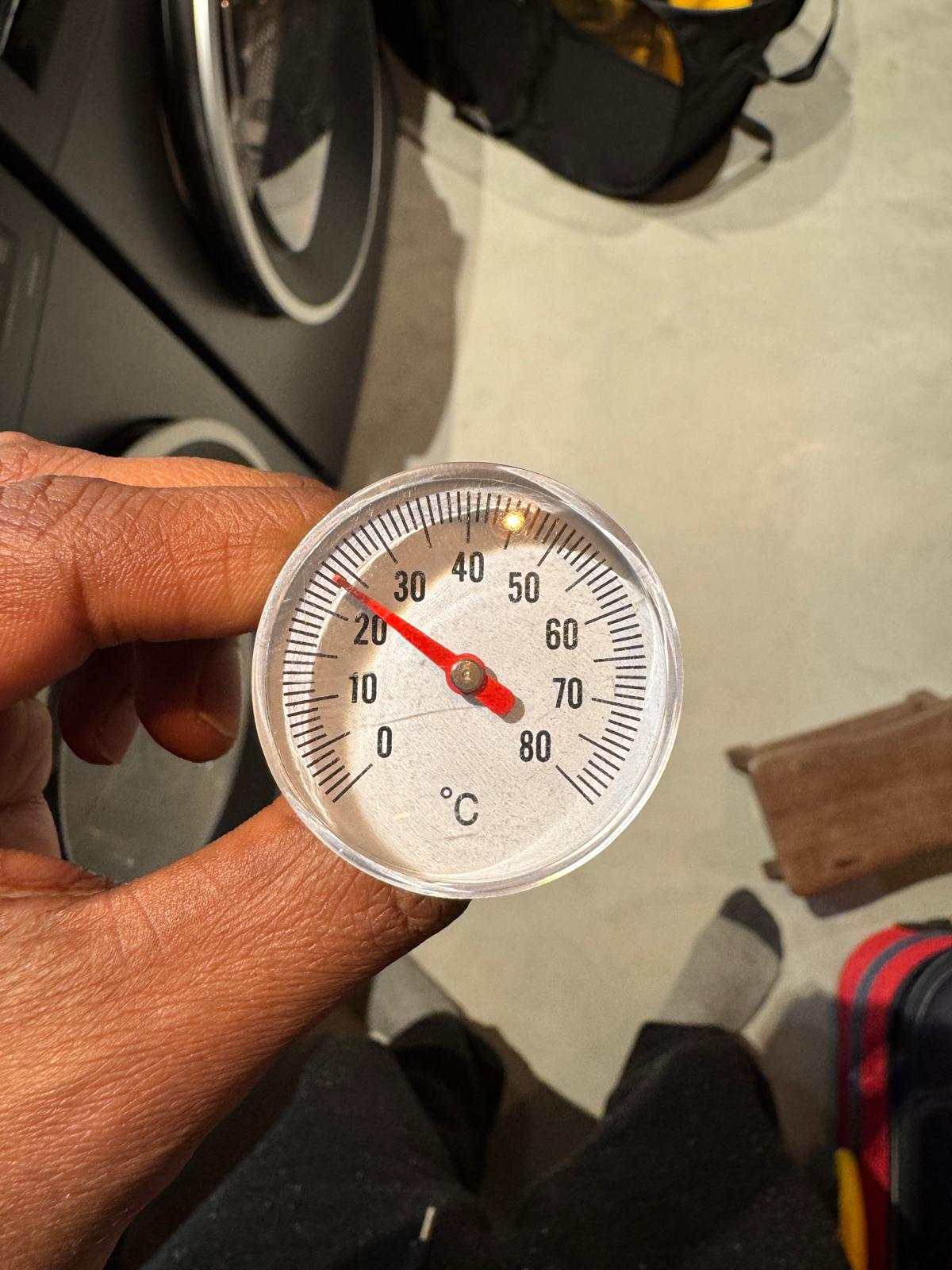

  2. I'm not sure if those are return temps. It's the only thermometer on the UFH manifolds. Apologies, I am still learning! Yes, we are getting DHW fine from the system reliably. No issue with that. There are two separate tanks within the hot water tank. One for UFH and one for DHW. The DHW is around 45c and set to come on a schedule.
  3. Trying to do a bit of investigation as to why the house is feeling a bit cold. Currently at 19c, when thermostats are set to 21c. The leaving water temp according to my ASHP Daikin controller next to the water tank is 31c, yet on the UFH manifold, it's reading 25c on the manual thermometer (and upstairs as low as 20c). - Is this normal, and expected?

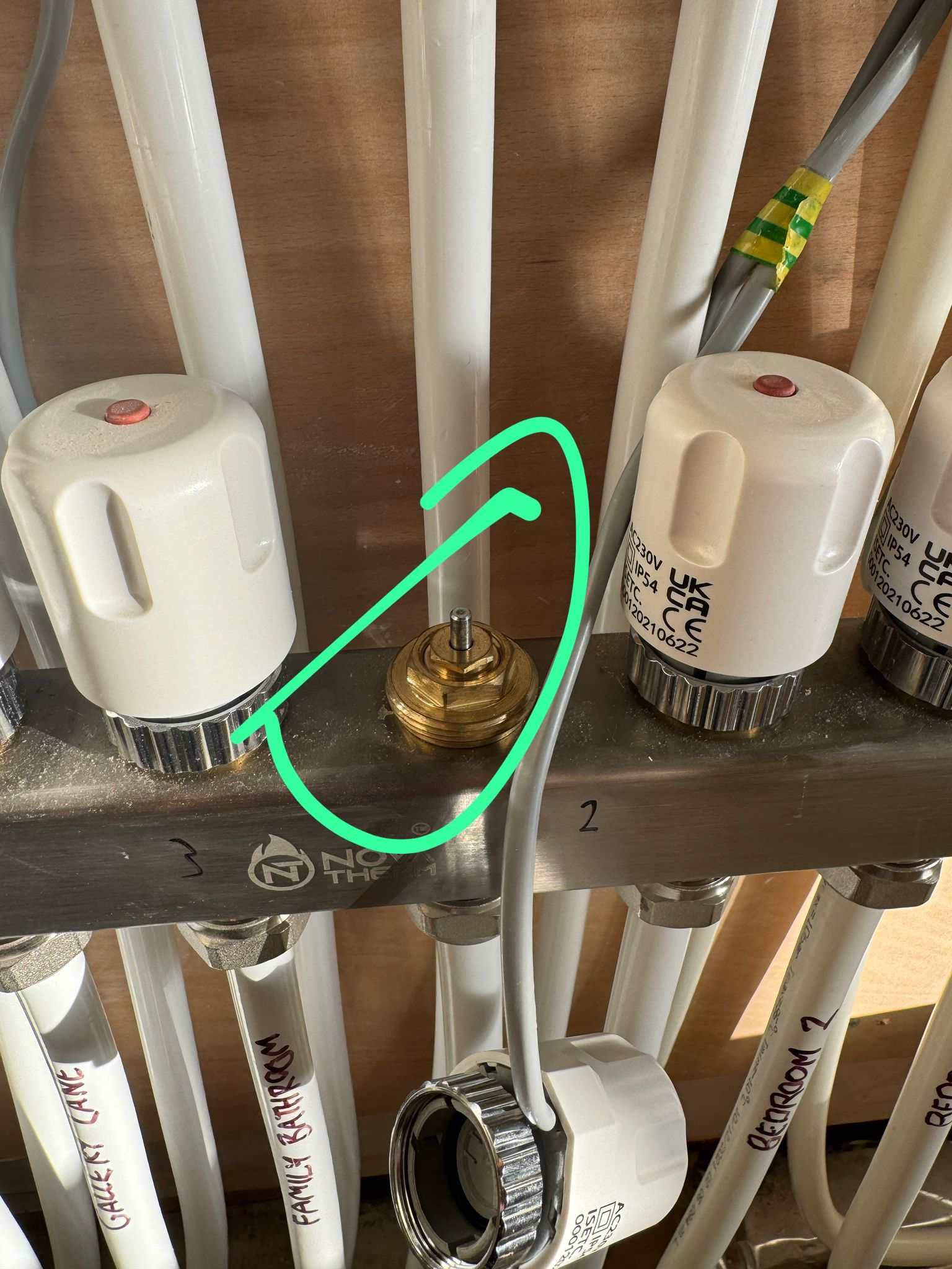

  5. Done that. Should the actuator pin move loosely and freely if there is no heating demand at the moment? It does move, up and down if I press it, but takes a fair bit of pressing, and almost if like there is pressure behind it.
  6. So I've narrowed the noise coming specifically from one of the actuators. But the actuator seems to still be opening and closing correctly, so doesn't suggest a stuck pin? It's a bit bothersome to be honest - quite loud!
  7. Got this clicking sound from one of the underfloor heating manifolds. It doesn't sound like it's coming from the pump, but the manifold itself. To be honest it's quite hard to pinpoint where it's coming from exactly. It starts when the manifold first fires up each time, with the clicking happening very frequently, but over the course of a couple of minutes gradually slows down, and finally stops. Any ideas? WhatsApp Video 2024-10-22 at 09.49.57_2909c610.mp4
