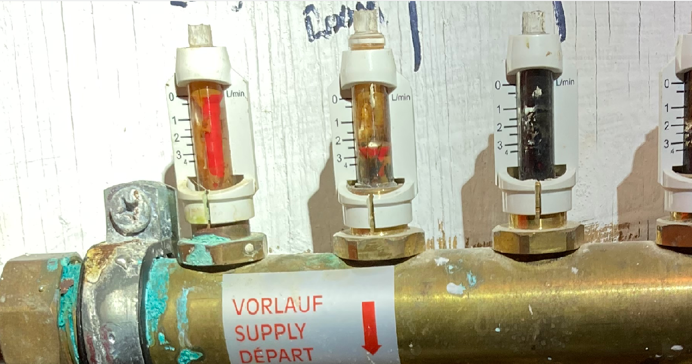

  12. All the flow meters look blocked. Agree with @ProDave, get this flushed, cleaned and then see where you are.
