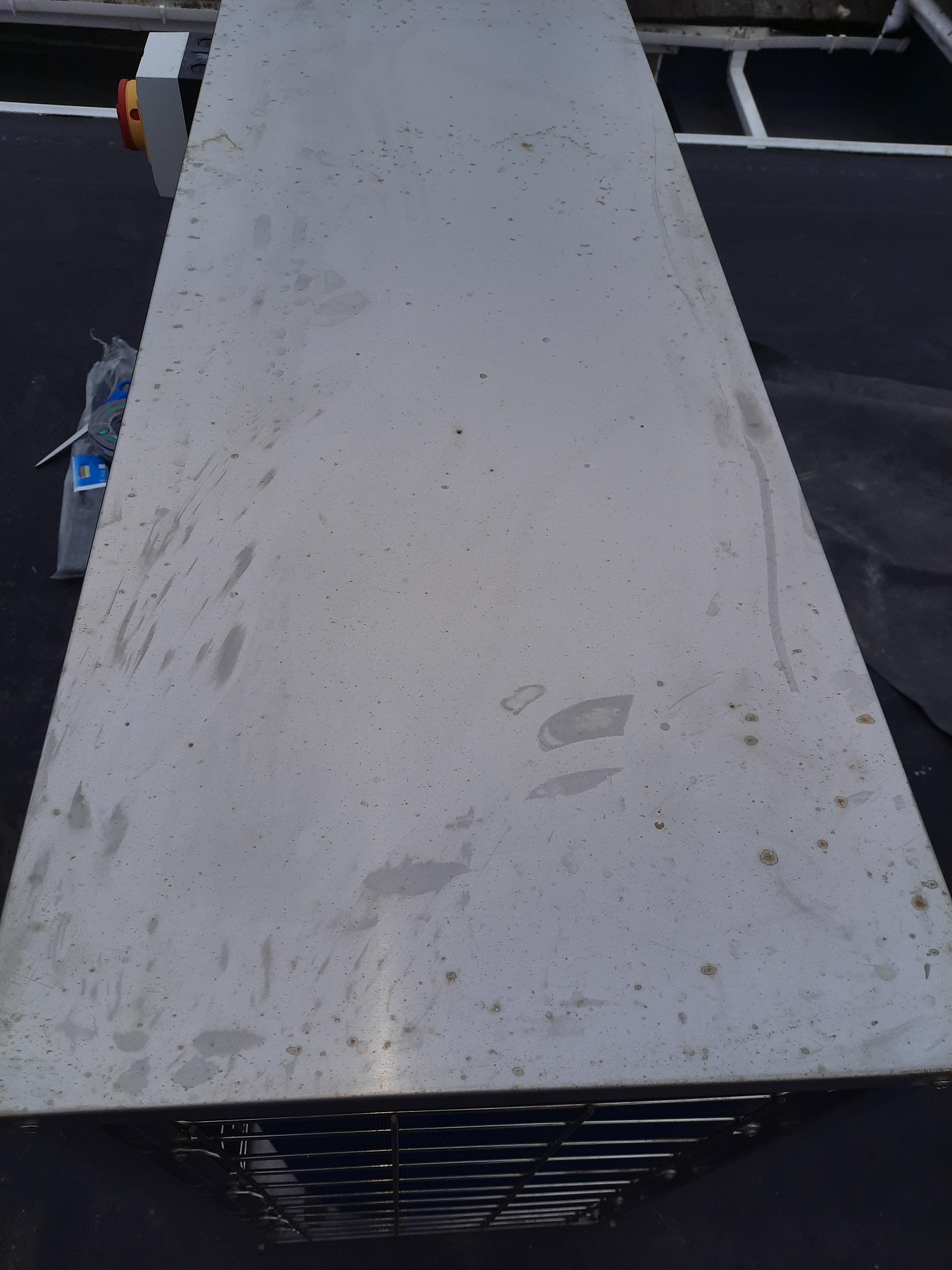

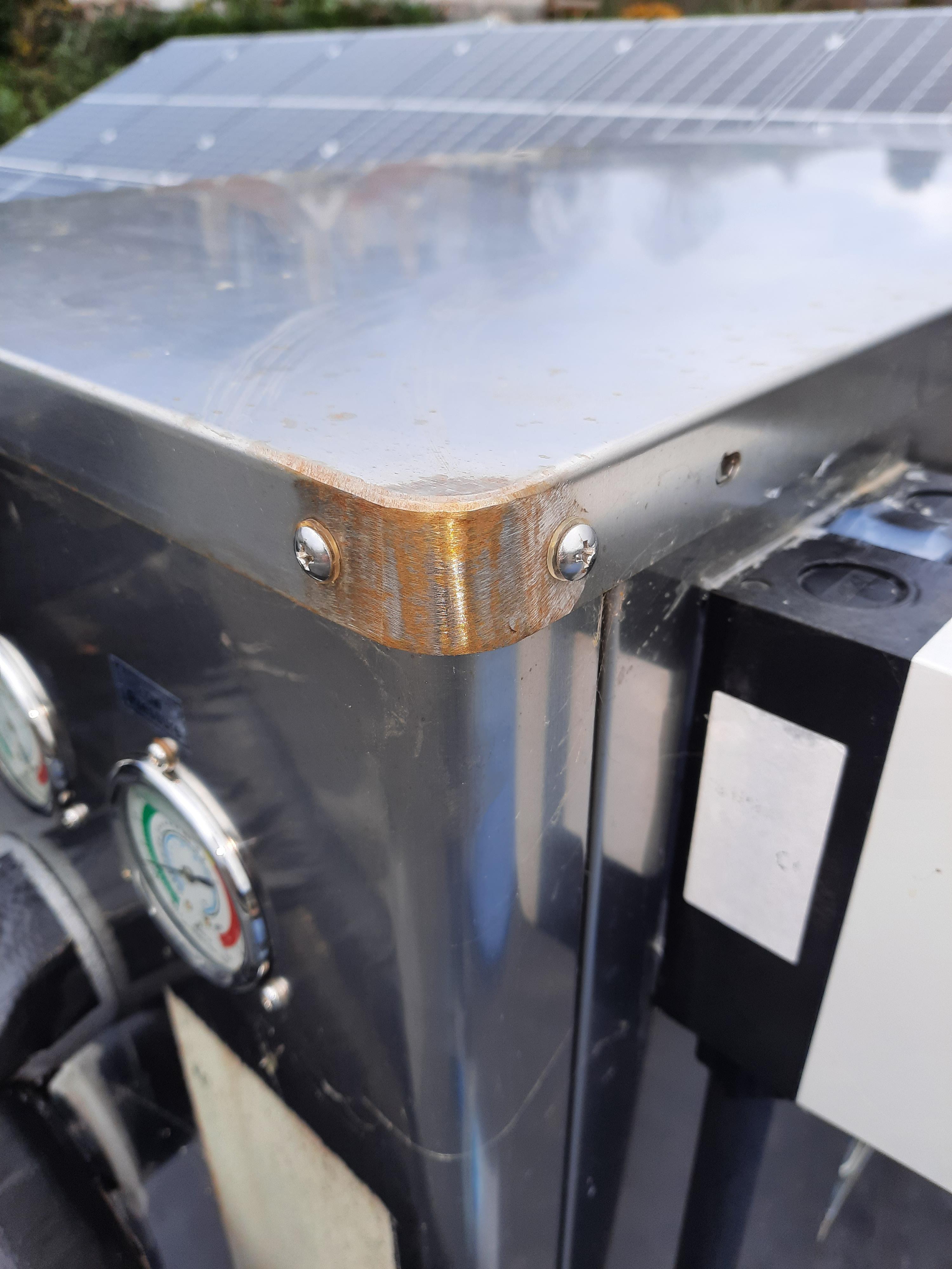

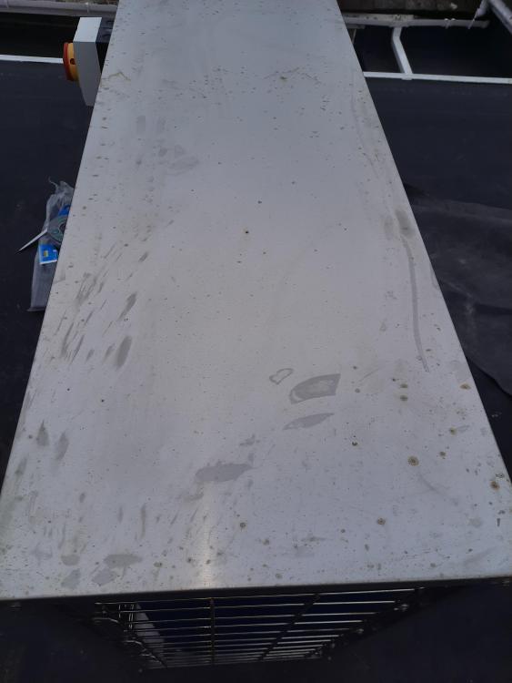

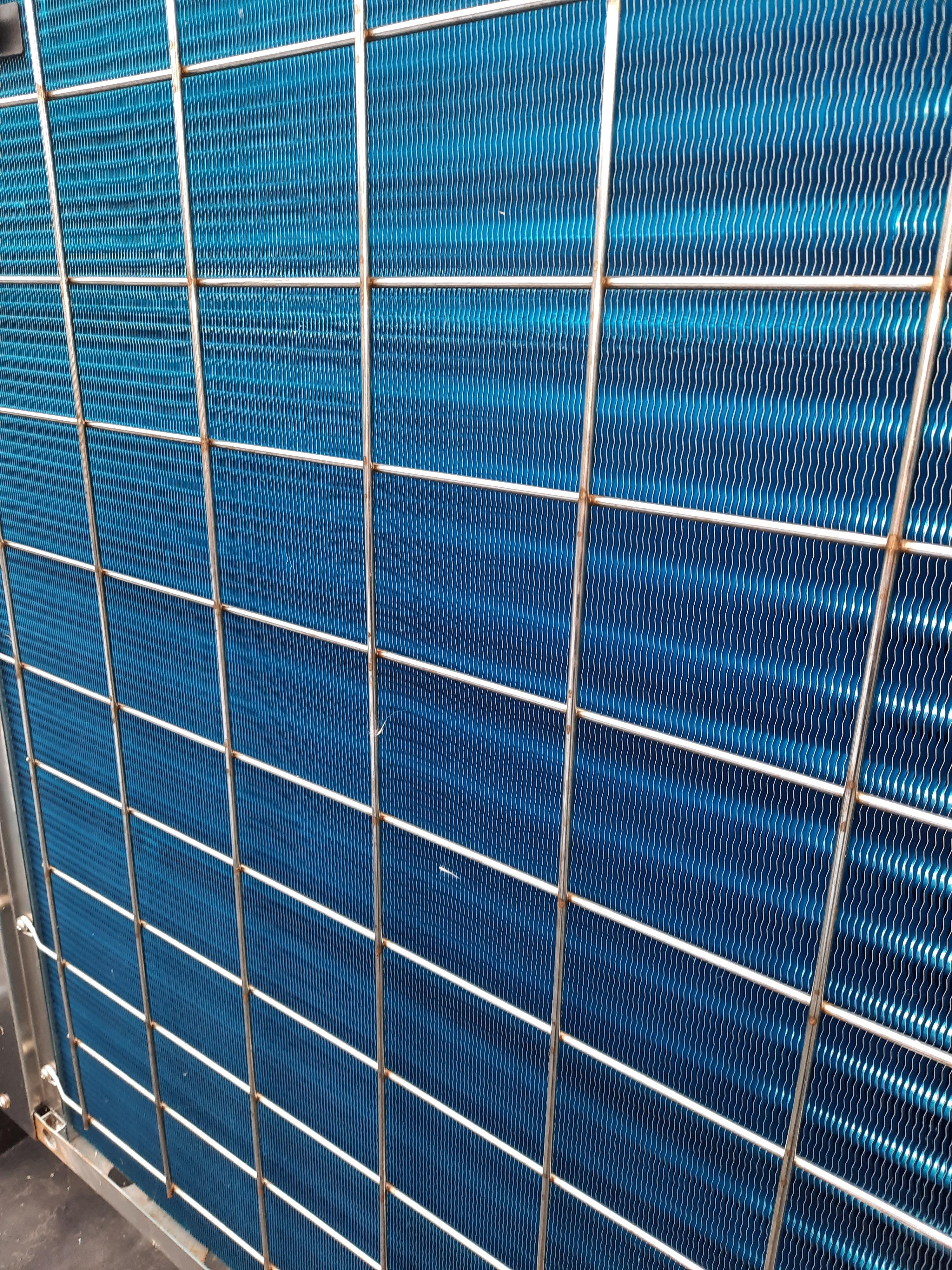

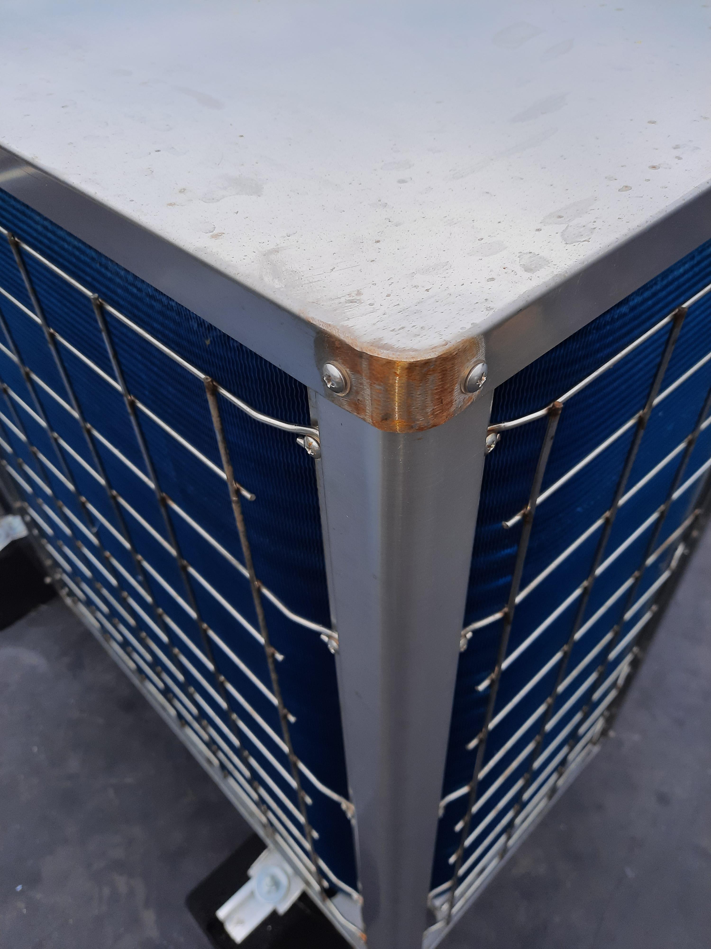

Pictures. Here we go..... particulary visible on corners.. Next is the top... Sort of rusty spots... Back grill where each bar crosses: Going to have fun trying to paint that..
Yes I knew that and I think this is low grade.We live about 800 meters from the sea and I think that's effecting it, but it's only taken 6 months...
No it's stainless steel ?
Hi Has anyone had experience painting stainless steel? I have some external stainless steel that's begining to corrode and I wanted to protect it from further damage. Does anyone have any advice on how to do this / which products to use? Thanks M
