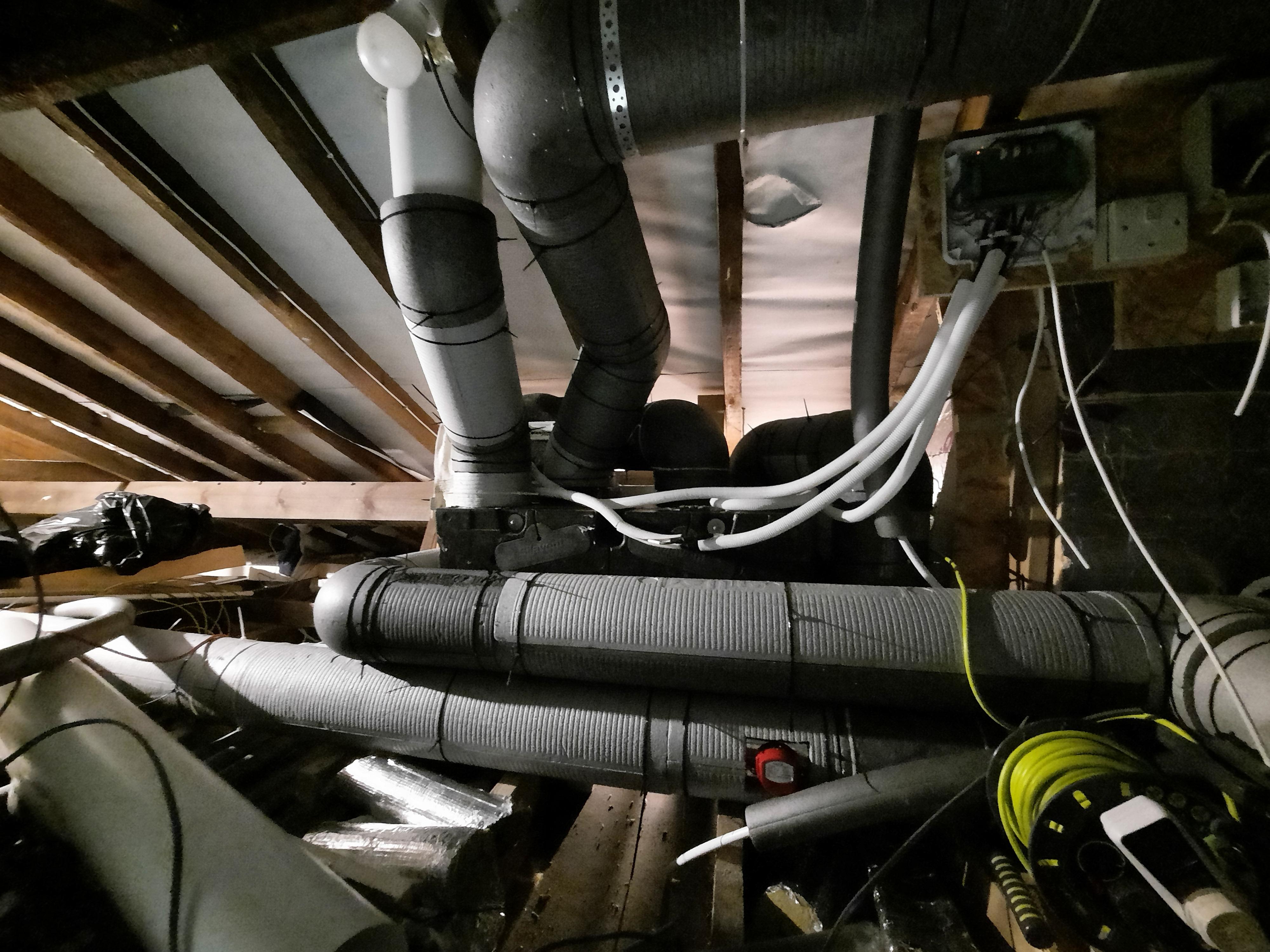

Well the ducting is all buried under a foot of insulation in the loft.   The coil boxes have also been covered more since the photo.   Noted the temperatures of the incoming air at the inlets in the ceilings against the outside temperature. Inside 20C ish, outside 7.8C, incoming air 20C ish.  By my calculations this seemed to good to be true and I realised, eventually, that the air was being warmed up as it passed along the ducts inside the thermal envelope of the

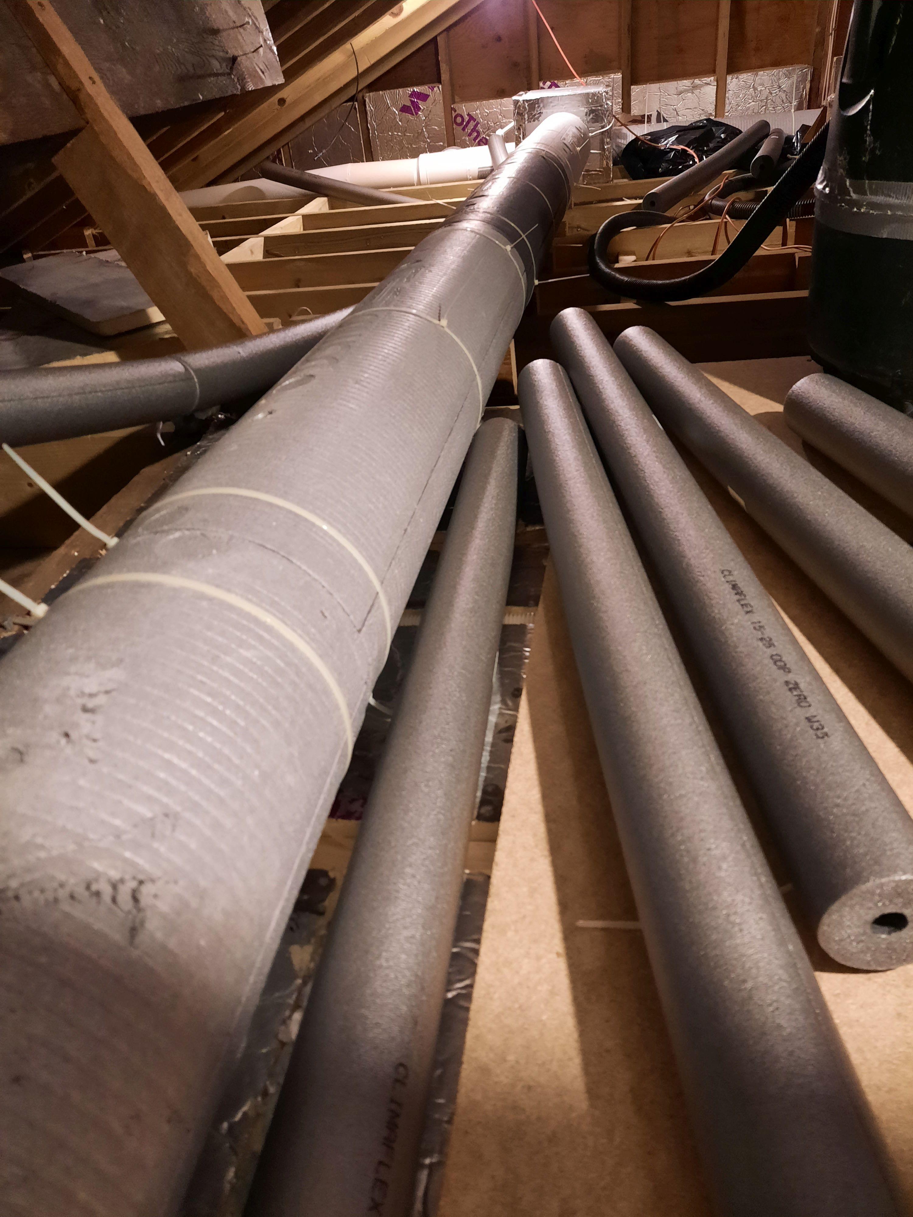

The existing loft insulation irritated the .... out of me. Mainly because I needed to change a lot of pipes in the loft and the roof is only 22.5 degrees and the fluffy was very thick.  What with the 150mm insulated MVHR pipes (190mm thick) 2 high and a roof at 1300 ish it was too cramped. Anyone looking at the ducting photos will see the loft was bare. Before insulating, the bungalow was loosing 87% of the heat through the roof because the rest is so well insulated. Gonna have to tur

More of the same...   When insulating the ducts I noticed that the top of the MVHR was not insulated so I have installed flexi conduit on the cables ready to throw fluffy over the top.       This is the inlet pipe running under the ridge. 150 diameter with insulation held on with cable ties     An installed air damper in red. More about these later....     Water coil with thermal lid. Lid made from PIR.
