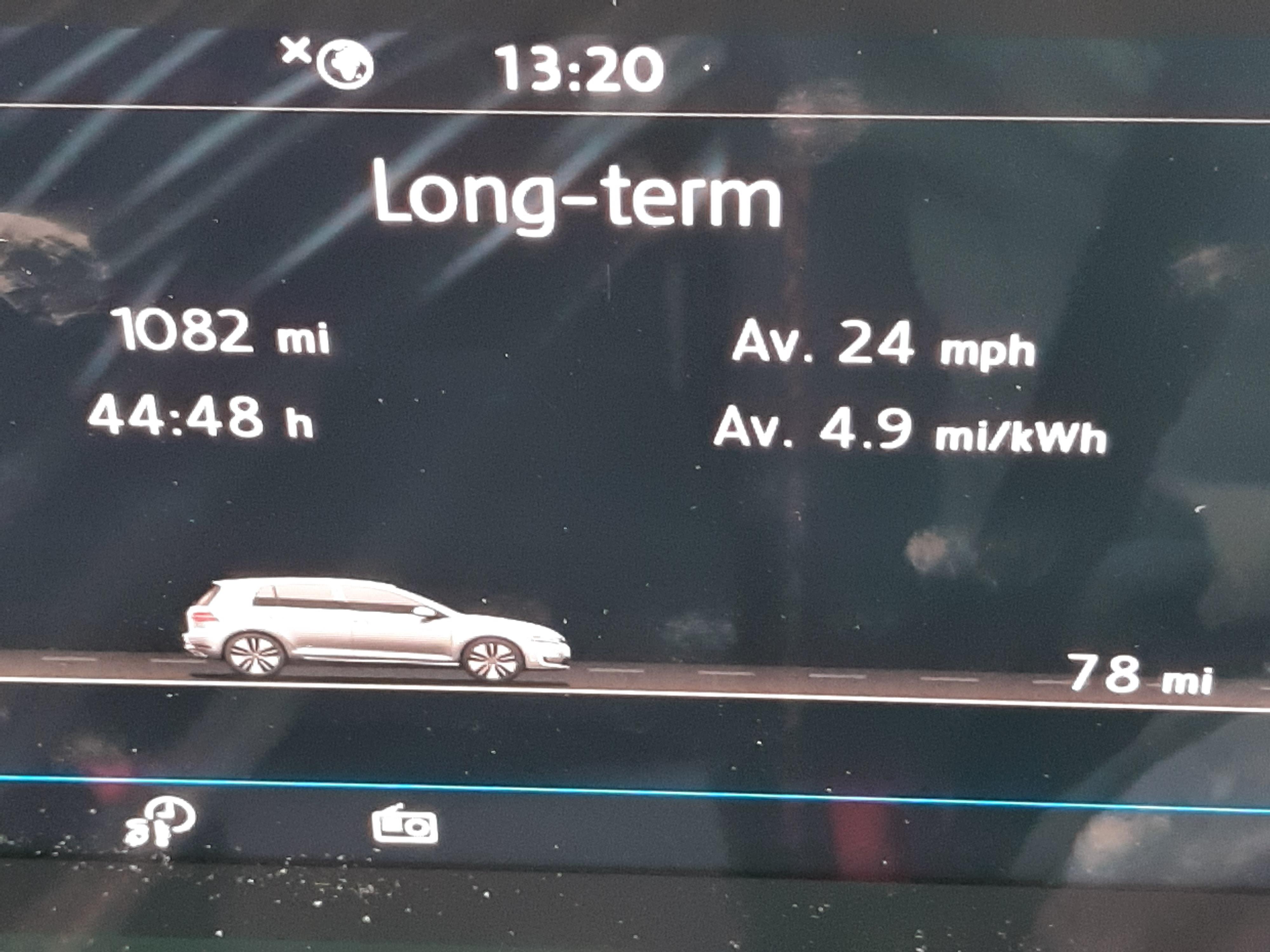

We don't expect to get free energy for transport and agree that the situation suits our requirements, and will not suit everybody's. As the EV spends most of the time at home, and not all day at work, it will work as a storage battery with a capacity of about 40kW (Batteries about 100kW max use about 40kW). Also we are only doing an average of about 20 miles a day so 4kW. The idea is to dilute the mains power with EV, not feed it directly. Once up and running I will set the ST Clamp on the 5.12kW PV system to charge the car once the PV is producing over 1.5 kW (We have a 3kW slow charger.) I'm never quite sure with these cunning plans I have and we will just have to wait and see what happens. M
There may be some confusion @MikeSharp01. The picture shows the journeys over about 2 or 3 months, and my point was that I am achieving an average of almost 5 miles for every kW over many many journeys. At the new price of 25p per kW now, that's about 5p a mile. My petrol work car does abou 40 to the gallon so £ 1.5 x 4.545 litres is about 6.81, divided by 40 miles is about 17p a mile. With PV as well I will see how far I can get this down....
