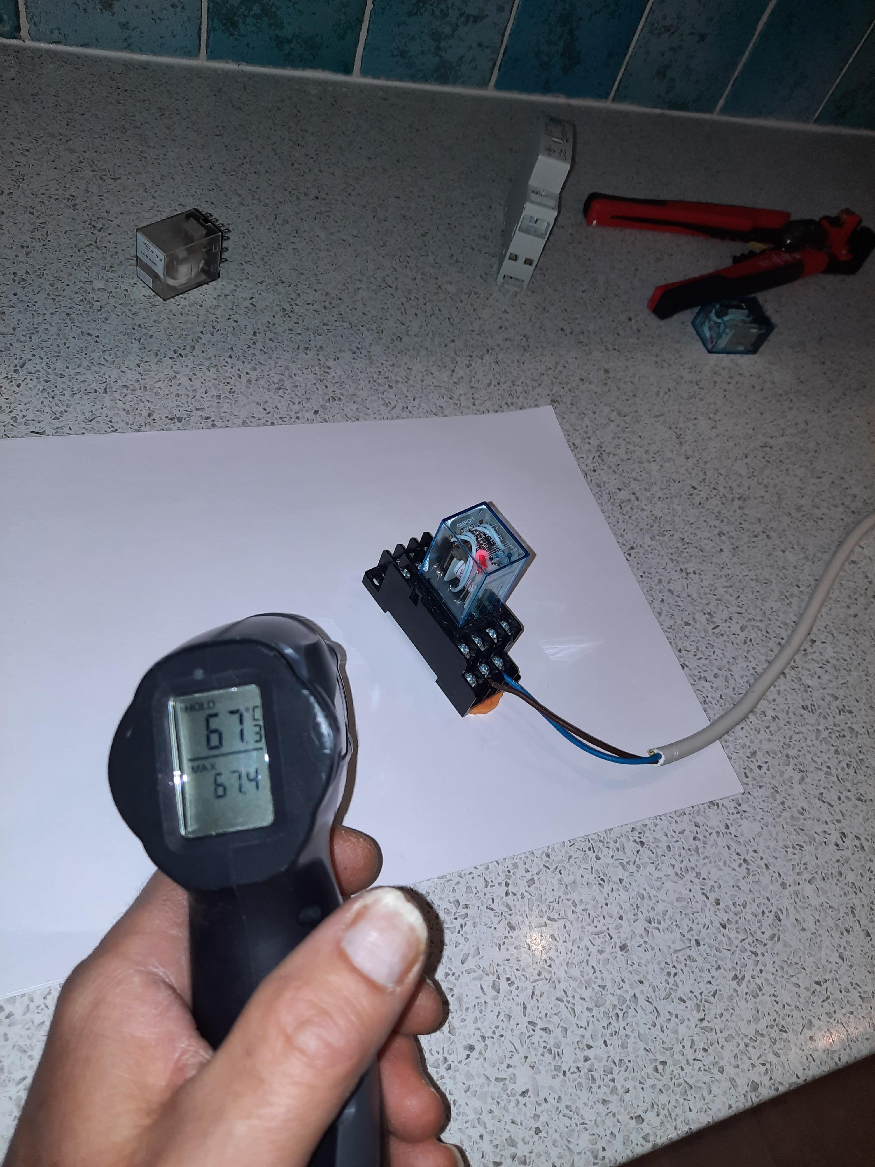

No. This was the bottom plate temperature. Hotter than the rest of the relay, measured up through the surround.

Your reply is near enough for me. Thank you. The "hot OMRCIT ones" were from china. The Beta ones I have had for some time.... The heat in the OMRCIT ones travels along the connectors to the terminals where the cables connect and I have measured over 70C just sitting on the kitchen side! Shut in a steel box with several in a row, with a load crossing the terminals, I think they would rise even higher and may melt the wire sleeving, even using heat resistant wire, so I am not going to use them, especially when they could be energised for hours at a time!
Thanks for that. Anyone: If the coil resistance is 15.92 kiloohms and the voltage is 220 to 240, what is the Wattage? Is it about 3 Watts???

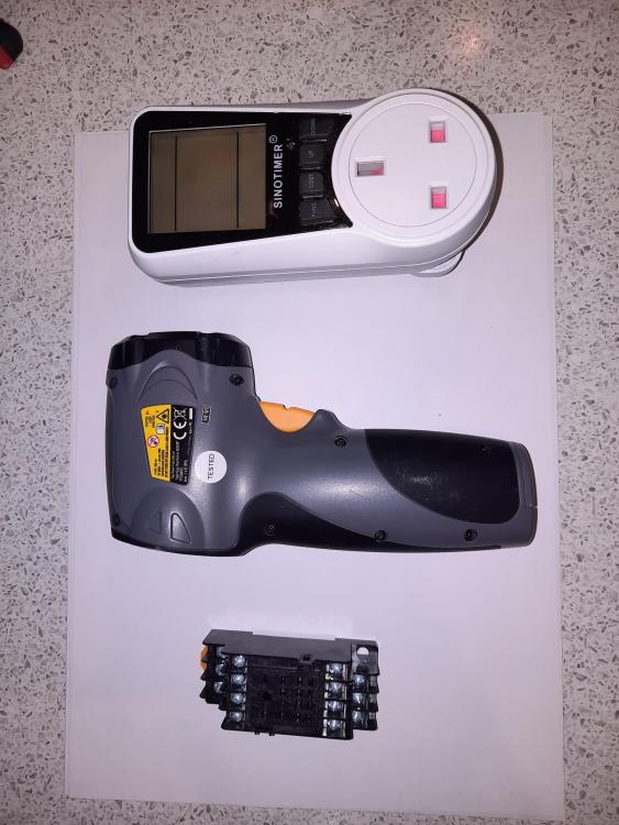

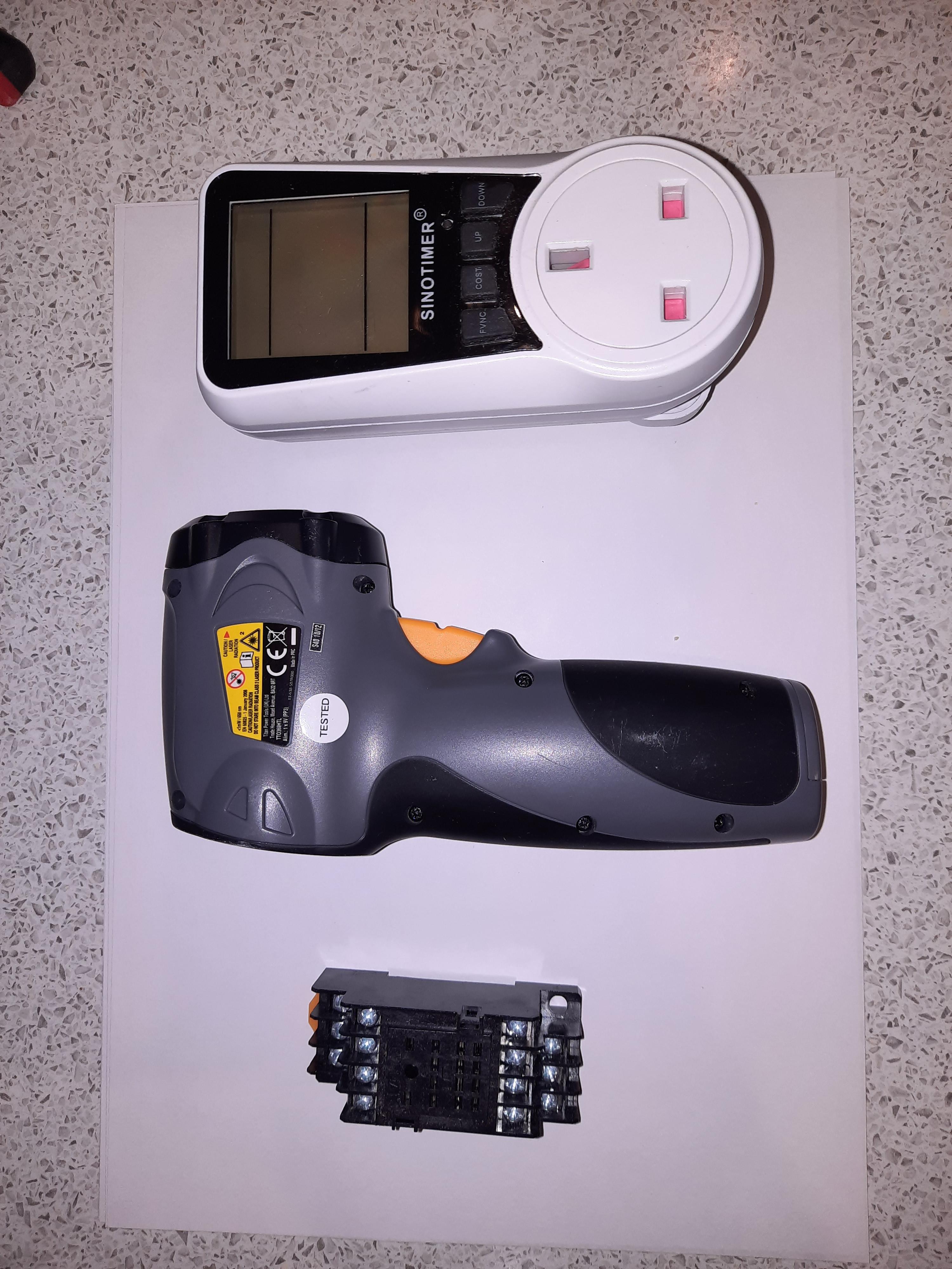

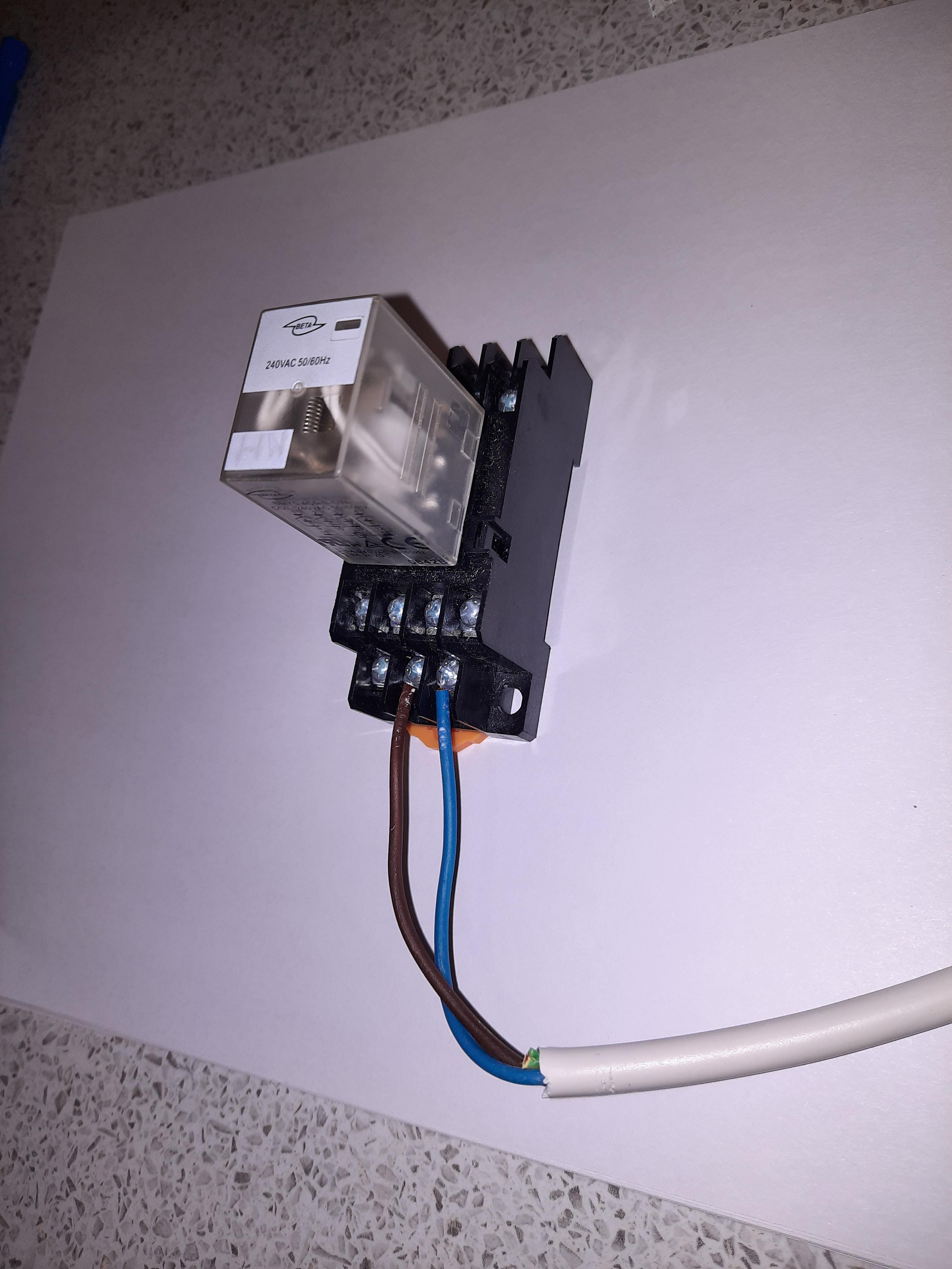

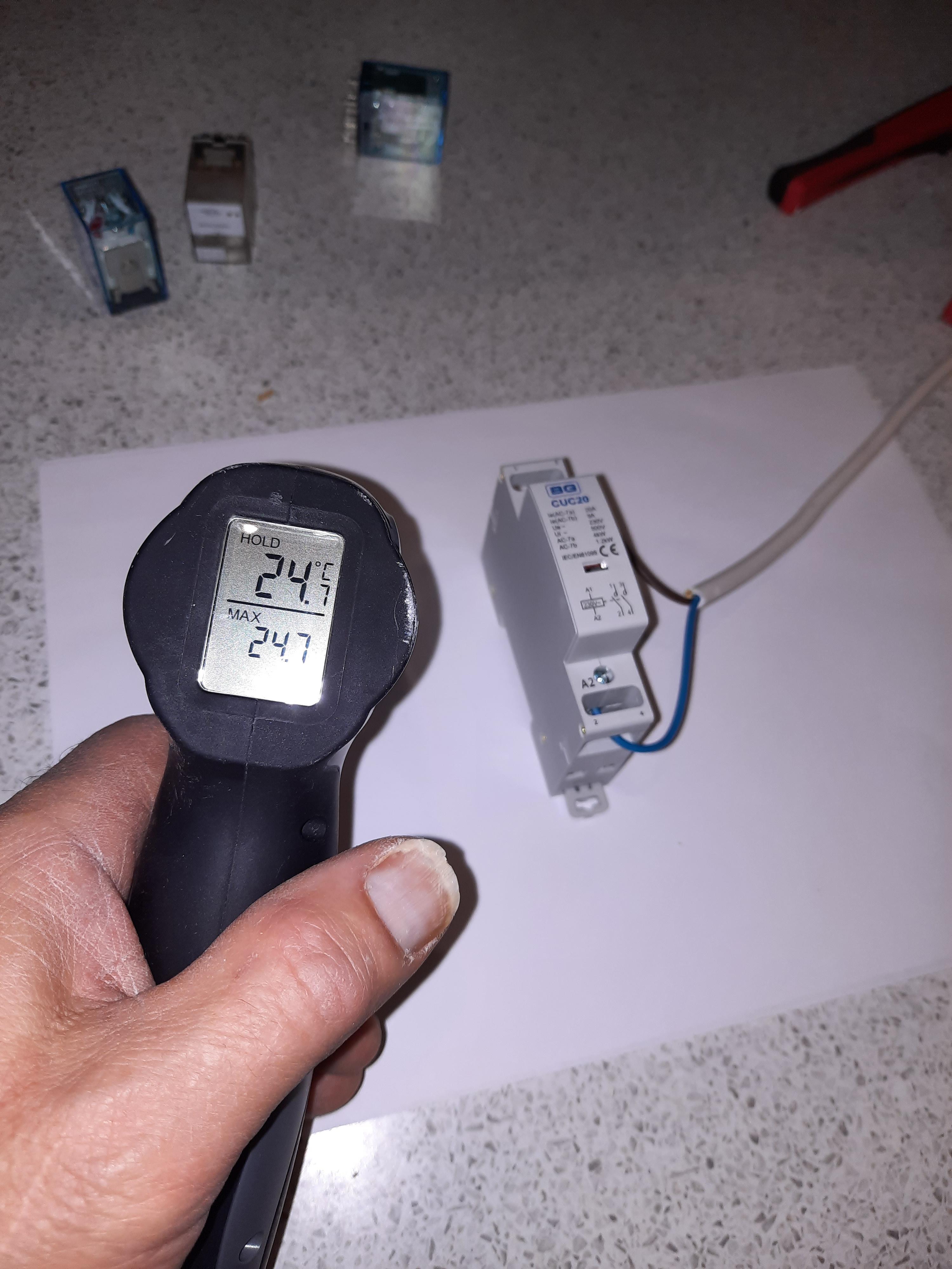

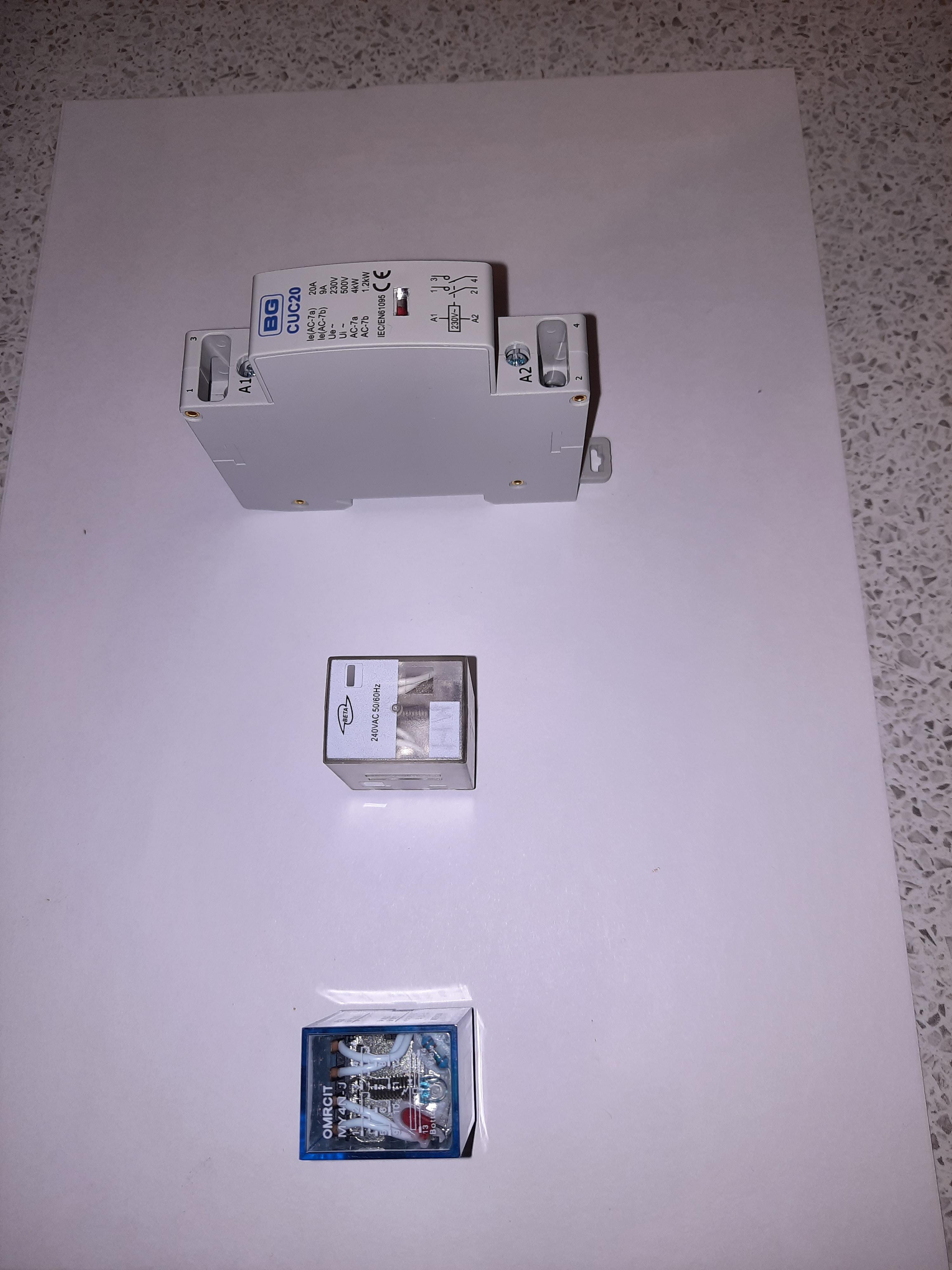

Have been going through relay alternatives for my heating controls. Realised that some relays would be energised for hours and wanted to see how they coped. So here are my test results and questions. Thanks for looking. Equipment: Relays I'm testing: Results: My results based on ambient room temp 23C. All relays not under load. All relays 240v coils. BG CUC20 Watts when energised 2.2 steady. Temp after 10 mins 36C BETA Watts when energised 1.7 steady Temp after 10 mins 35C OMRCIT Watts when energised 4.7 to 4.1falling Temp after 10 mins 67C This one has a neon. Is the high temperature of the OMRCIT, when not under load, a concern? Bet you can guess which one cost the least.
