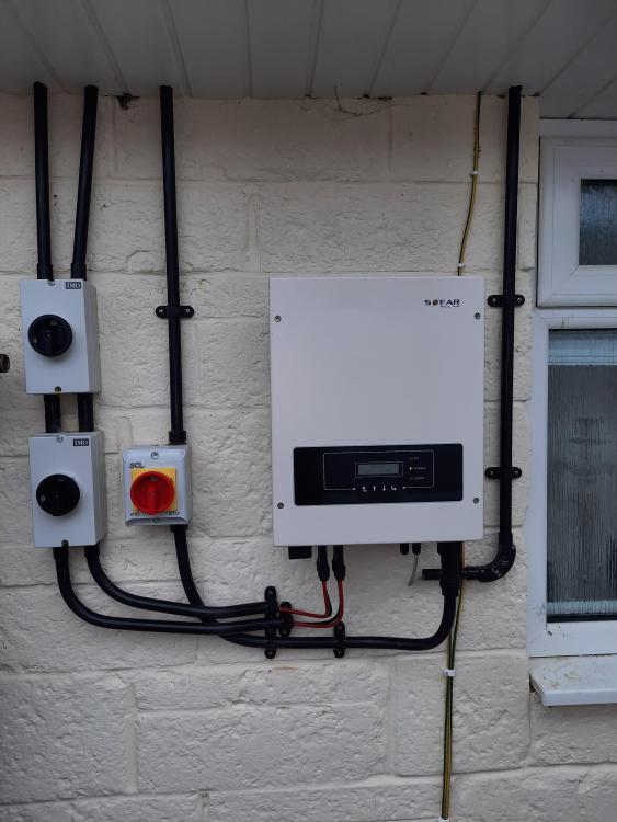

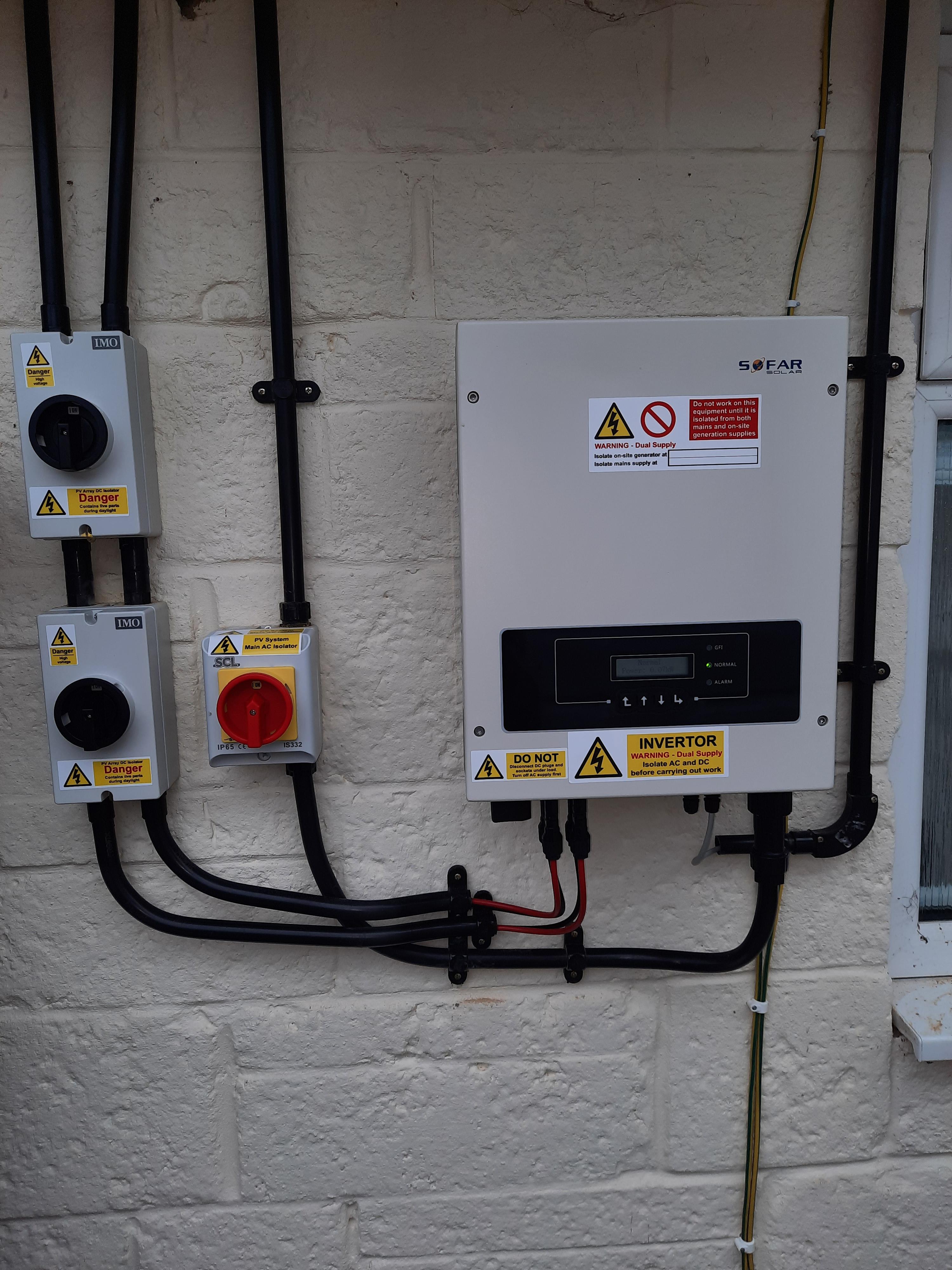

Yes, they are due round. Paid my £360 for that. Positions of isolators as submitted in application....
I think I will label that up to remind me. Its always months/ years later that you come back to do something...
Yes the maximum the inverter will take. It also allows room for me to fix extra panels to the chimney..
Yes, perhaps proper function but form needs improvement.
Hi @mrbd Yes it looks worse than it is. The top DC isolator isolates string one only and the lower one isolates string 2 only. Here's the mathematics. The percentages are related to the inverter maximums: Set up Quant Watts Longi 320 watt panel 1 320 Watts amount of panels 16 5,120 Watts 85% Inverter Max 1 6,000 Watts DC isolator max amperage String wattages String 1 7 2,240 Watts 56% 7.84 String 2 panels 9 2,880 Watts 72% 7.84 Maximum string 4,000 Watts Panel voltage panels 41 Volts String 1 panels 7 286 Volts 48% String 2 panels 9 367 Volts 61% Maximum string Voltage 600 Volts
Gravity?
Forgot to stick on labels.....

Watch out for the technical details on the RCBO. Mine had to be 0.1amp
All I know is it works like that. I think you can put the inverter and RCBO before any load. So both in the garage before connecting to the house cables. You need to check what your equipment says is required. The RCBO requirement was a real bind.
