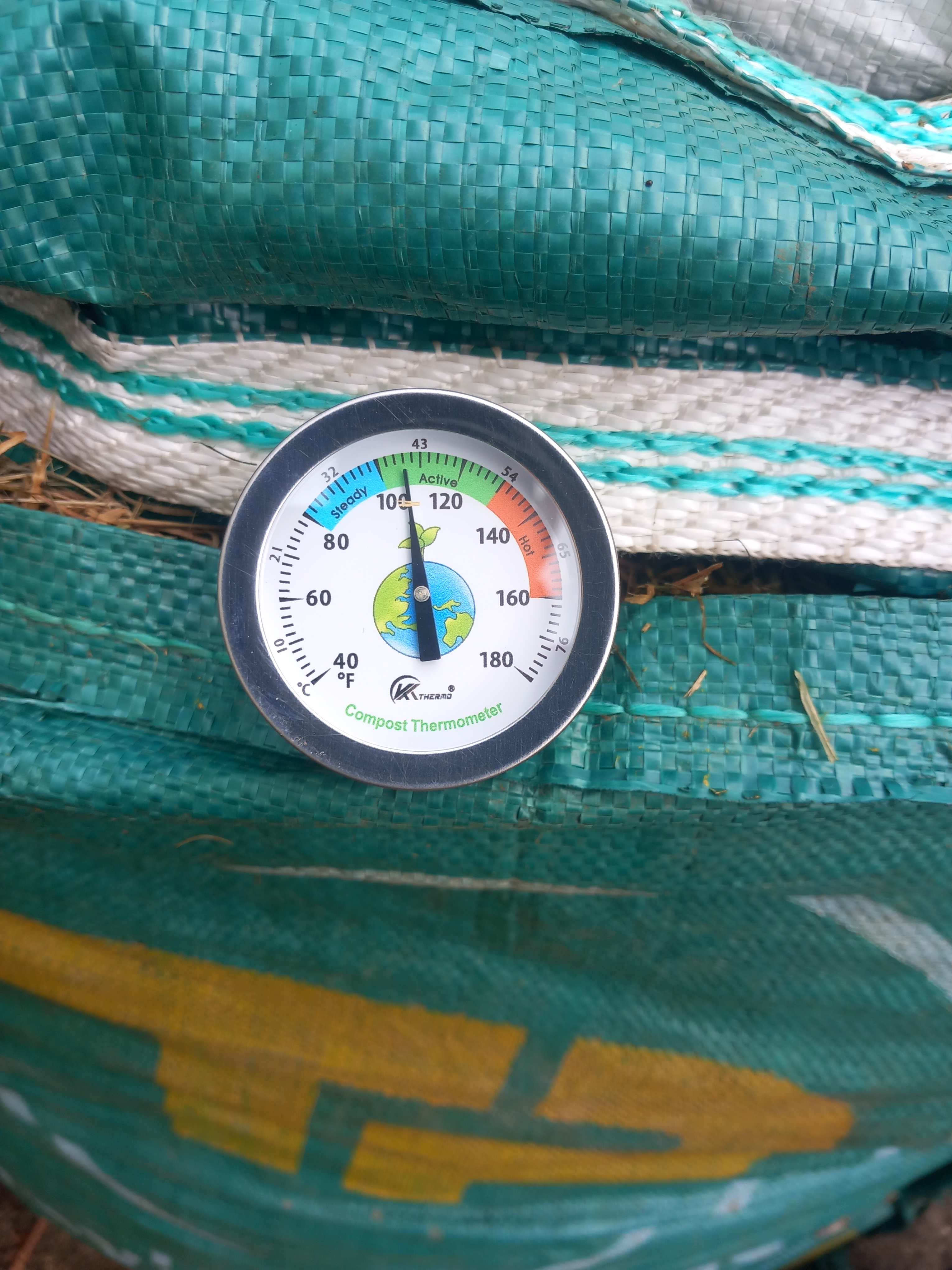

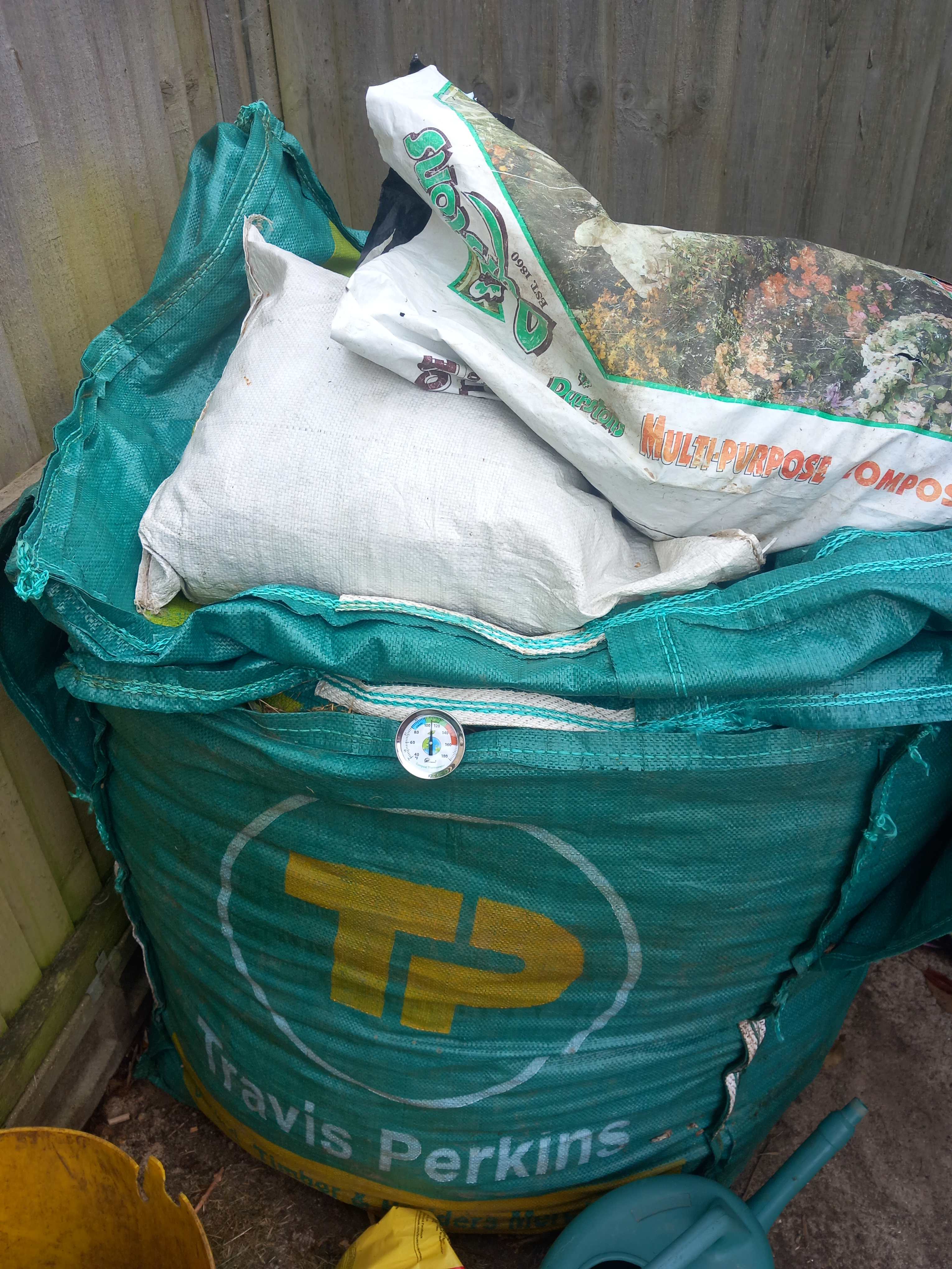

Interesting. There are several searchable technical trials on compost used to produce energy (mainly heat) from a small scale to an industrial scale. Reading the results and conclusions give a good general understanding of how to get the best for my garden. Made quite a lot of compost and tried several versions over the years. From what I understand, basically the rotating bins help air flow and uniform decomposition. If you start with understanding that in order for the breakdown of the vegetation you need the right temperature, humidity, aeration and fresh waste at start, all the rest is easy. The main difference with the rotating ones, with or without insulation, seems to me to be to effect speedy and uniform results. What system/apparatus would be best for you would depend entirely on the supply you have, what outcome you want and when you want it (slow or fast breakdown). After many trials I use a jumbo bag method. (All food waste goes in the worm bin). I shred all my garden waste (and some of the neighbours) that's woody and mix the various types either together or in thin layers in the bag. (no evergreen). Because it's so big it holds the temperature in the middle so no particular need for insulation. When it comes time to take it out I grade the result: good stuff one side, un-rotted back in a different jumbo bag to sit for a year because once the bacteria is dead (too cold/hot/dry/wet/no oxygen) you're back to rotting it the slow way. To check the temperature I use one of these: cooking well even after a cool night... In this bag I put a layer of 2 inch old wood chippings in the bottom to help with drainage. Filled 6 of these last year: all gone on the garden. You should never need to dispose of any garden waste apart from thick wood!
