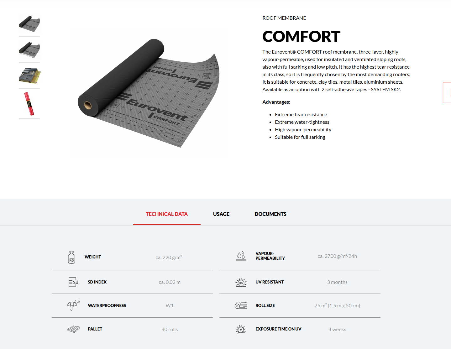

  4. As the title suggests, contractor is proposing a Eurovent Comfort membrane on a reroofing job. I've never come across the product before so just wondering if anyone has any experience of it. The specs all look good.
