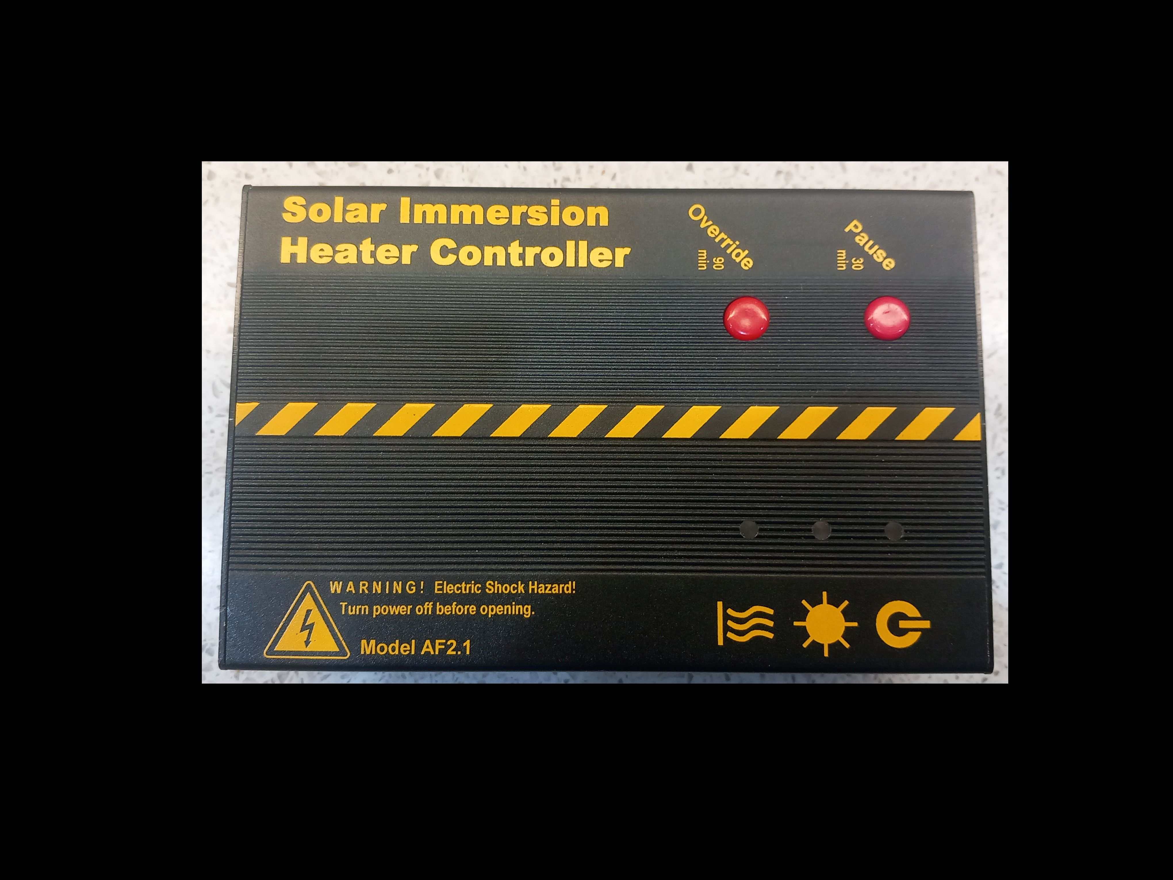

Solic 200 like Blackpool Lights - Help Needed
Marvin replied to canalsiderenovation's topic in Air Source Heat Pumps (ASHP)
Hi @canalsiderenovation, @eugen, @Klam Etal. Thanks for this thread. I have a Solic which suddenly had the power light go orange (Yes both green and red at the same time) so the same capacitor problem! Its the old AF2.1 model and I didn't want to install a different one. I will load up progress here as I go. Marvin. -
