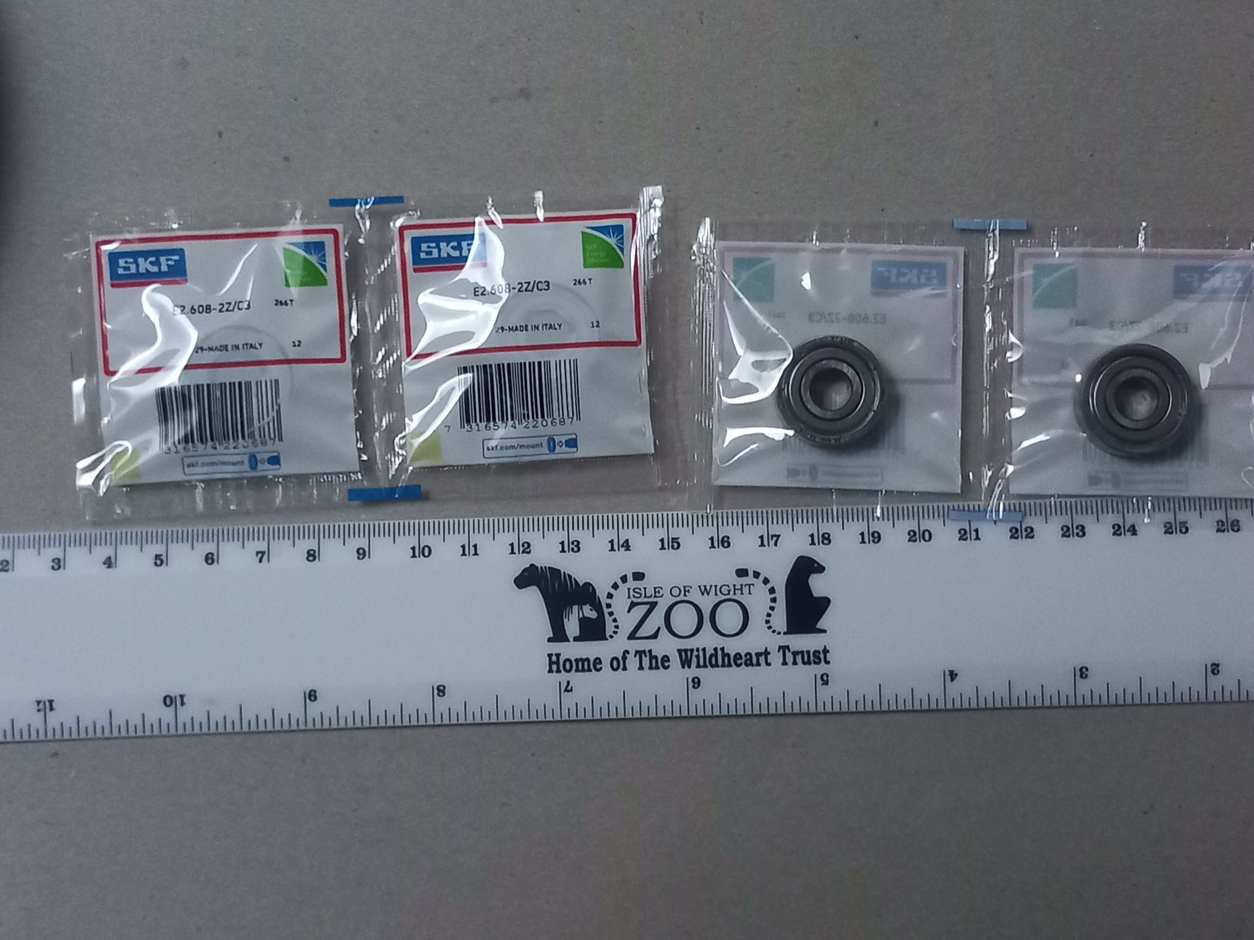

  6. Today I found out that our DOMUS HRX2 MVHR which was installed in 2017 was not running correctly. Upon inspection it appears to be the fans in the unit are not working properly. Based on the excellent information, from @Steve W and others above, I am hoping to avoid paying about £800 for the 2 new fans and I am gambling that the bearings are shot and have ordered the SKF E2.608-2Z/C3 8 x 22 x 7. I never thought of this and will have fun trying to get access to the unit in my loft. During the renovation/build, my wife insisted (may I add against my better judgement and being a waste of money) that we have openable windows! Because of this we will now be able to have an airflow although the building whilst I attempt to fix the darn thing. I will never hear the end of this!
