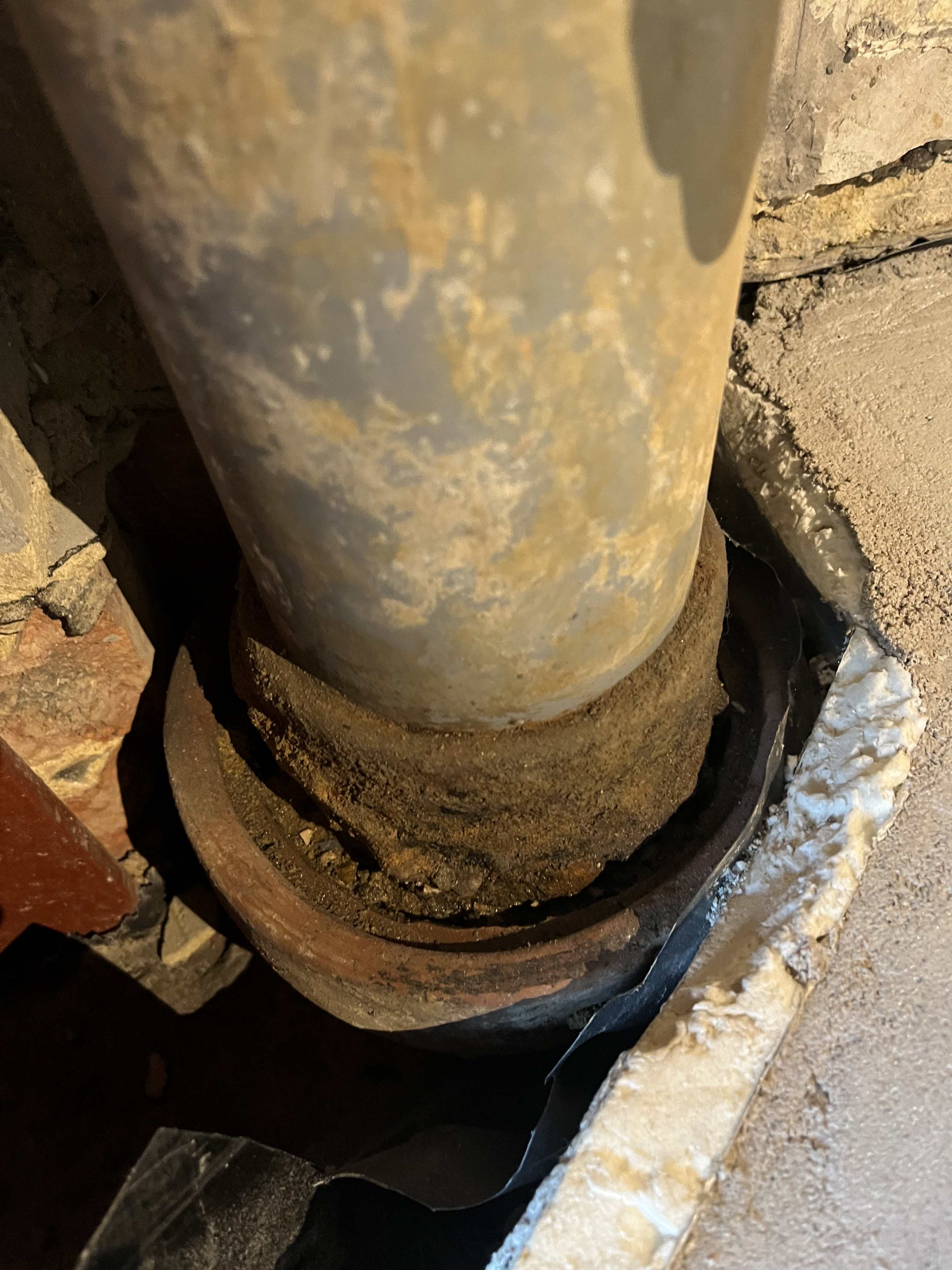

  4. Thanks both of you. I think those adaptors are for connecting clay PIPE to plastic. Not clay fitting to plastic. I don’t believe there’s a fitting for that. If there is, I certainly can’t find it. A design cock up from when it was built. I’ve just had a look at the connection for my downstairs loo and appear to have similar. Just pointed up with mortar. Which seems to prove my theory that is what used to be at bottom of soil stack. I think I may well run a bead of ct1 or similar round it to seal the inside edge and then point up what’s left. Cant see that leaking. I can’t really see a better option and it’s quick cheap and easy as a bonus.
  5. Thanks very much for taking the time to write this substantial reply! It’s an internal soil stack. To be boxed in asap. The finned pipe connectors are for fitting inside a clay PIPE, not a clay FITTING/ELBOW like I have? (apologies for caps) My clay elbow is designed for a clay pipe to fit into it? A complete cock up by the original builders in the 60’s imo.
  6. It will be boxed in so just want to patch up/sort out what I have properly
  7. I think both those adaptors are designed to go in a clay pipe, not a clay fitting/elbow?? Got a link to band seal please? Thanks
  8. To add, not sure what’s at the bottom of the plastic. Some sort of metal, but not sure exactly what.
  9. Late 60’s build. Got a soil stack - plastic 110mm connecting directly into a clay 4 inch elbow at ground level. Unfortunately and obviously, the OD of the plastic is smaller than clay pipe so it doesn’t fit properly. It will have been like this since built. I’m thinking there used to be mortar around the joint to seal, but this has failed over the years. When toilet is flushed you can see it slightly bubbling around the join and it’s very slightly damp, but not affecting surrounding area. However, I’m worried about what happens if the pipework backs up. Surely that join needs to be waterproof!! How should I rectify? See picture below. Thanks in advance.
