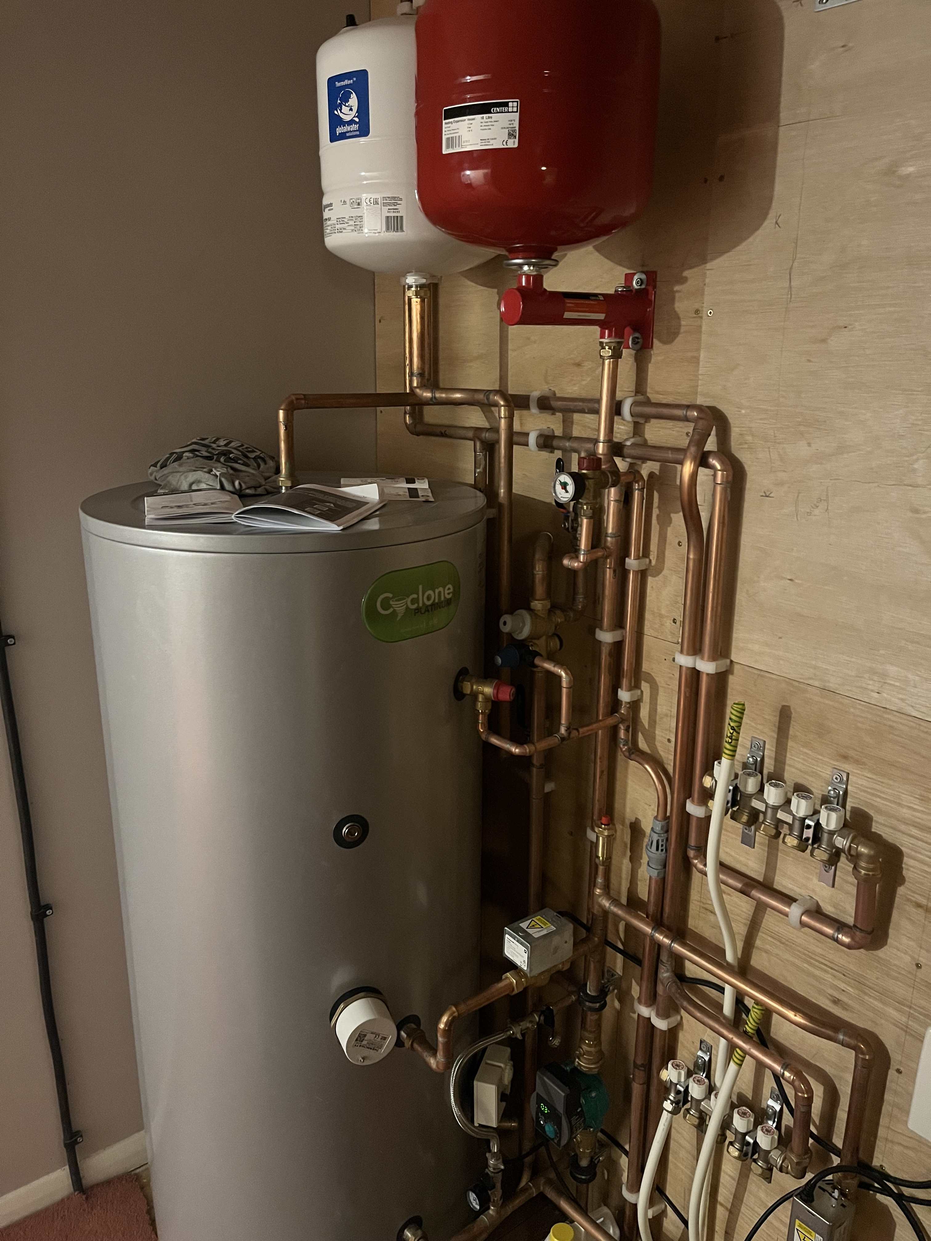

  4. Start with the simplest/cheapest fixes and go from there. Raise vent pipework Check H pipework Consider blockages elsewhere - heat exchanger potentially If raising the vent pipework cures the issue, happy days. I still suspect there is a partial blockage somewhere, but it might be years before it causes a further problem, if ever.

  17. At a guess, when you get a restriction, the pressure created by the pump causes the water to take the path of least resistance - up the Vent pipe.
  18. Heat exchanger wasn’t totally blocked on my boiler either. Just about heated the cylinder and got the rads hot for 20 mins or so, then went lukewarm. The USP3 is a very common pump. It won’t be the sole cause of pumping over on a system configuration and that has never previously pumped over imo. I think it’s pretty well nailed on that there’s some sort of obstruction/blockage on the primary circuit. All only in my opinion obviously.
  19. There’s no doubt it’s a slight risk. The part could be damaged, perhaps even by plumber upon fitting - who will blame the part probably. However, if you can find someone sensible to fit it, it’s a risk worth taking imo. Those boilers are fairly bulletproof otherwise in my experience (had one in my old house for 9 years - was 14 years old in total when I sold - zero problems) and your only other option is new boiler if the heat exchanger is indeed blocked.
  20. This is still sounding so much like my situation from a few years back. I also changed the pump as a first move. I also then cut the H section out and found it clear. I removed the mid position valve and found that clear. I then decided it was very likely the heat exchanger in the boiler as it was unlikely to be anything else stopping good circulation around the primary circuit. Also open vented systems suffer with sludge build up, and I had no magnaclean. It’s interesting that my boiler is also the same as yours. You could just replace everything to fix as plumber 3 wants, but seems wrong to me. If I was you then I’d check the ‘H’ section of pipework and if it’s clear I’d be getting the same refurbed heat exchanger that has cured my problem. Assuming you can find a plumber willing to spend a couple of hours fitting it for you that is. I twisted a mates arm (quite hard it must be said!) £150 for him and £80 for the heat exchanger- which according to him looked new.

  24. Am I correct in thinking that pump over isn’t the only problem (symptom) here? The original (and also current) problem is lack of circulation and radiators not getting hot enough. Is that still the case?
