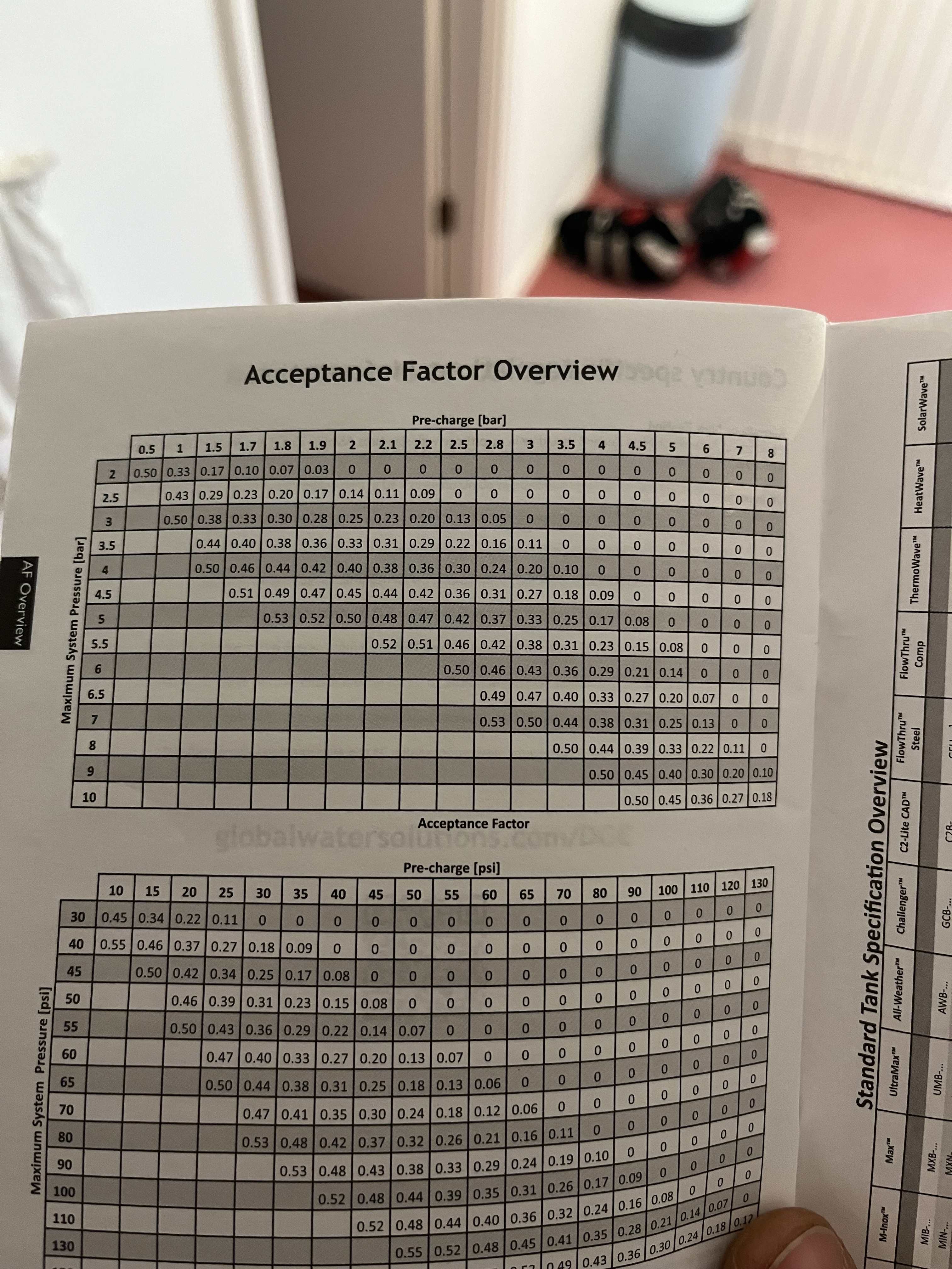

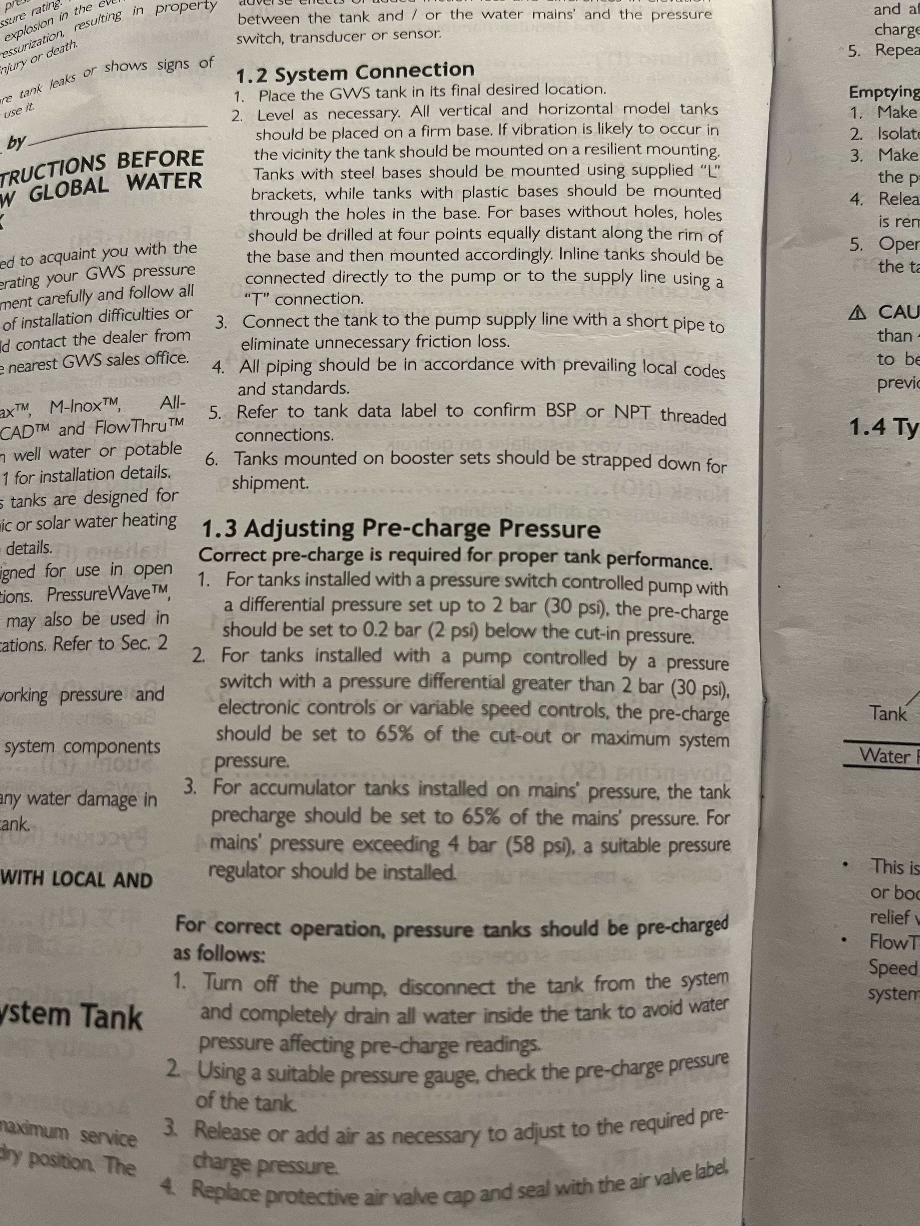

Just checking the EV instructions. I think it says 65% of max pressure. So 65% of 3 bar. Equals 1.95 bar However there is a pre charge acceptance factor table. But I don’t really know what it relates to at a glance through instructions. -
