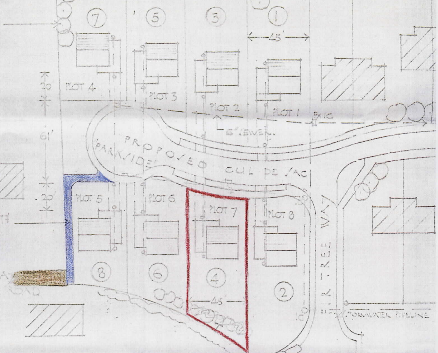

  5. Thanks for the advice, the red circles you have drawn are foul drains manholes. I think there is also a dotted line connecting to the storm water drains (in green on your drawing) from each property. Just to the left of the red line leaving my property. I’m going to try and lift the ‘green’ inspection chamber to the front right of my property in the next few days. Is it possible that my downpipes eventually connect to this (along with presumably the rainwater drains from the side of the road etc)? Edit, on second thoughts, that could just be the driveway being shown!
  6. Following on from my other thread re foundation design near a large oak tree, I will also need to think about dealing with rainwater from the extension. I'm told a soakaway is not possible, because it will either be too close to the oak tree, the extension, or the boundary. This seems like it's probably true, but is there a set distance a soakaway must be away from a building/oak tree/boundary? I'm not sure what the current setup is, but I'm pretty sure it's not a combined drain. Property was built in 1970. A 'stormwater pipeline' is shown on the planning drawings we have from when the house was built - unfortunately not all that clear. I've not got around to it yet, but we are plot 8 in the picture and the manhole cover shown to the front right of our property is there. I guess I could lift this and pour something in the downpipe to see if that's where it goes. If so, can we just connect on to this same system in general? Architect was going on about having to pay the water supplier a monthly amount to discharge into the foul drains. Something I'd like to avoid obviously! The one shown in our rear garden definitely isn't there however. I've dug out a whole section of ground more than a meter down in this area (don't ask) and found nothing! Thoughts welcome
  7. Hi all, I've been lurking here for a while and trying to contribute where possible, but it's now time to start asking some questions of my own. We are about to have some planning drawings done for our rear extension and having worked in construction on domestic properties for 20 years, I'm quite confident in my knowledge of a lot of things construction related, but foundations/groundworks are not one of them! We have done various other projects in the past, including a new build in our garden a few years back, so I'm not new to this, but this time we have a large oak tree roughly 10m from where the closest point of the extension will be. I know from experience that architects/structural engineers etc will generally look out for their own interests/do what's easiest/just not have a clue. I don't want to be spending any unnecessary money going down blind alleys. I don't know what the existing foundations are, but with no evidence whatsoever, I assume strip foundations. Existing house is 13m from the oak tree at closest point and was built in 1970. Anyone care to comment on this assumption? Would piles/a raft have been used in 1970? Either way, I think for an extension a raft is pretty much off the table. From using the LABC online foundation depth calculator, it does appear very likely we will need to pile. The ground is clay (we're just north of the South Downs and the whole area is clay) and with the tree the calculator is showing that it's outside the scope/deeper than 2.5m for strip foundations. To get to the point of my post, should I commission a ground/soil report, and what exact tests do I need to have carried out? Alternatively, should I just accept now it will need piling and go straight to a specialist and have them design it after their own ground/soil survey presumably? Will the piling companies want a report to have already been carried out, or will they want to do their own? Sorry for the rambling post, thanks in advance for any help offered.
