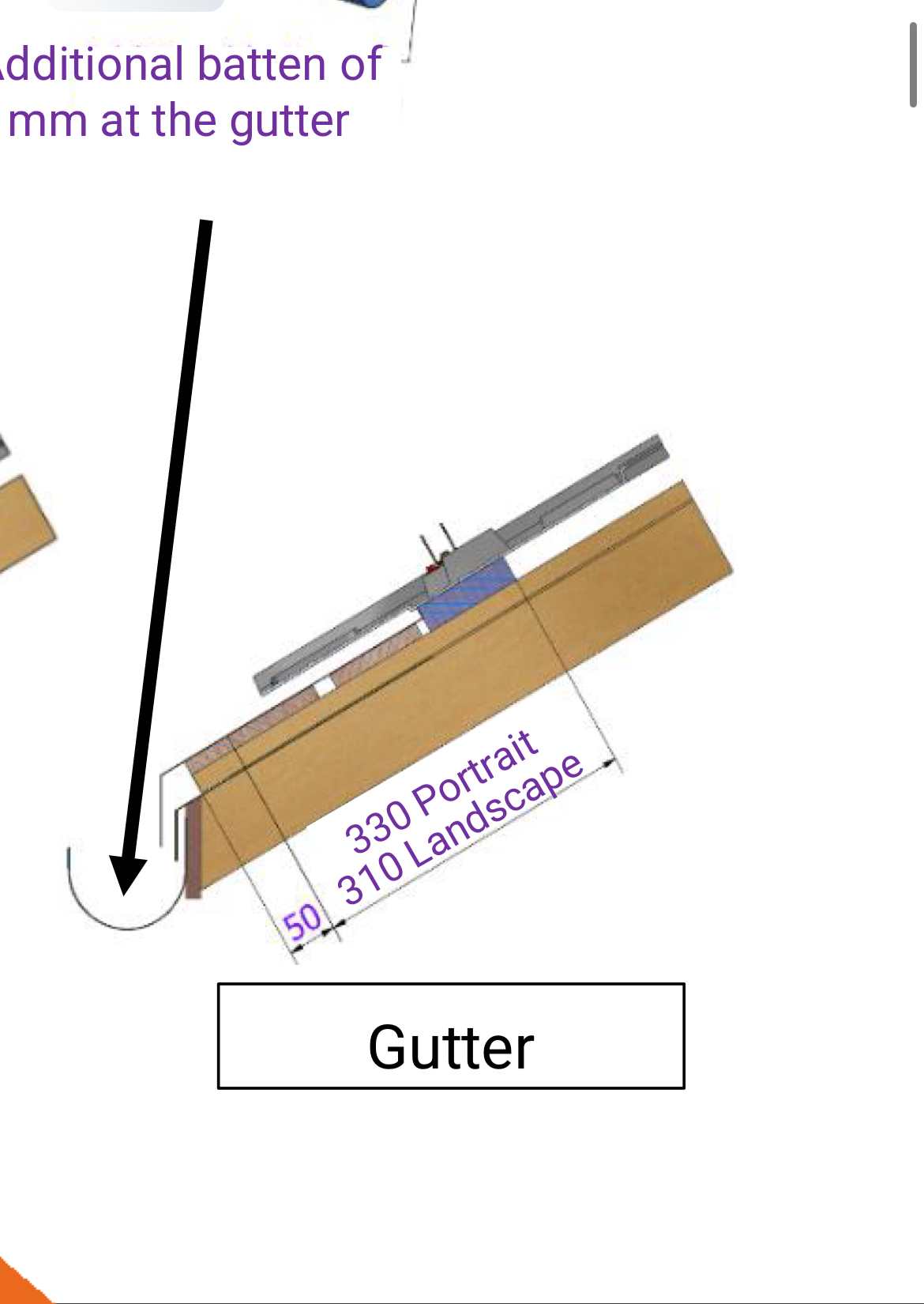

https://www.screwfix.com/p/felt-support-tray-5-pack/36622?tc=OA5&gad_source=1&gbraid=0AAAAAD8IdPzgEcfCF_SZZDp8-alGqZ-b8&gclid=Cj0KCQjwt4a2BhD6ARIsALgH7DpeOwsWCIBweiO47Ge4dCTasY_lGPJ6KSErzIq2sQxveSer3WhYQtUaAqBnEALw_wcB&gclsrc=aw.ds#product_additional_details_container Like this? I’ve already got the drip flashing (ubiflex), so I could use this in conjunction with the eaves support tray.
Hi all I’m about to fit the PV panels to the roof and have been studying the detail where the GSE system meets the gutter (there won’t be any tiles below the solar array). The GSE drawings show the flashing at the bottom running straight into the gutter, however my roof and most roofs have the fascia set higher than the rafter tails to kick the bottom tile up. This will inevitably leave a ‘trough’ at the bottom - although perhaps this is how it always is with just the membrane? Doesn’t seem right to me. Do I fit a sloped batten to kick up the drip flashing (so it’s properly supported over its full length) - seems a ball ache. Or do I adjust the height of the fascia - though this could be problematic as there are tiles either side of the array. Anyone fitted all the way to the gutter before? Thanks
