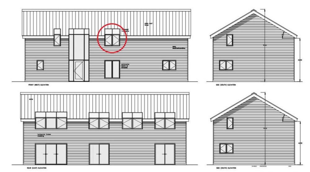

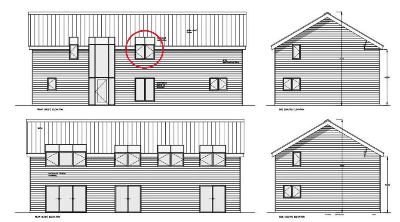

Maybe copy some elements (proportions etc) of the rear elevation, which looks to me quite contemporary, to the front elevation - which looks to me quite 1940s/50s? Maybe your architect wanted the front to blend in with the older houses in the street? This is, of course, a perfectly reasonable question to ask your architect.
