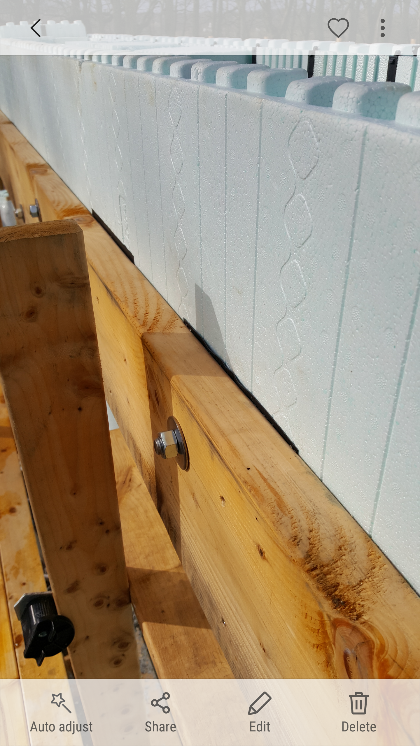

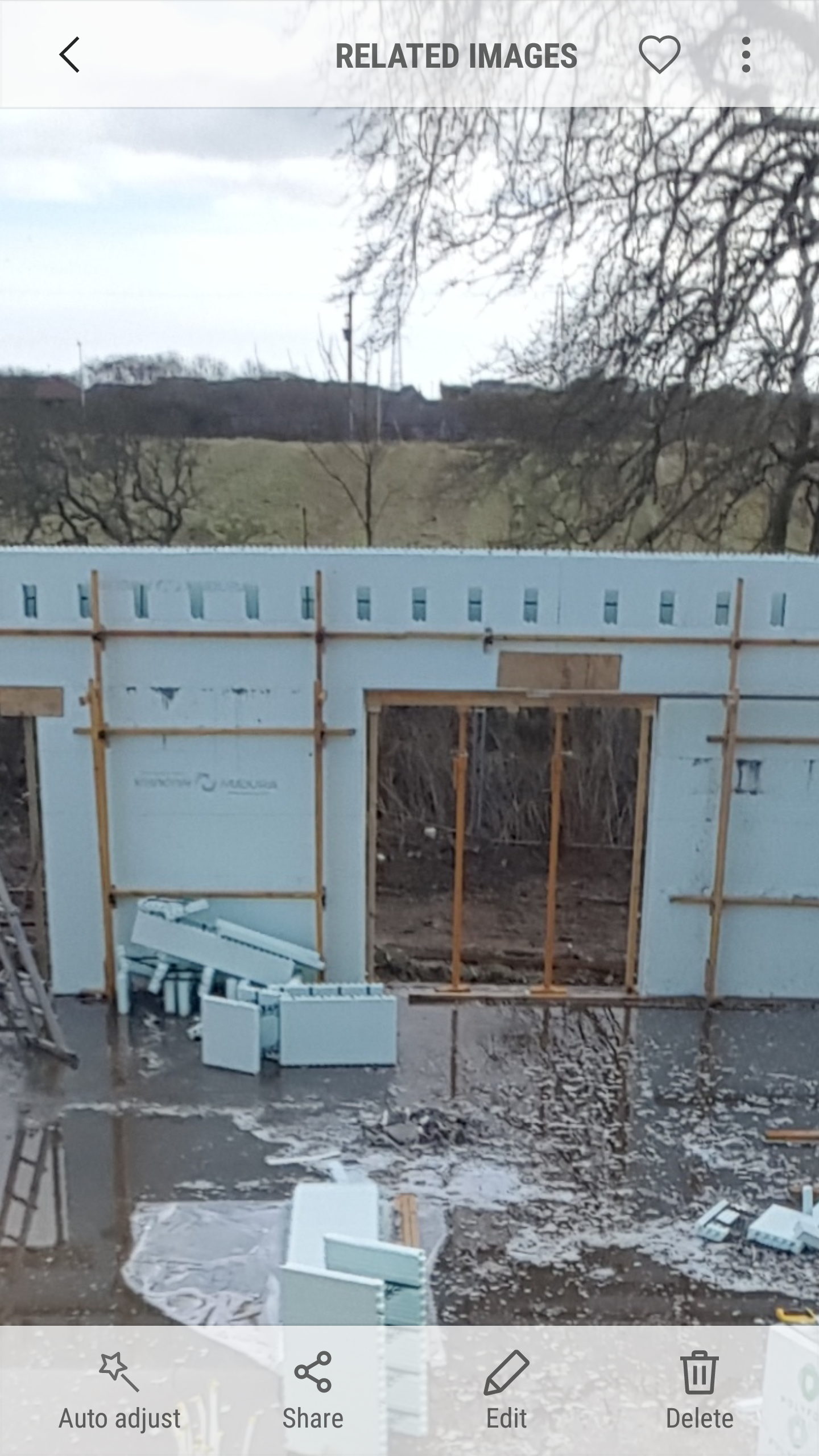

no we cut the icf and placed the rim beam before the pour, the middle photo is before pour. We also slid in cuttings of DPM between the the timber and the concrete before the pour. We have 220mm eps continuous on the outside of the concrete hopefully that will prevent condensation. Sitting the pozi joist on top chord saves on joist hangers.... every little helps
- 50 replies
We cast in a rim board with 12mm threaded bar at 400 centers then planning to hang the pozi joist off the top chord. We cut the icf so the concrete is providing a solid base for the rim board.
