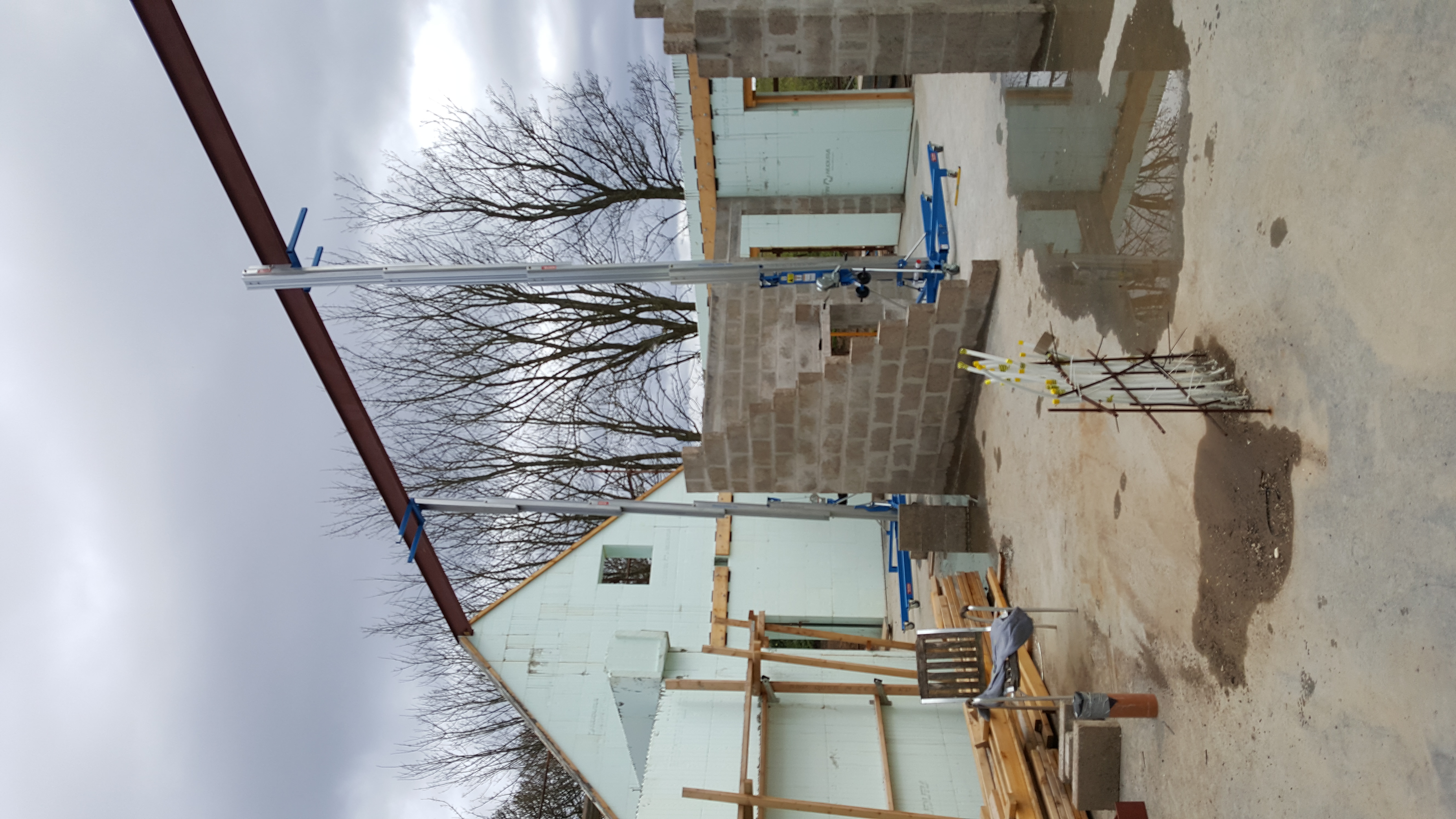

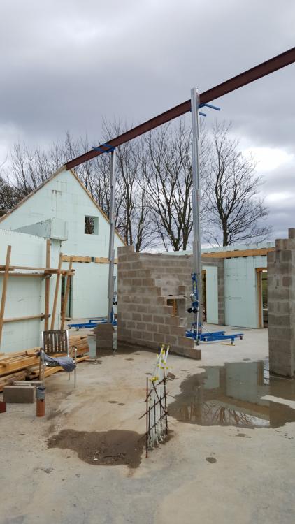

@PeterW Just over 600kg. The genie lifts made life very easy but not as easy as your way!
To be honest, I prefer working with steel than timber. Just finished the ridge beam so we are on a roll with metal!
