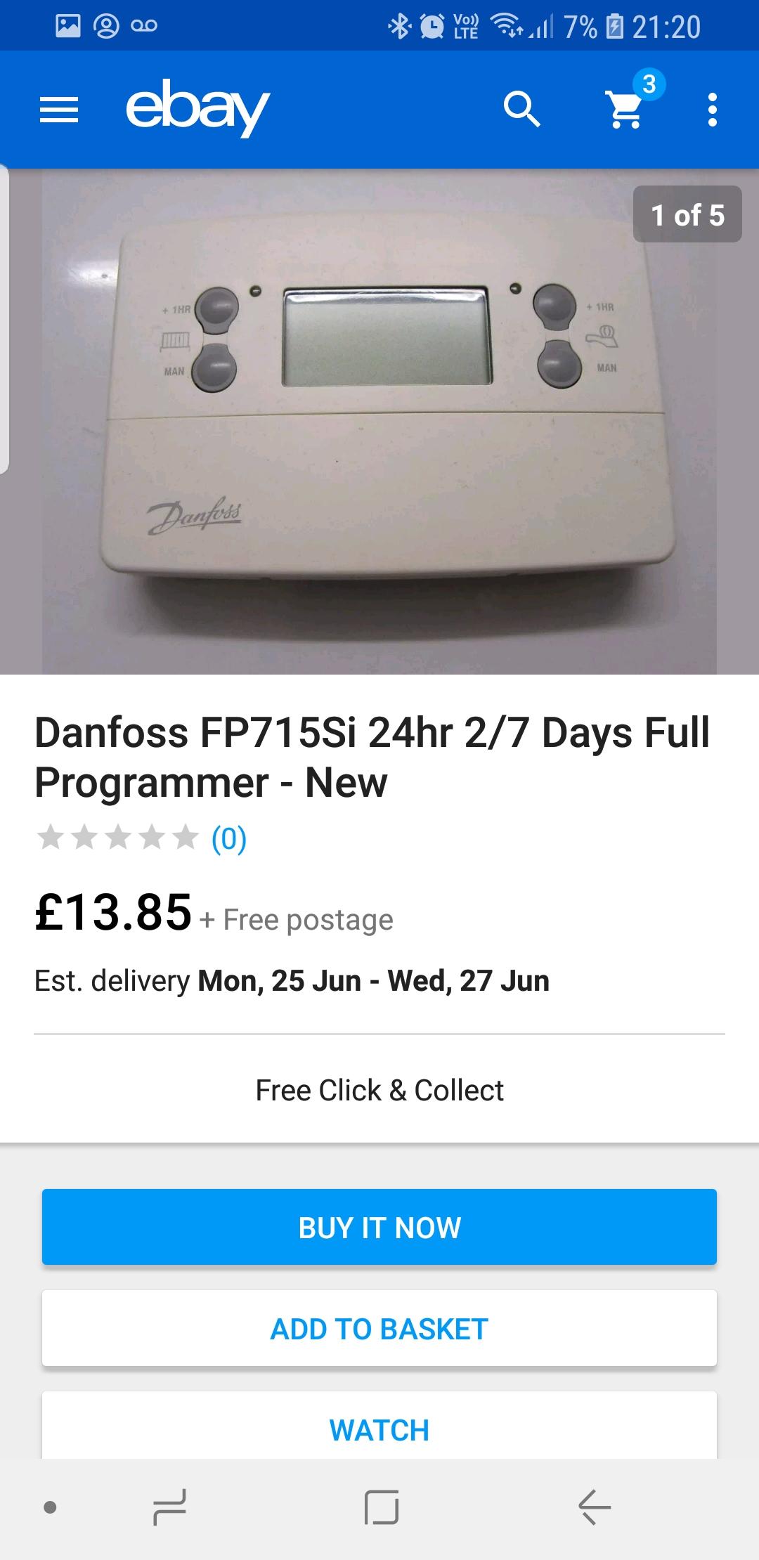

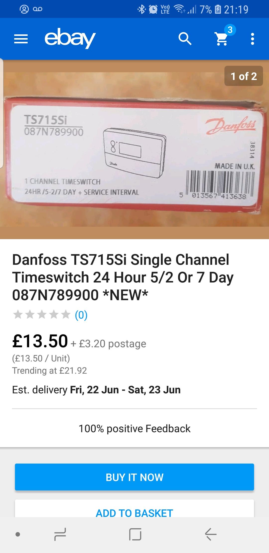

  19. Less than £30.
  20. We have only installed one 3 channel timer in the past due to cost. We usually used two clocks, a single channel and a twin channel clock when we needed 3 channels. EBay was a good source with both clocks could be picked up for less than £35 (for both) . I always liked danfoss times for no other reason than I found them easy to set up but Honeywell, Drayton where both good aswell.
