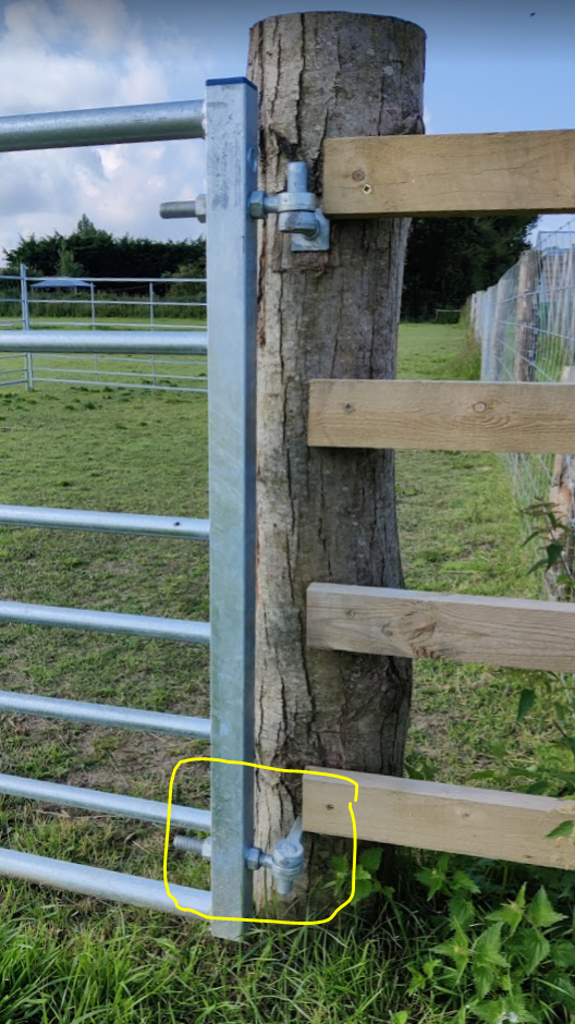

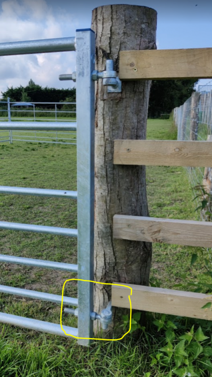

For this type of hinge, I always turn the lower hinge 180° so that it opposes the upper hinge. New gates don't last long if they can be easily lifted out. It means assembling the gate on to the hinges - you'd have to bolt the top band on to the gate, with the gate already in position and the lower eye bolt assembled on to the hinge pivot. There are anti-lift brackets you can use, but this saves purchasing anything else. If you swap the nuts on the top band to ant-theft nuts, it makes it even more secure.
