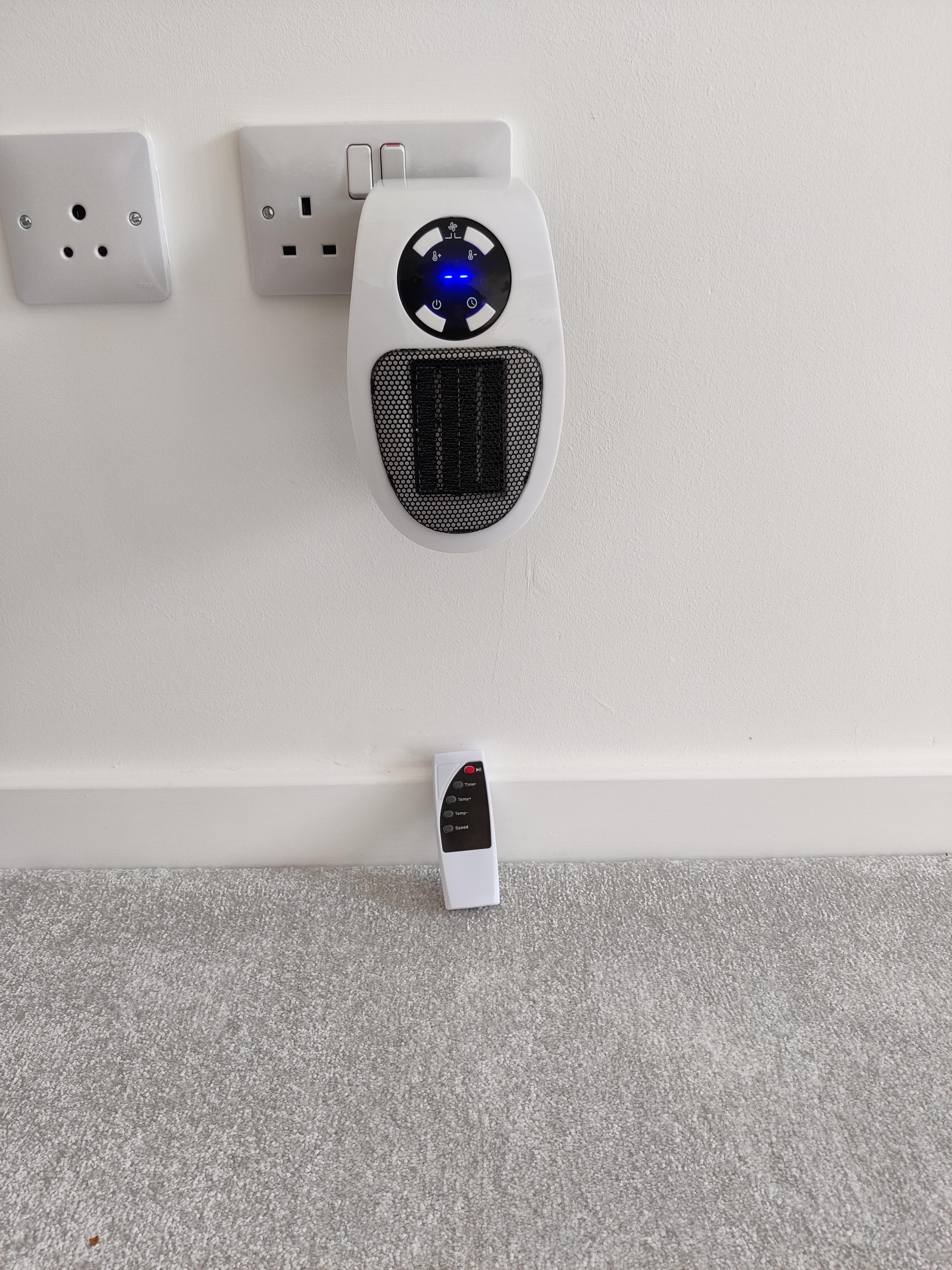

  18. Review Got the heater, from eBay and it comes with a remote control. A little larger than expected, but ok. You can set temperature and run down timer and change fan speed from low to high, you cannot operate without fan on. The heater will modulate the heater output, once it senses room is up to your pre set temperature. Fan is a little noisy for a bedroom, but if you just want to take the chill of a room, which what I was looking for it's fine. Once the room at an ok temperature then switch it off. Once you select off, a 60 second rundown timer starts to allow the unit cool down before it stops. For under £20 not bad
