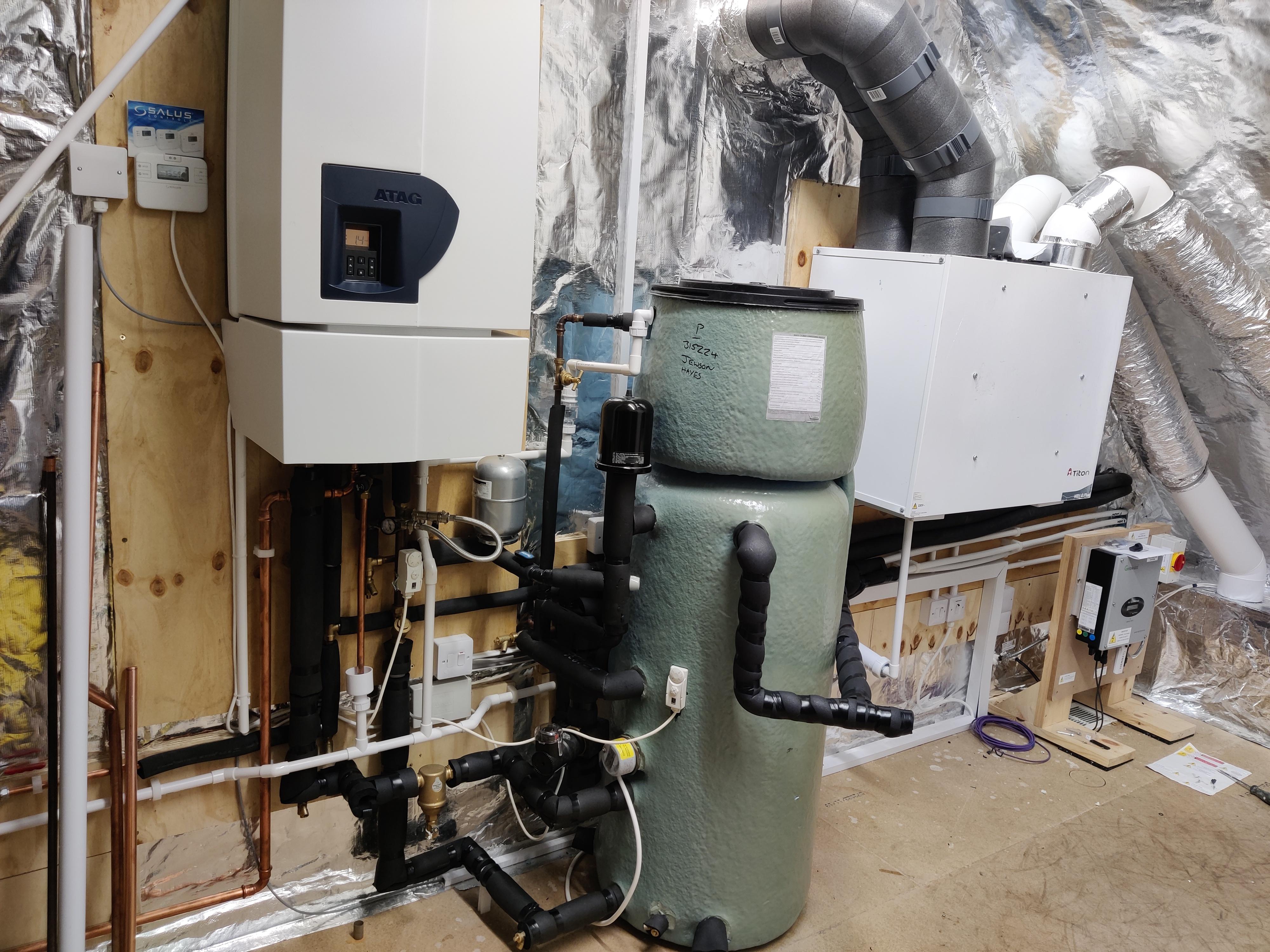

Tank choice for Combi, UFH and futureproofing
JohnMo replied to Olf's topic in Boilers & Hot Water Tanks
So in effect tops up the TS via DHW side of the combi in the process I have written that incorrectly. Should have said boiler runs for about 10mins per hour. That is the central heating runs for about 10 mins per hour. The secondary return, will pick up heat from the store if it's available, the boiler will fire the DHW as required. I only run the secondary return for an hour in the morning and the same at night. -
No its not a multi foil. That's the vapour control airtight layer. There is spray foam insulation inside the roof structure. Thermal losses not accessed, but at 40 degrees in the top half only isn't worth while assessing. The plastic cap on the top of cylinder is cool to touch. The water in the expansion tank, feels warm, but not hot. The room not much hotter than the rest of the house. The top of the room is being extracted to MVHR, so being recycled. The boiler came from Wolseley, it's an A325ECX, cost me £950 (including VAT,) including a standard flue. For one of the highest efficiency boiler you can get pretty good price. The main reason I chose it was it build out of the box to take solar preheated water.
I just heat the top half of the store, thermostat about half up store set to 45 degrees. I am using wood stove connection at top of store as my UFH take off
Just commissioned a system quite similar to you are talking about. Combi boiler - Atag can take pre heated water Thermal store, DHW Coil feeding into combi Combi central heating circuit, heating TS via sealed coil at bottom of TS. Water within store connected to UFH pump and let down to 30 degrees via mixer at manifold. Thermal store temp set at 45 degrees. Boiler central heating flow temp is a 50 degree curve. The only difference is my immersion is connected to PV diverter. So what you want I cannot do, but you can. UFH pump is running when a thermostat has a heat demand, boiler only runs when the thermal store asks for heat. Summer Turn thermostat down in summer so there is always a call for heat, but ensure the central heating demand is switched off in summer, so thermal store is cold. UFH heating will circulate back to store - no need to reverse. Heat at top of store will be consumed by cold water passing through upper coil prior to being heated for DHW. But you need the separation of UFH and boiler, but running through coils within the tank gives you this
Gone west, the floor is engineered oak, thát is finished in grey wax. Close image attached. Things I would have done different 1. The walls from strip foundations to DPC, are done in cement blocks, I would do them in durisol blocks - not reliant on someone else and would have had a easier transition to the main walls. 2. Had the roof structure designed around Pozi rafters from day one. 3. We have electric towel rails, would chosen them, before the electrical contractors arrived, as two sockets ended up in the wrong place. 4. Simplified the front wall as all the corners were a real pain to build as just every block has to be cut. 5. I would get the architect to detail door and window thresholds. As this was a steep learning curve. 6. I changed the build method to Durisol block part way through the warrant process, this gave us a 4 month delay. Things I wouldn't change 1. Shopping around for materials, local building merchants are super expensive. Contractors don't really care how much they pay, as they passing the cost to you, plus a percentage. Most contractors had the material free issued from me. 2. Planning well ahead, purchasing PV, Boiler, thermal store, MVHR, at start of first lockdown in clearance sales Things I learned The house ends bigger than you think. Things take longer to do than you think. Be flexible with material and design choices
The cold water enters the combi via the TS DHW coil. The recirculation pump is on the cold side of the coil. Check valves force the recirculation return flow though the DHW coil and to the combi. The pump is the bit with the shiny plastic top, next to the immersion. Have tried lots of running curves and the 50 degree one is about as low as I can go. The pump runs for about 10mins every hour or so. The combi basically runs until the return flow is just about the same as delivery flow. -
