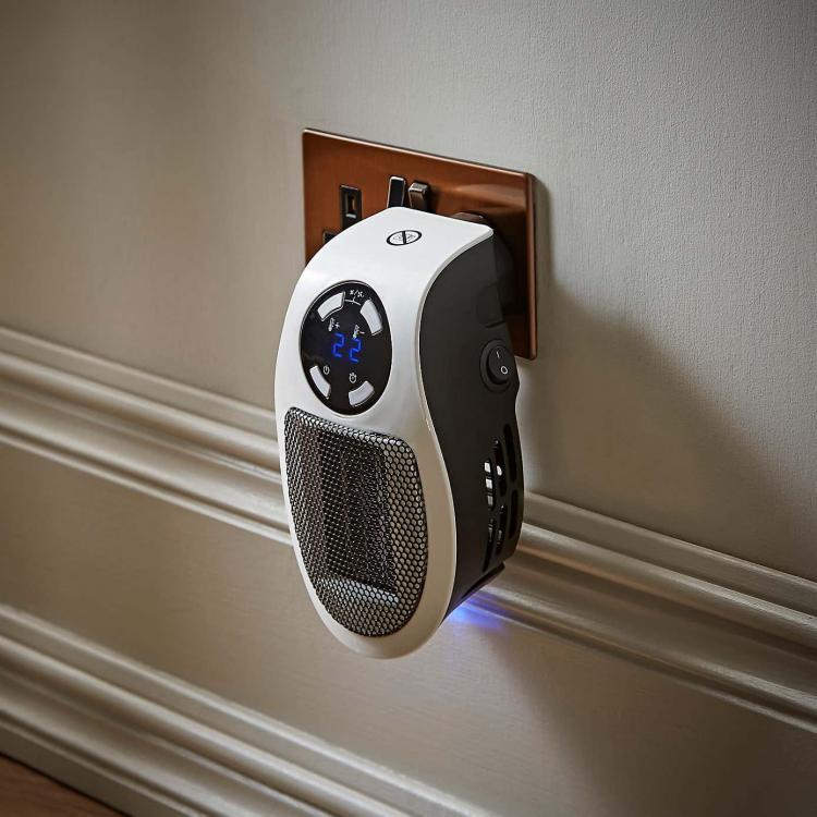

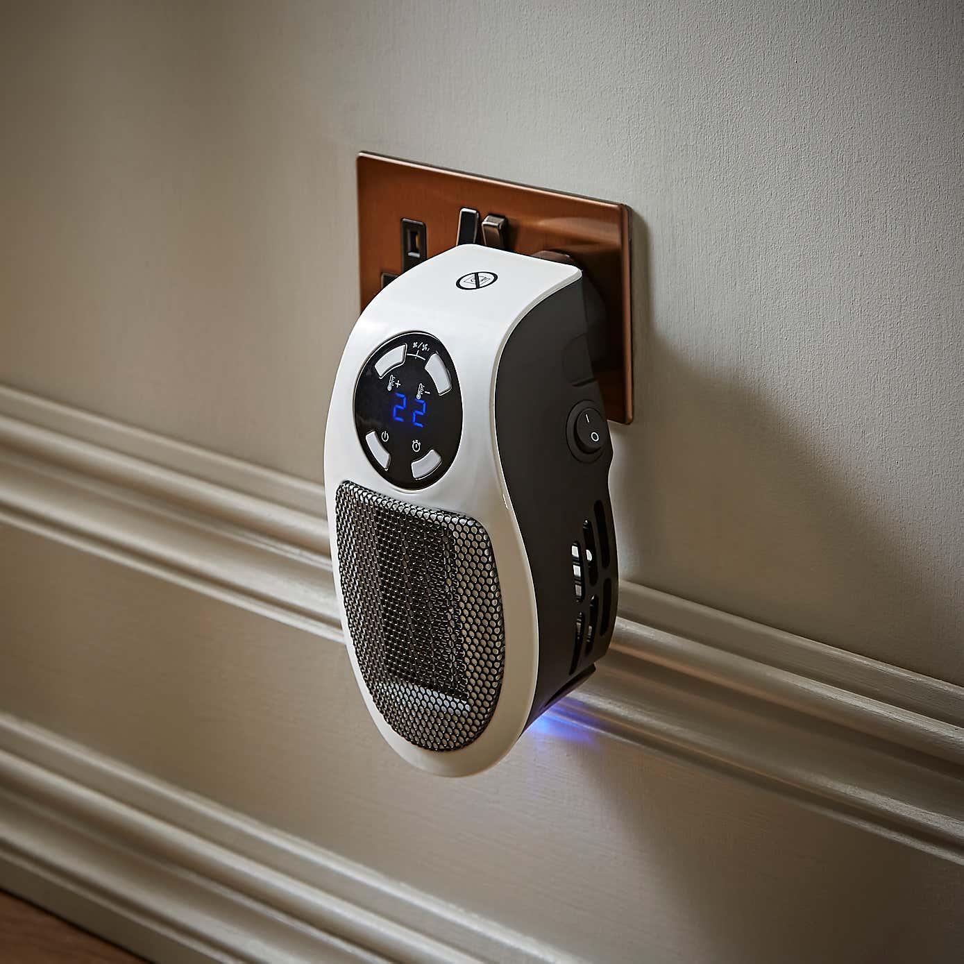

Just bought one similar, but with remote. Will also report back. https://www.ebay.co.uk/itm/Plug-In-Wall-Heater-500w-Mini-Electric-Space-Portable-Digital-Timer-Ceramic-Heat-/133901305662?mkcid=16&mkevt=1&_trksid=p2349624.m46890.l6249&mkrid=710-127635-2958-0
We have two issues 1. Changed the use of one the bedrooms and need some additional heat. 2. Room has wet underfloor heating running at low temperature, but we installed carpets with UFH underlay, but it insulated the concrete floor from room too much. Room temp ok for a bedroom, but not for sitting in for any length of time. Need a temporary heat source as room will revert back to a bedroom in a year or so. Have seen this, but not sure if a load of rubbish or good, only need about 300 to 400w. Anyone used or have an alternative temporary solution. Thanks https://www.dunelm.com/product/plug-in-ptc-heater-500w-1000190124?defaultSkuId=30737374&branchCode=0515&ds_c=Christmas_Heaters_[GOO-LIA+PSB-ELECTRICALS-HEATING]&gclid=CjwKCAjwz5iMBhAEEiwAMEAwGC68C9R_lEL5lStKsf9mfXkq8I79IUi_83djyk6HGVSVFfV2-66O3hoCm-oQAvD_BwE&gclsrc=aw.ds
