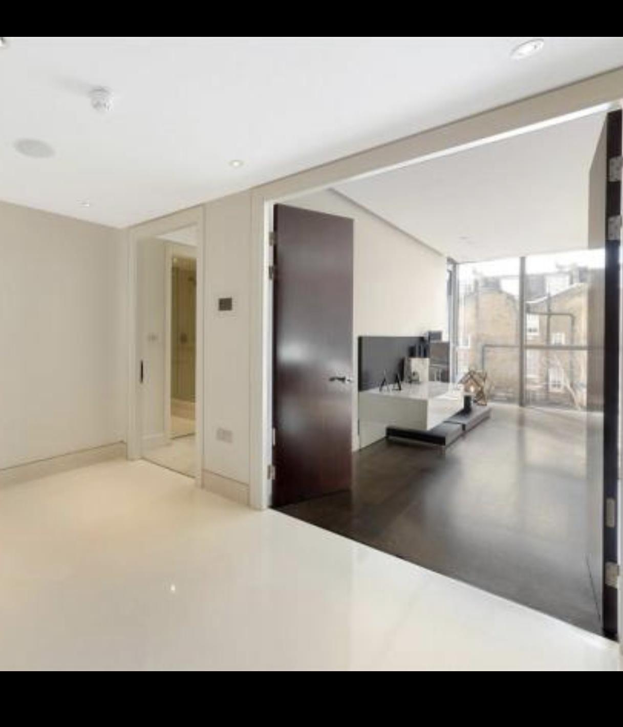

looking at the picture id say 6-8k in block bit more with nice brick outer skin. Timber frame was cheaper than that ?
