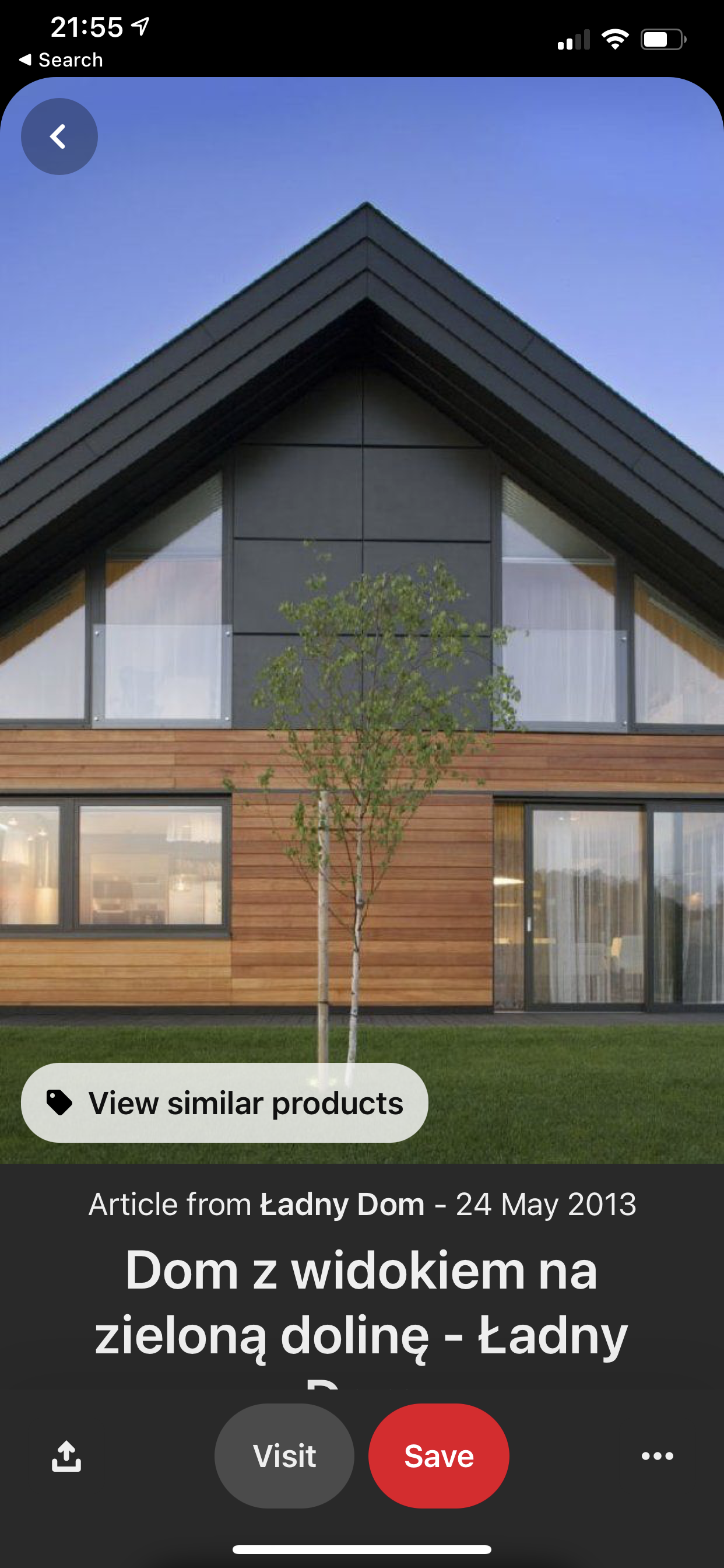

I’m sold on shadow line skirt as well as zero skirt just a line in some parts. I then saw an awesome gable detail on costrest which mimics shadow line on the whole side of the house. the issue to overcome is I want to mount the fascia (it will be hardwood probably 8x2 with a slot routered in it 1.5 m” from the top and sane bottom) flush to top of the tiles so you can’t see them. A normal gable ladder won’t work as the tile sits on top and would be visible. I’m thinking use a dry virge to weatherproof the roof and then mount the shadow fascia (it even sounds cool) over the top of it somehow. here’s a pic of similar
