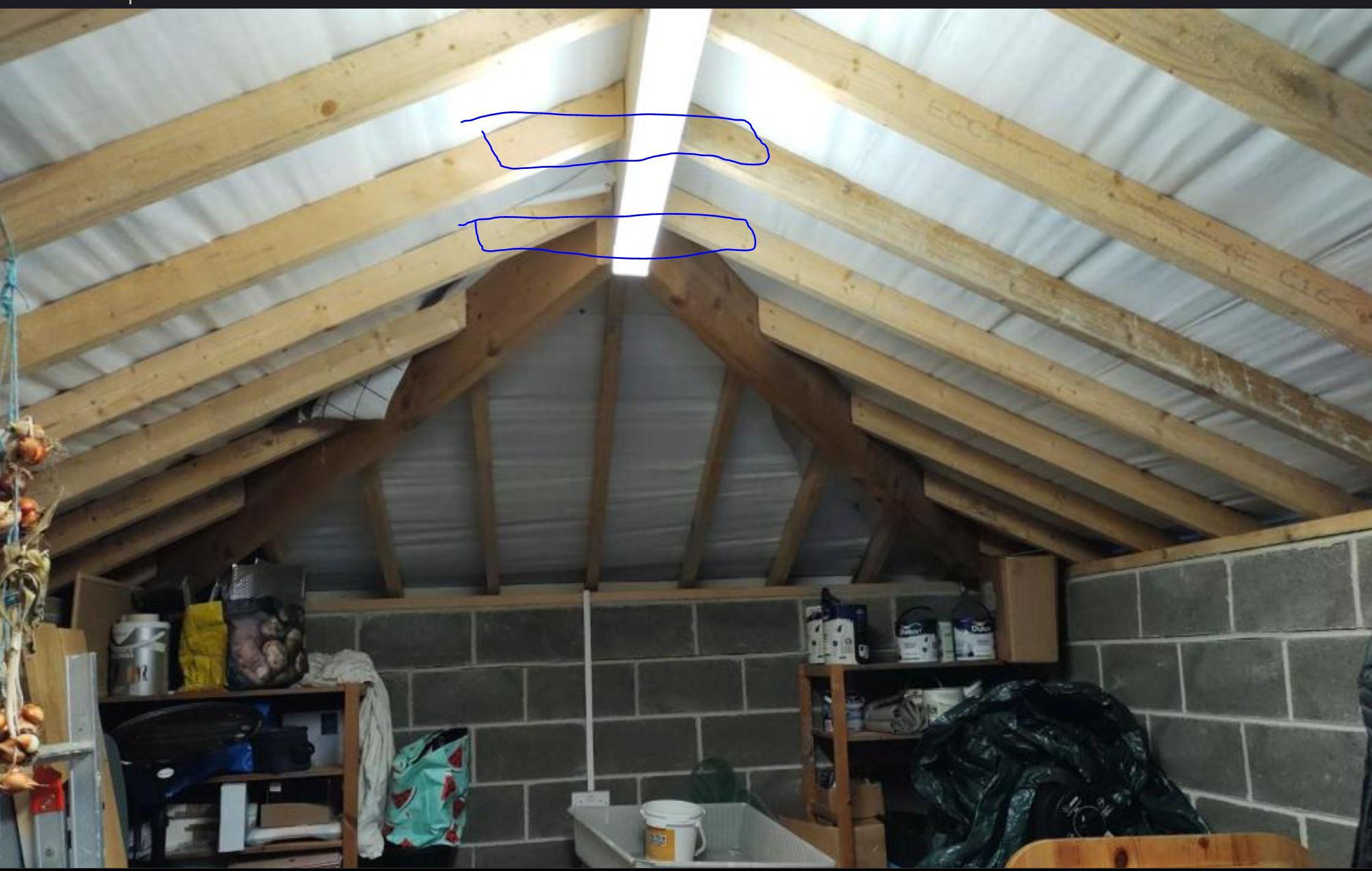

you dont have a warm roof by the looks, you have a traditional breathable cold roof. Tyvec supro is a breathable membrane and will not stop moisture moving into your insulation. You also don't need a vapour barrier with a cold roof as it doesn't really do anything apart from trap humidity inside the house.

just to be clear a traditional trussed cold roof does not require nor should have a VCL.

only ever use a 'hybrid roof' when its designed by a firm with PI insurance for you to claim against when it goes wrong. Personally would not ever use a VCL for a traditional cold roof, newly built houses are air tight enough without stopping any moisture from being able to escape. Trickle vents wont be enough.

there are only two ways to insulate a roof, warm and cold. cold roof is easiest as it needs no vapour barrier as moisture rising through it and dew forming inside it is vented as its open to outside air. warm roof on the other hand has to be sealed so moisture rising up from the house cannot get into it as once it does it cannot get out and you will have mould/rot/mushrooms growing. The main issue with a warm roof is having enough build height as they are a min of 150mm deep usually. obviously in an attic roof you wont have anything like this space available between the trusses so you have to go with a cold roof and copious amounts of ventilation above the insulation via the eaves and ridge.
