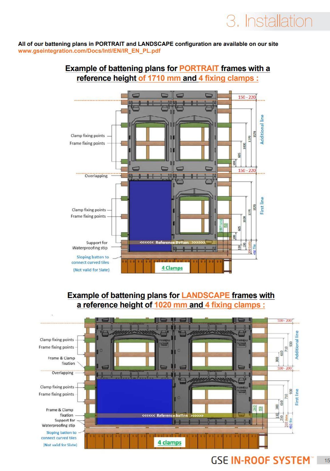

  14. the batten support spacing is in the manual, basically run your normal battens then add more to match the GSE fixing locations.

  16. you don't have to remove the trays, just take off the locking clips on the bottom row panels so you can prop up the end of the panels, you can leave the existing flashing if you like just pull out the tiles from underneath it and relocate them below the panels and redo the flashing. Its a couple hours work to get it right and avoid bodging with packers etc. If its any consolation when I did ours the panels had to come off completely as the sparky didnt tell me about the earth wire that has to be clamped to every panel so i feel your frustration!
  17. not all the trays just the bottom ones are wrong. You have almost a whole slate under the bottom this has to go and be replaced with the flashing/lead so it sits down. The sides are fine as you cut them into the metal flashing try same as the top. Just take out that whole bottom row sitting underneath the panels and replace with a flashing kit per the manual and it will be fine. Lead looks so much better than the crinkled stuff that comes in the kit.

  21. The bottom of the panels should not be in contact with the tiles as it will push them up when the panels are tightened down. it does show this clearly in the manual. strange they have given you the correct side flashing but not the top, if you look at page 29 there is a metal flash at the top onto which the sticky crap goes otherwise you would have to stick it directly onto the panels!
  22. The top shouldnt have sticky flashing. They come with a metal tray that sits on the top edge of the panels, the slates/tiles are then cut into to it flush.
  23. they have fitted the panels too low and the weight of them is kicking up the tiles. You should see the bottom flashing. Out of interest can you show a picture of the top as well. We had the same panels and tray, i really didnt like the sticky flashing and used lead instead. Page 17 of the manual shows the correct installation method. https://www.gseintegration.com/wp-content/uploads/2021/07/IR_EN_MI-v11.3-4.pdf
