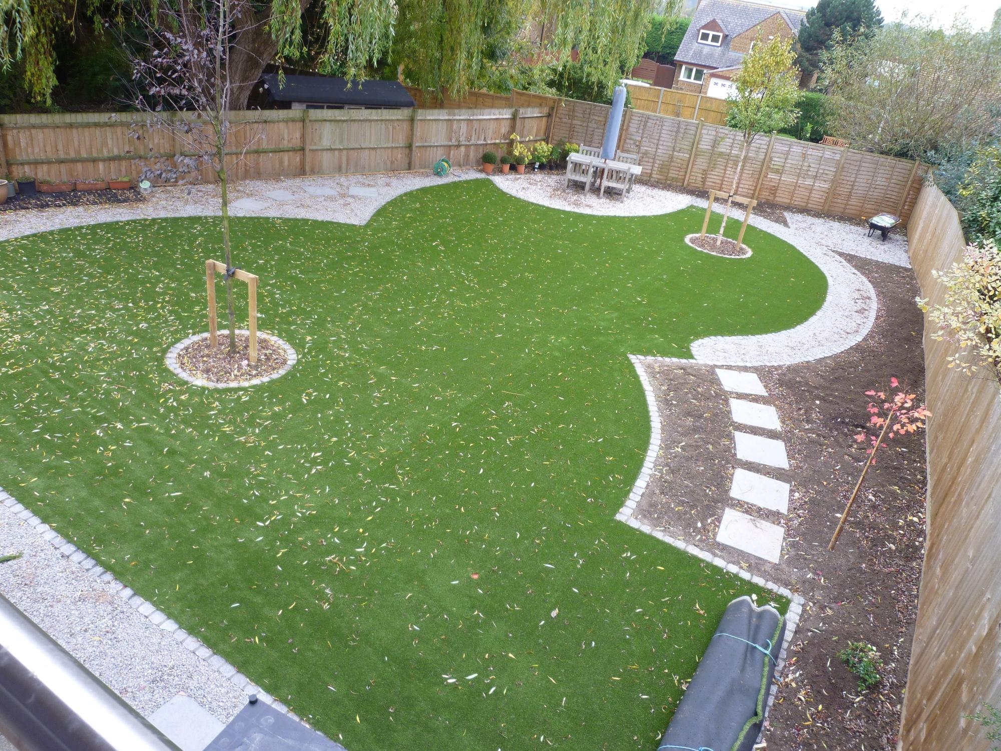

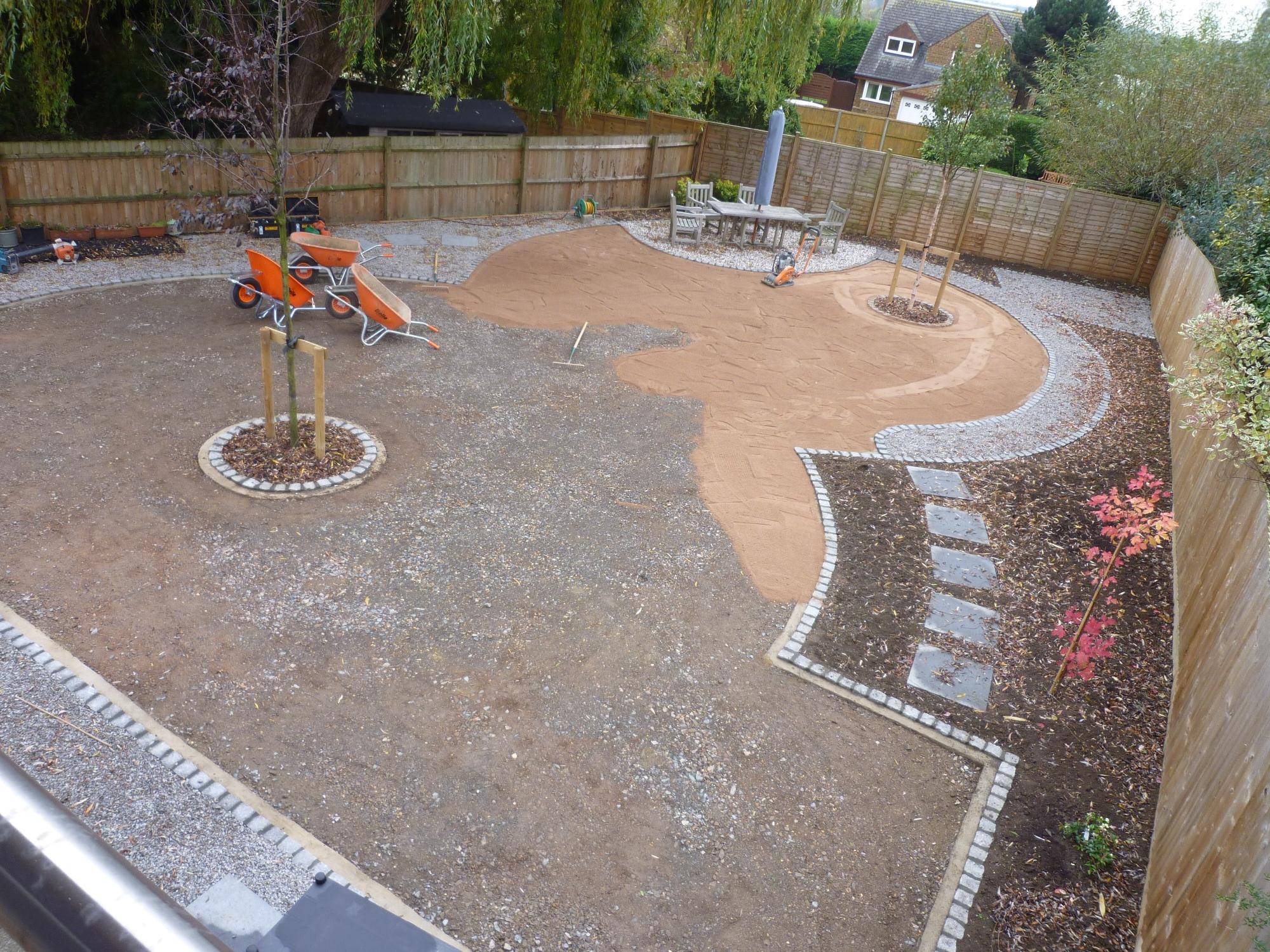

Artificial Grass Play Area ... advice needed
RandAbuild replied to Ferdinand's topic in Landscaping, Decking & Patios
Agree about the need for a solid base. We had a 90mm wide concrete/granite sett edge to ours and the grass was glued to that. Been excellent so far. Cutting the grass from the back is a lot easier than going through the tufts on the top! -
