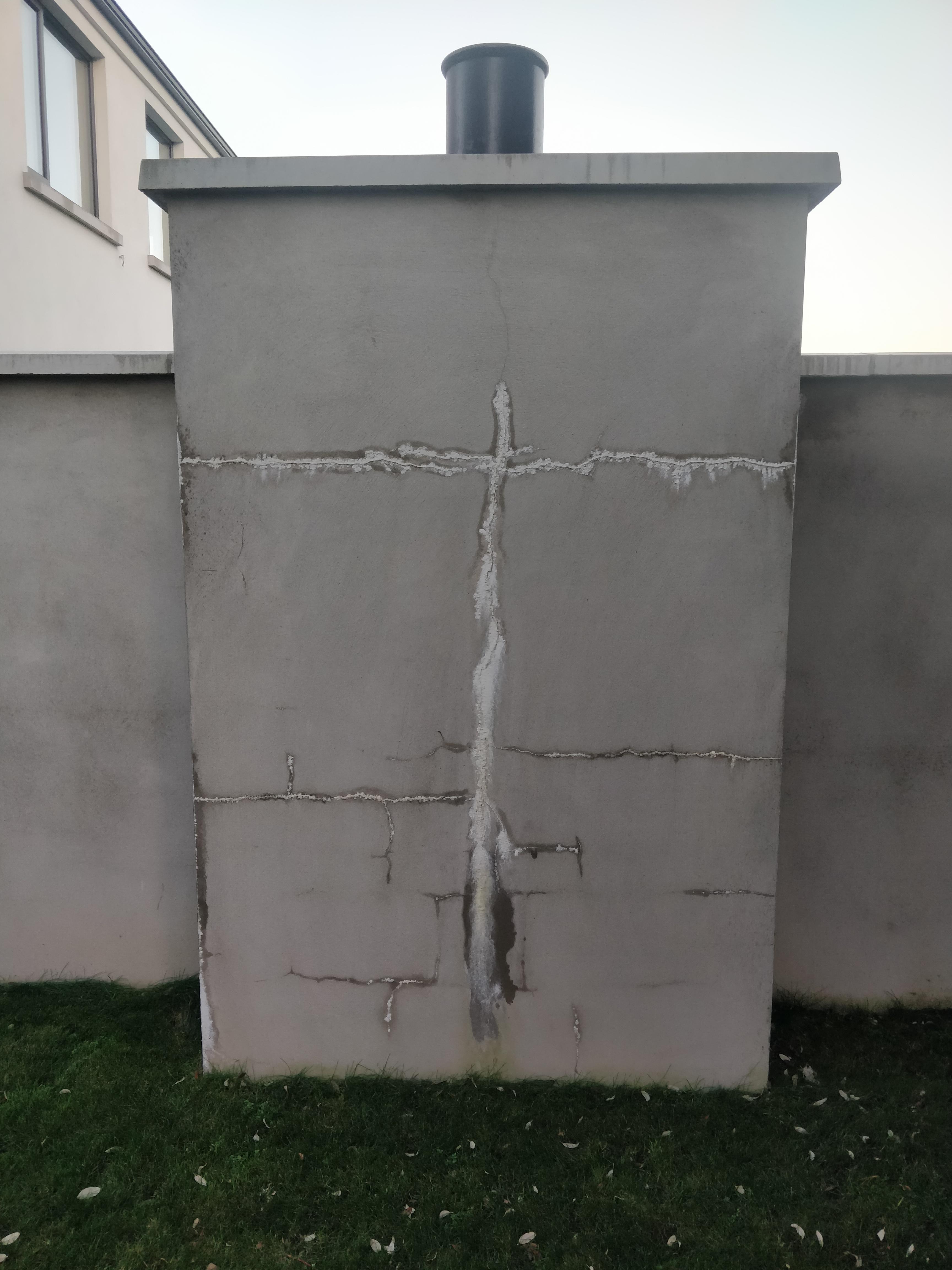

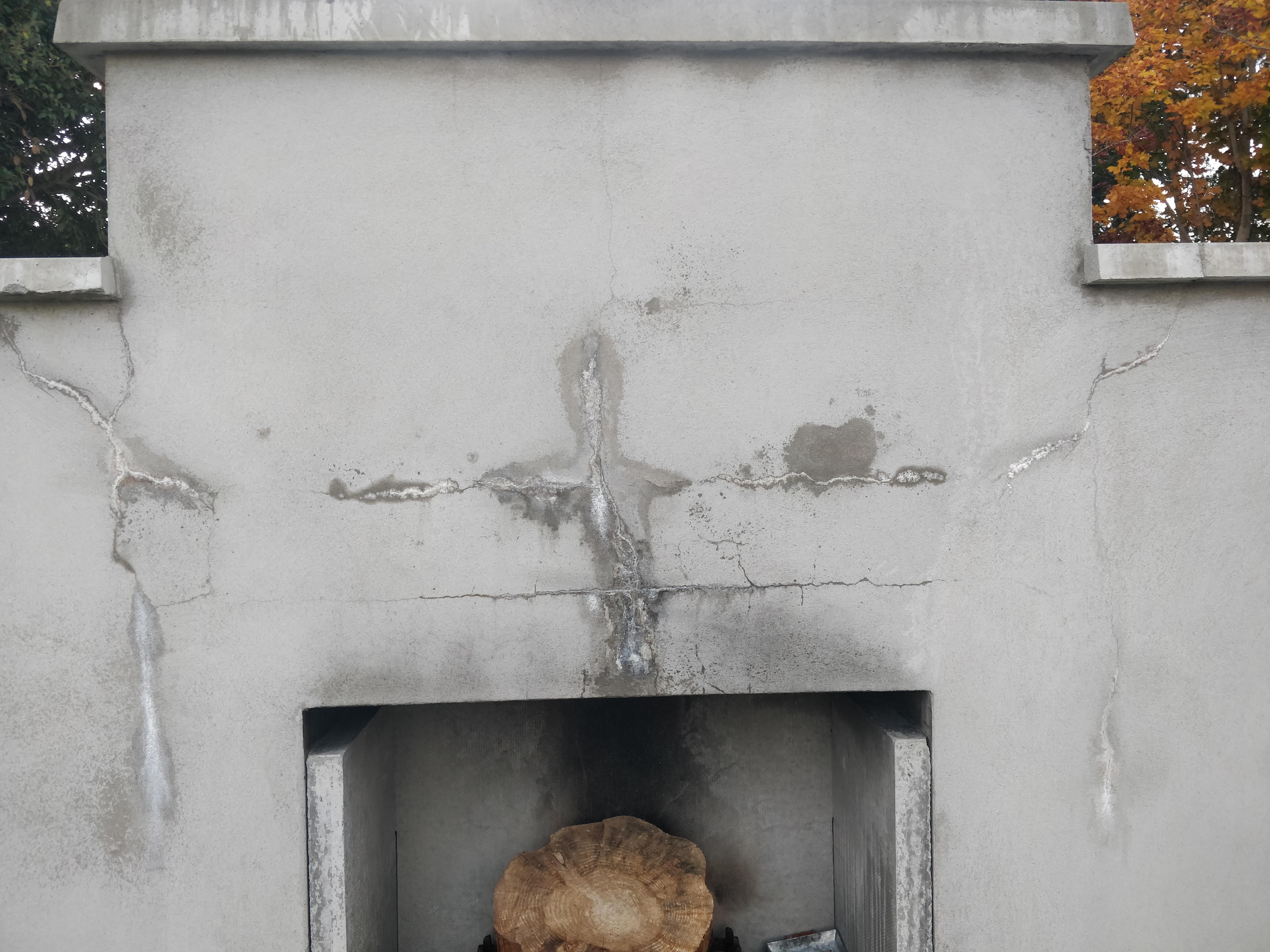

	Hi We've an outdoor fireplace which is great except for the fact that the plaster is leeching chemicals (efflorescence??) and looks awful. Can anyone tell me what's going on and suggest either a paint treatment or cladding ideas to cover up the bad look please? Thanks John

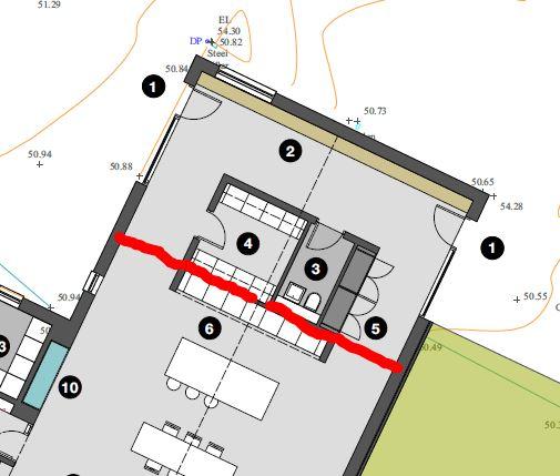

	Hi Tom Congratulations, your excitement is coming through loud & clear, well done. Very interesting design. It's just a thought, but the first thing that struck me was in relation to the open plan nature of your main room and the entrance hall. From a practical point of view, during colder days when someone opens either of your entrances you are likely to get a blast of cool air flowing all the way through that lovely big room. If it were me, I think I would introduce pocket doors imbedded into the wall that separates your kitchen from the Utility & WC. You can hide them if you want and also close off the hall area if you want.

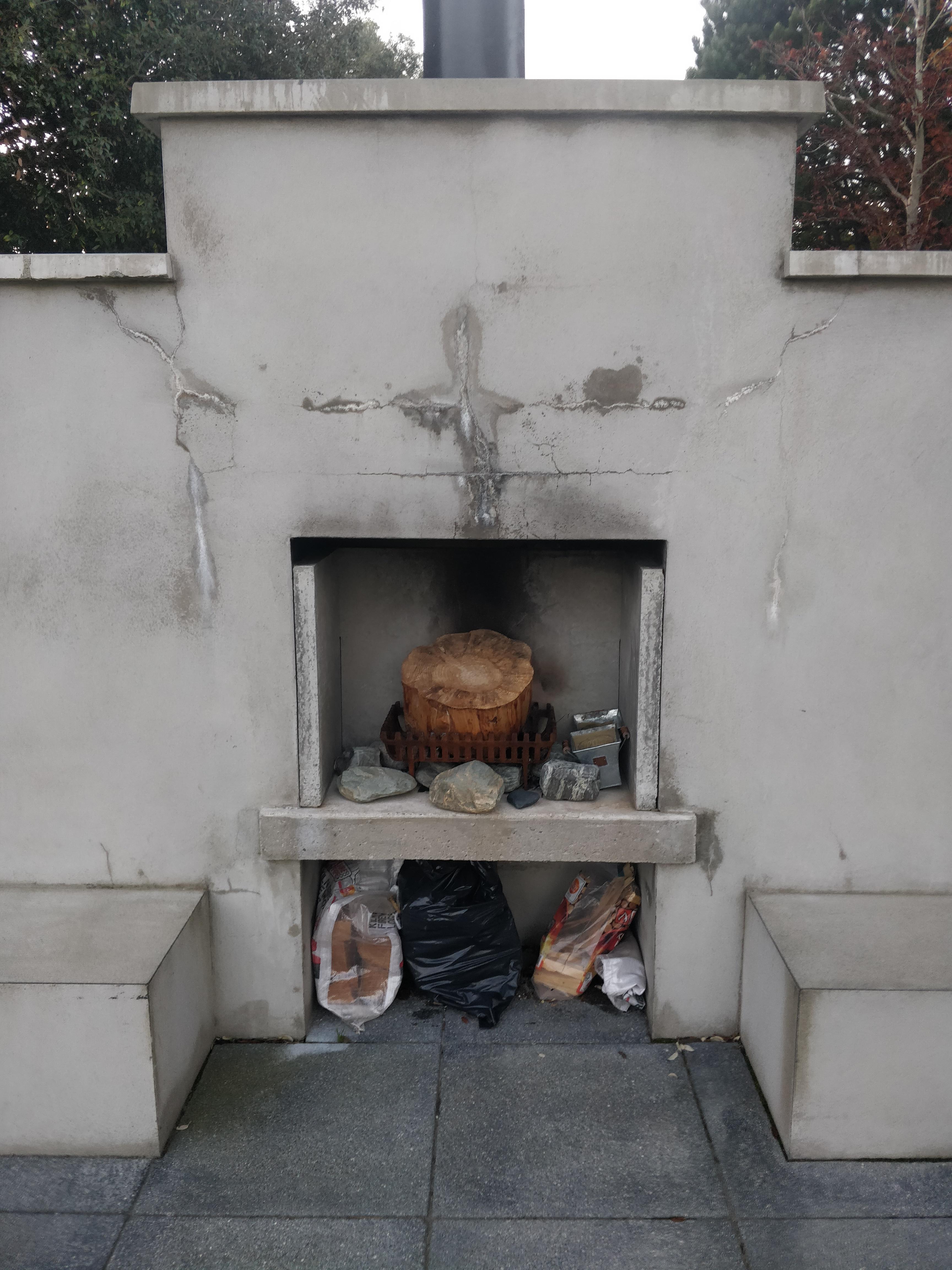

	Outdoor fireplace - wall protection advice needed...JohnW replied to JohnW's topic in Stoves, Fires & Fireplaces Thanks @SiBee, I've been advised that vermiculite absorbs moisture and is therefore not suitable for an outdoor fireplace. Thanks @PeterW, I like the sound of lining it with steel. I guess I could make small brackets that would give me the 25mm buffer zone off the wall on each side.
	Hi, We had an outdoor fireplace constructed and lit it for the 1st time last weekend. It was a roaring success (if you pardon the pun!). I'm concerned that the plastered walls won't stand the test of time and intensity of heat and was wondering if anyone could recommend a suitable material to line the internal walls to give it some protection from the heat. Thanks

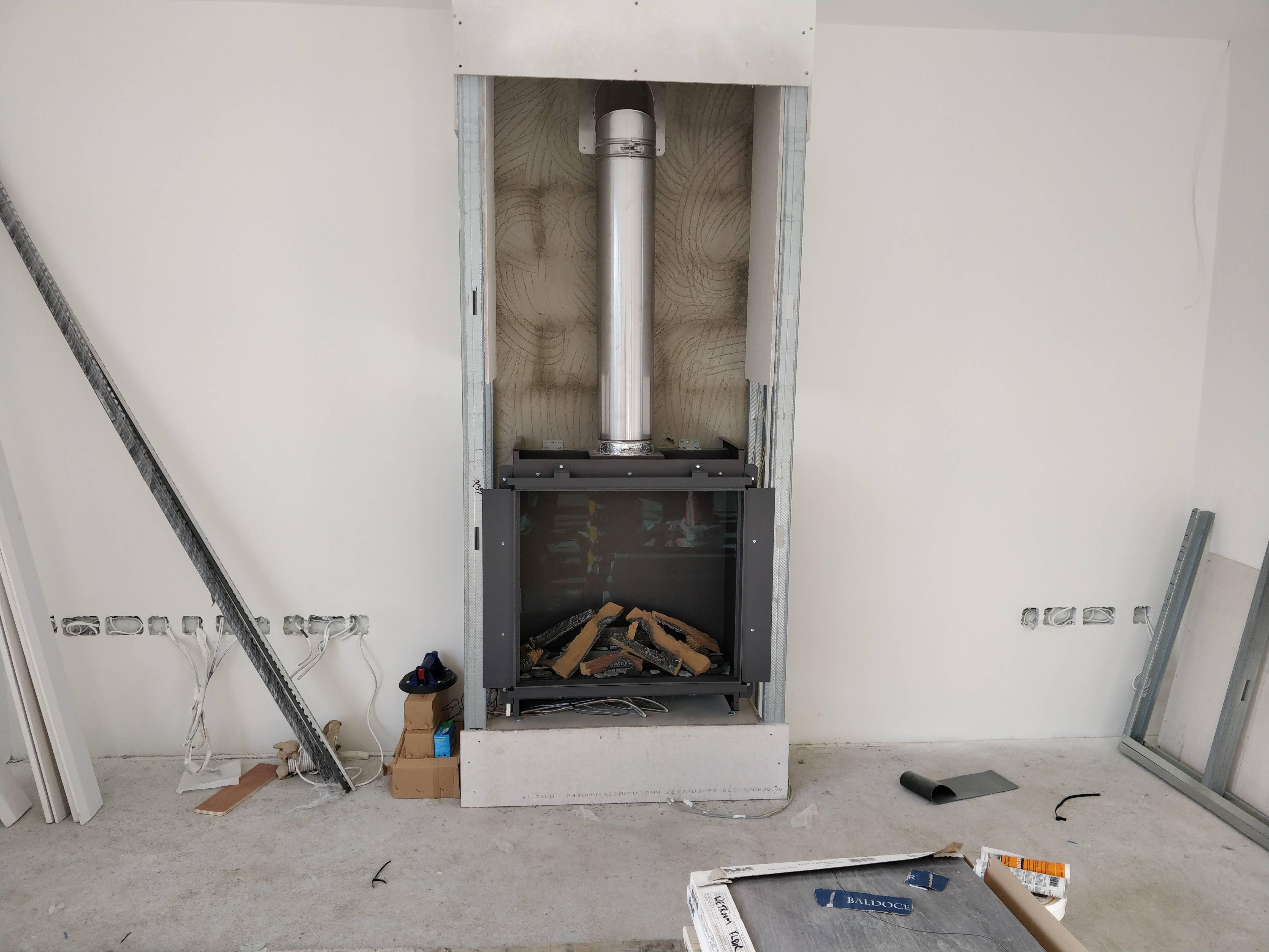

	Our room sealed Element 4 Modore 75h gas fire was installed yesterday and we're planning to board & skim the fake chimney breast to finish it similar to the photo below. The temperature from the front of the fire can get up to 200 degrees Celsius. Can anyone suggest how best to finish the opening so it won't crack or discolour around the edges please?

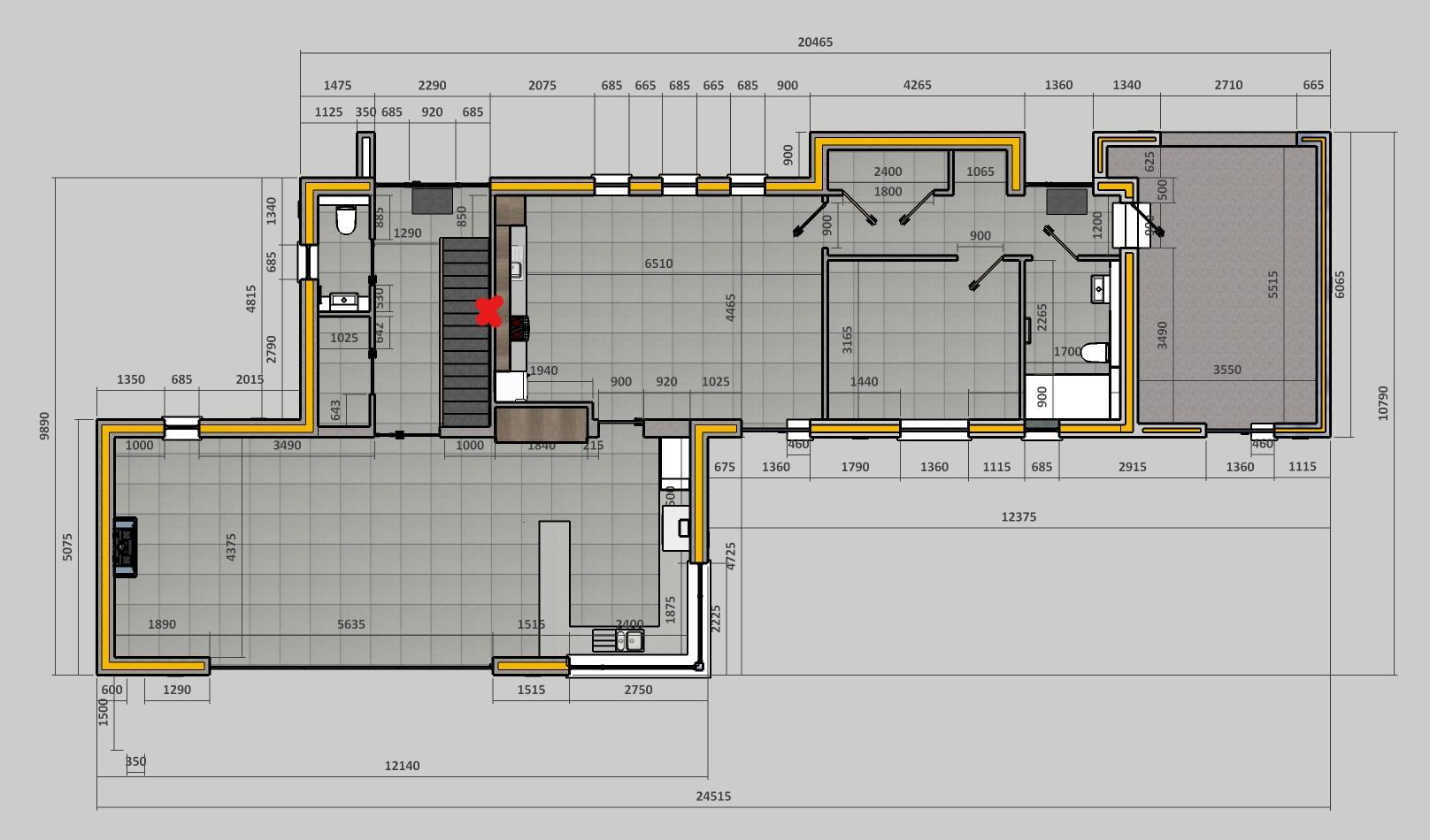

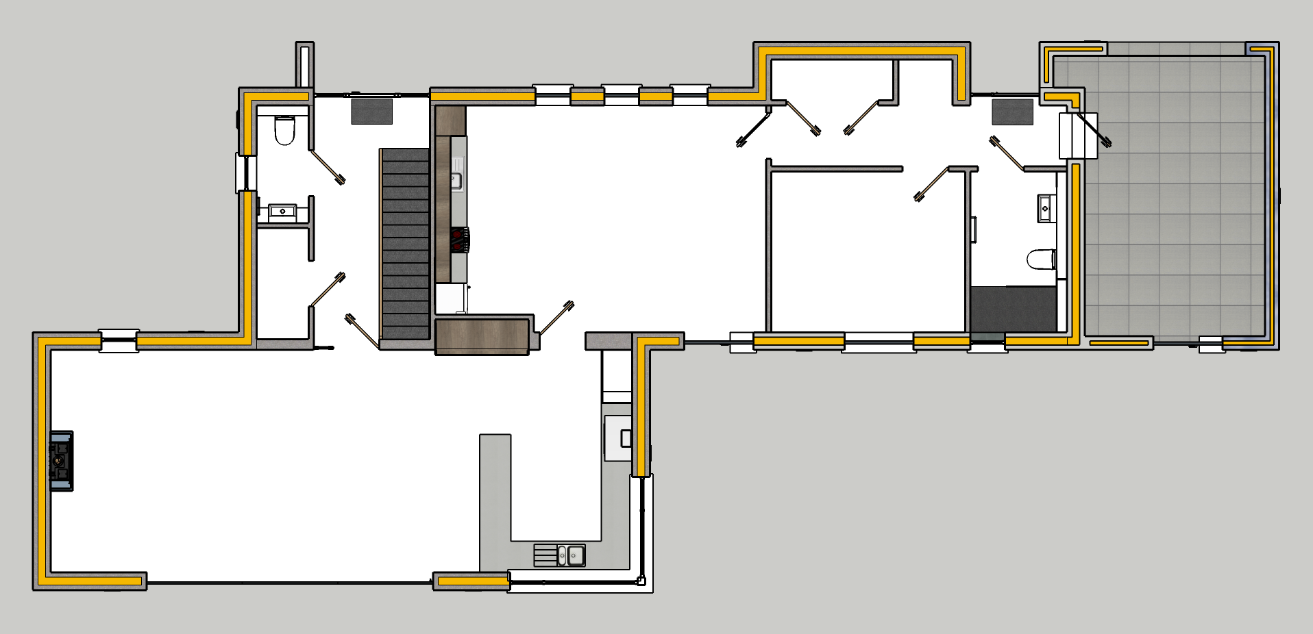

	I've been wrestling with Loopcad for sometime now and am loosing the will to live. I take 1 step forward only to follow it with 2 steps back!! Are there any kind souls out there who are proficient in using Loopcad who could help with my loop design for the ground floor and save me from tearing the rest of my hair out? I'm trying to use spiral counter-flow where possible. Here are 2 versions of the GF plan, one with dimensions and one without.

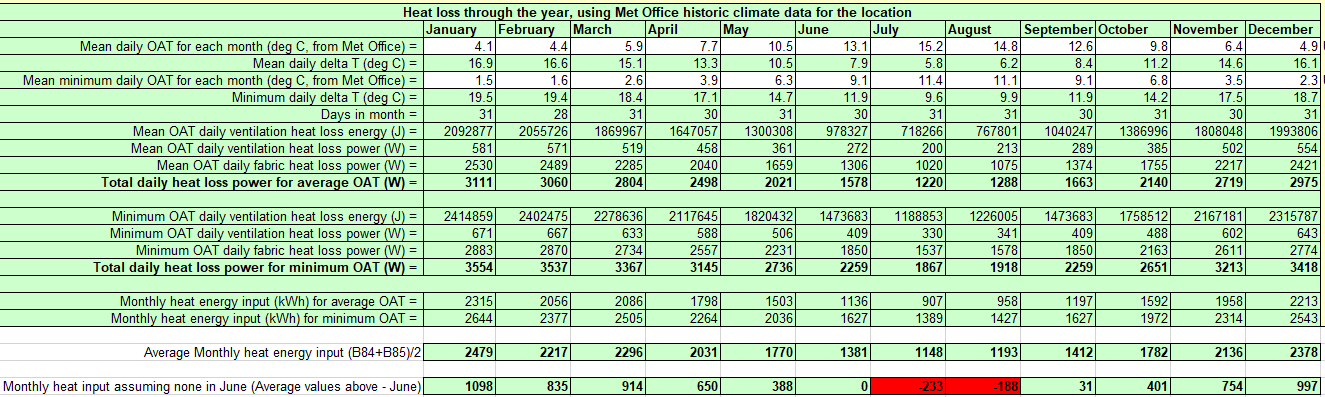

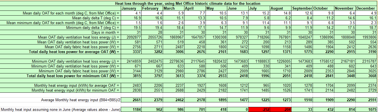

	Minimum U-Value for effective UFH on ground floor?JohnW replied to JohnW's topic in Heat Insulation Thanks @JSHarris - I've been playing with your fabulous spreadsheet (never thought I'd ever use those 2 words together) for some time now and it appears that changing the floor U-Value doesn't have a very big impact on the overall results. I tried Floor U-Values of 0.14, 0.18 and a Regs matching 0.25 for comparison and the results are shown below; What surprised me most, apart from the low values, was that the adjusted July & August figures appear to show the house over-heating more with a U-value of 0.25 than at 0.14 or 0.18. Can you confirm that this is what you would expect?
	I know the lower U-value I achieve for my ground floor the better but is there a maximum U-value beyond which under floor heating is not advisable?
	Thanks all for the explanations. I think I now understand that the P/A ratio has an impact on the overall U-Value and it sounds like potentially a negative impact in many cases. How does the P/A ratio take into consideration the fact that all our external walls have thermal blocks for the first 2 courses and 25mm insulation to mitigate horizontal thermal transfer? In my example, I know the P/A Ratio and the U-Value of the floor build-up but I would really like to know how the P/A Ratio reduced our overall floor U-Value from 0.17 to 0.14. It seems to me that there are many variables at play e.g. soil type, which could allow a more cynical person than me to achieve whatever result they want by simply tweaking those variables.

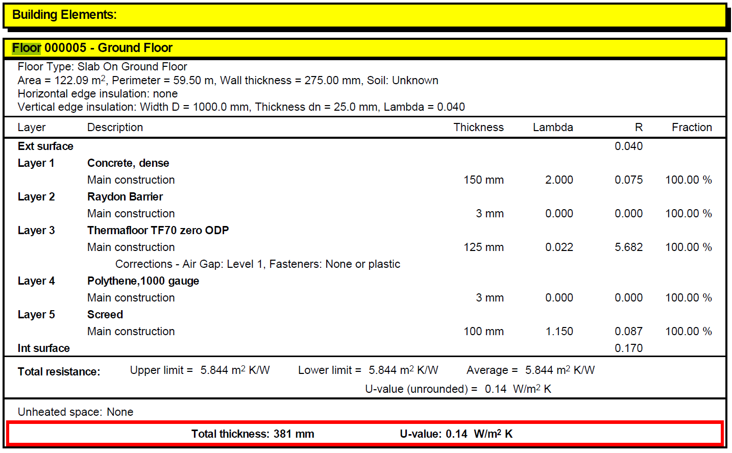

	Hi I think I understand how U-Values are calculated e.g. (Layer thickness) X Lambda = R in m2 K/W Add up all the R-values for each of the layers and 1/(Total R-Value) = U-Value in W/m2 K However if you look at the calculations from my "As-designed" SAP 2009 report below, the calculated Total R-Value = 5.844 m2 K/W and if you take the inverse of that the U-Value is 1/5.844 = 0.171 W/m2 K and not the 0.14 shown on the report below. Can anyone please explain how the 0.14 was achieved...what am I missing??? Thanks
