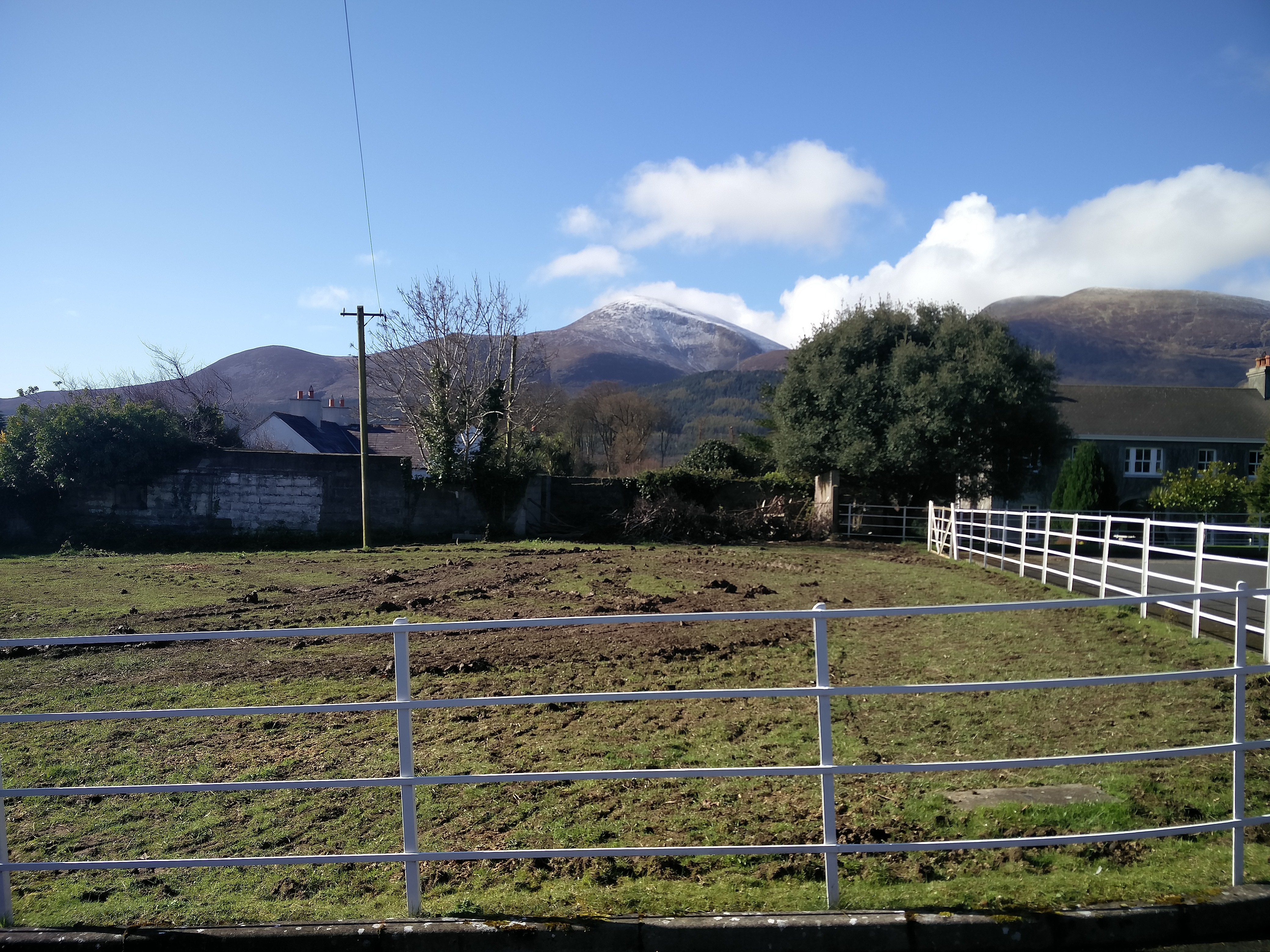

  5. Thanks @JamieM, yes hopefully 4.8m bi-fold doors opening out to a view of Slieve Donard.(see attached photo)
