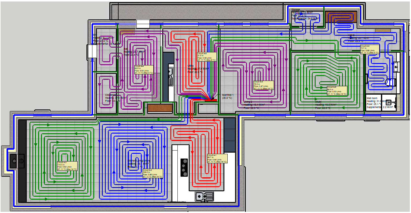

Loopcad trial expired and I haven't finished my UFH layout design
JohnW replied to JohnW's topic in Underfloor Heating
Thanks you all for the suggestions - looks like I need to find another PC -
