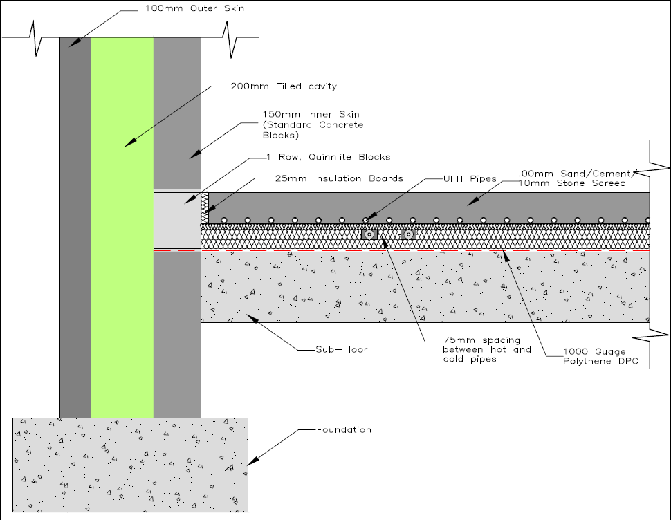

  15. In the scenario you paint above with the UFH pipes close to the top of the structural layer, would the structural layer not be deeper than 100mm and therefore a large percentage of the heat from the UFH pipes would transfer downwards and never make it to the surface where we need it?

  17. Thanks @PeterW, it's not dissimilar to what we have been advised to use. (See below - I should also point out that this image and all technical & design information contained within are the copyright of Reinco Insulation & Renewables consultant, Eric Davidson)
  18. Thanks @PeterW, I would appreciate a look at your sections
