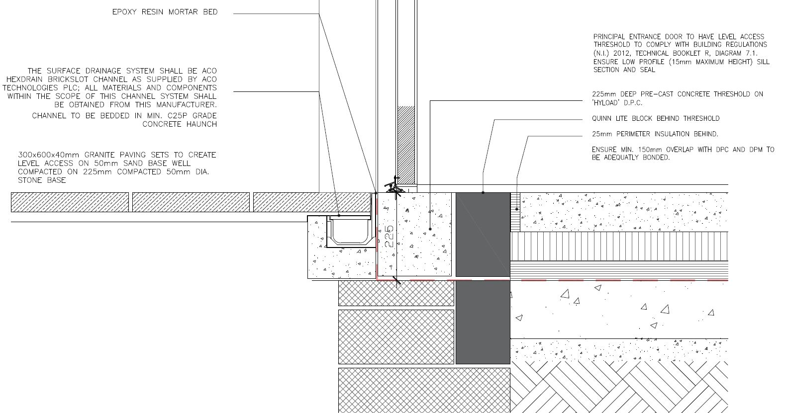

This door threshold detail provided by our Architect appears to have a major cold bridge in the form of the pre-cast concrete threshold. Can anyone suggest an amendment to the detail to remove/reduce the cold bridge? Thanks John
- 18 replies
- cold bridge
- door threshold
(and 1 more)
