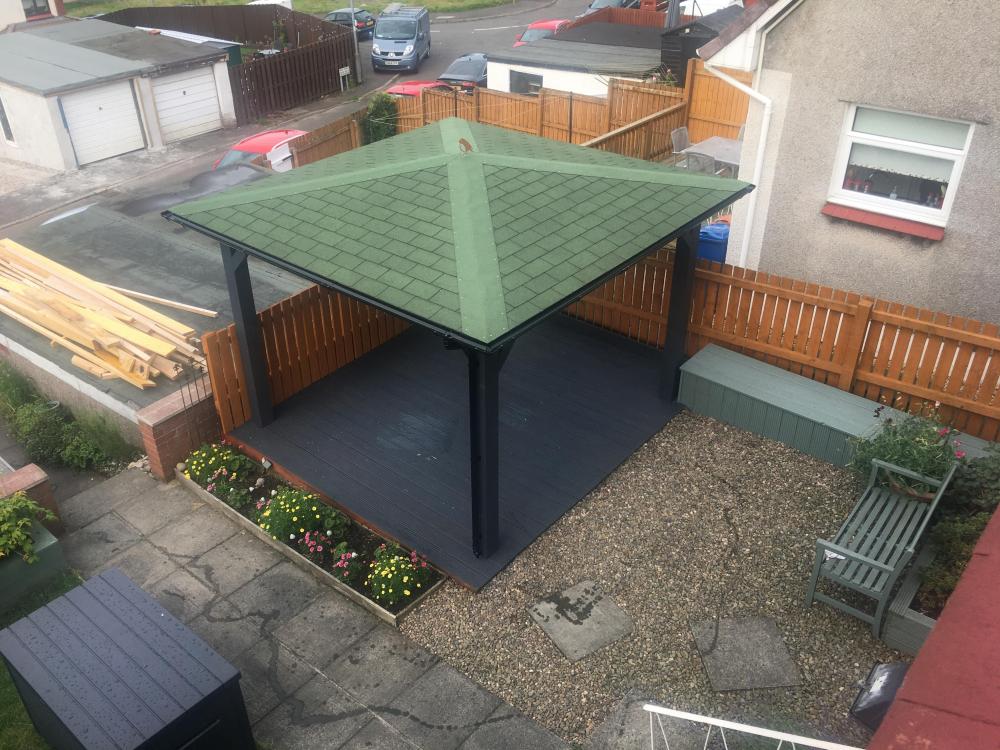

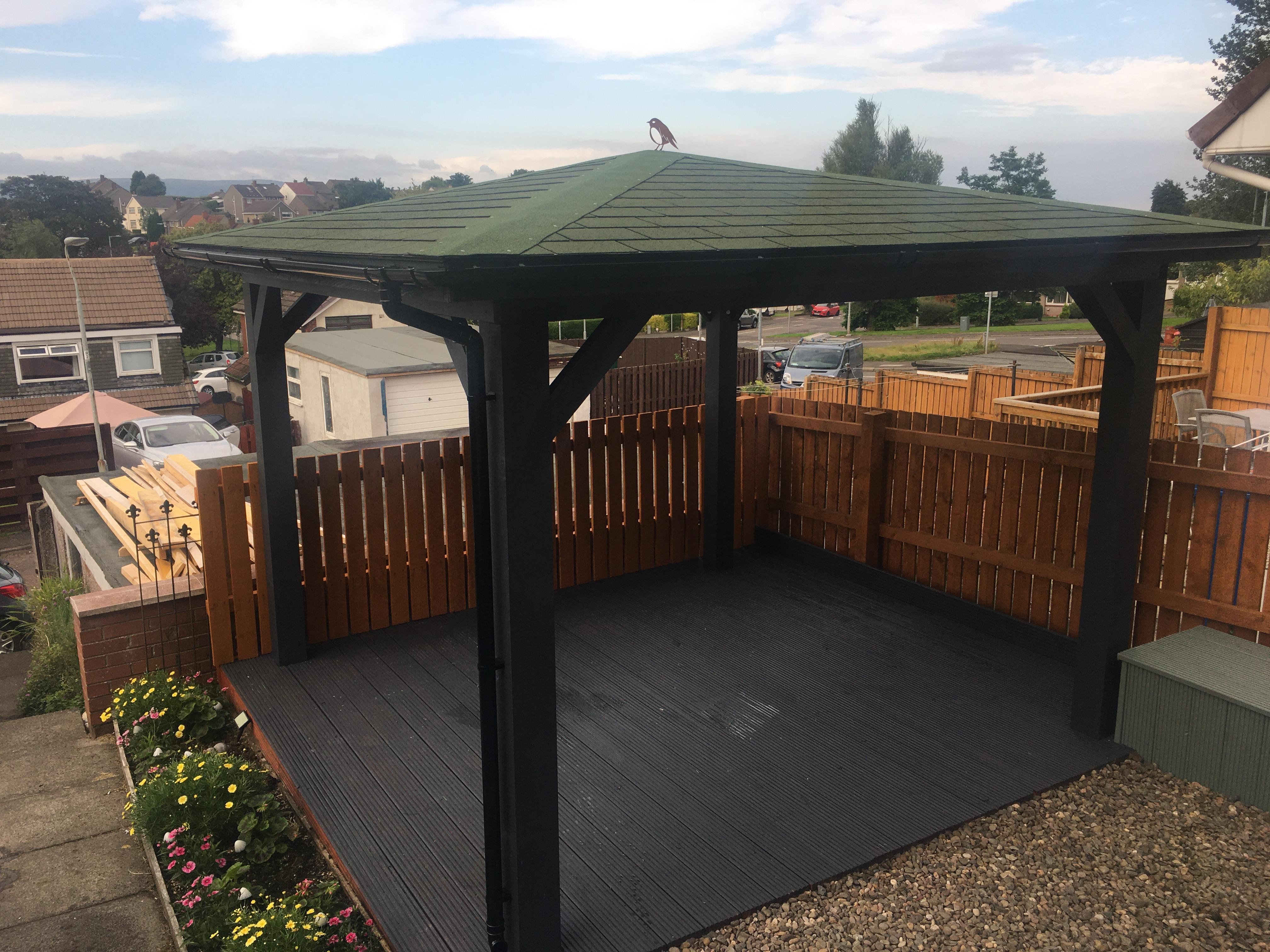

  3. Before During Finished! Spot the birdy Now just two more planters and a catio (google it!) to do and I might get my promise?

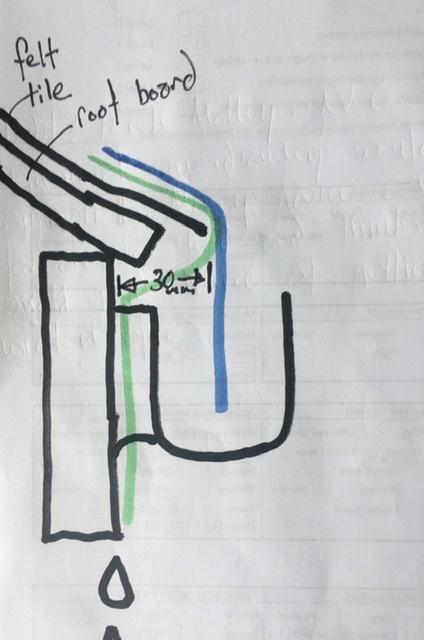

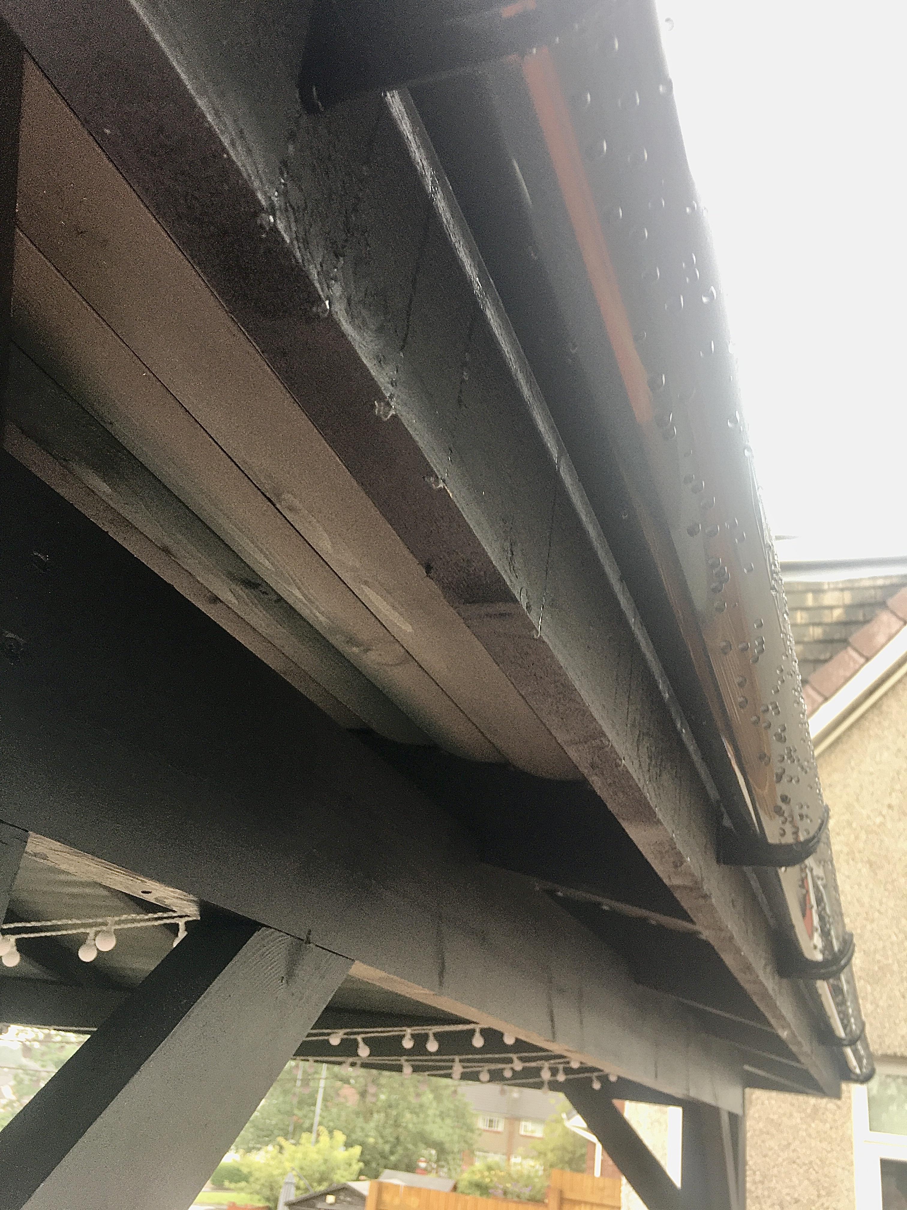

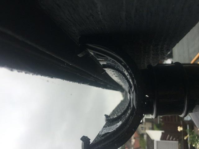

  8. So, almost finished the felt tiles (just need to get a final bit of trim for the apex) and got the gutter on.looks nice but today it rained and good news is the roof does not leak but sumfink is up with the gutter Profile of how it’s fitted The drips on the board the gutter is fixed to is the problem... Some water (most) is following the blue line but some is following the green line and dripping like fcuk

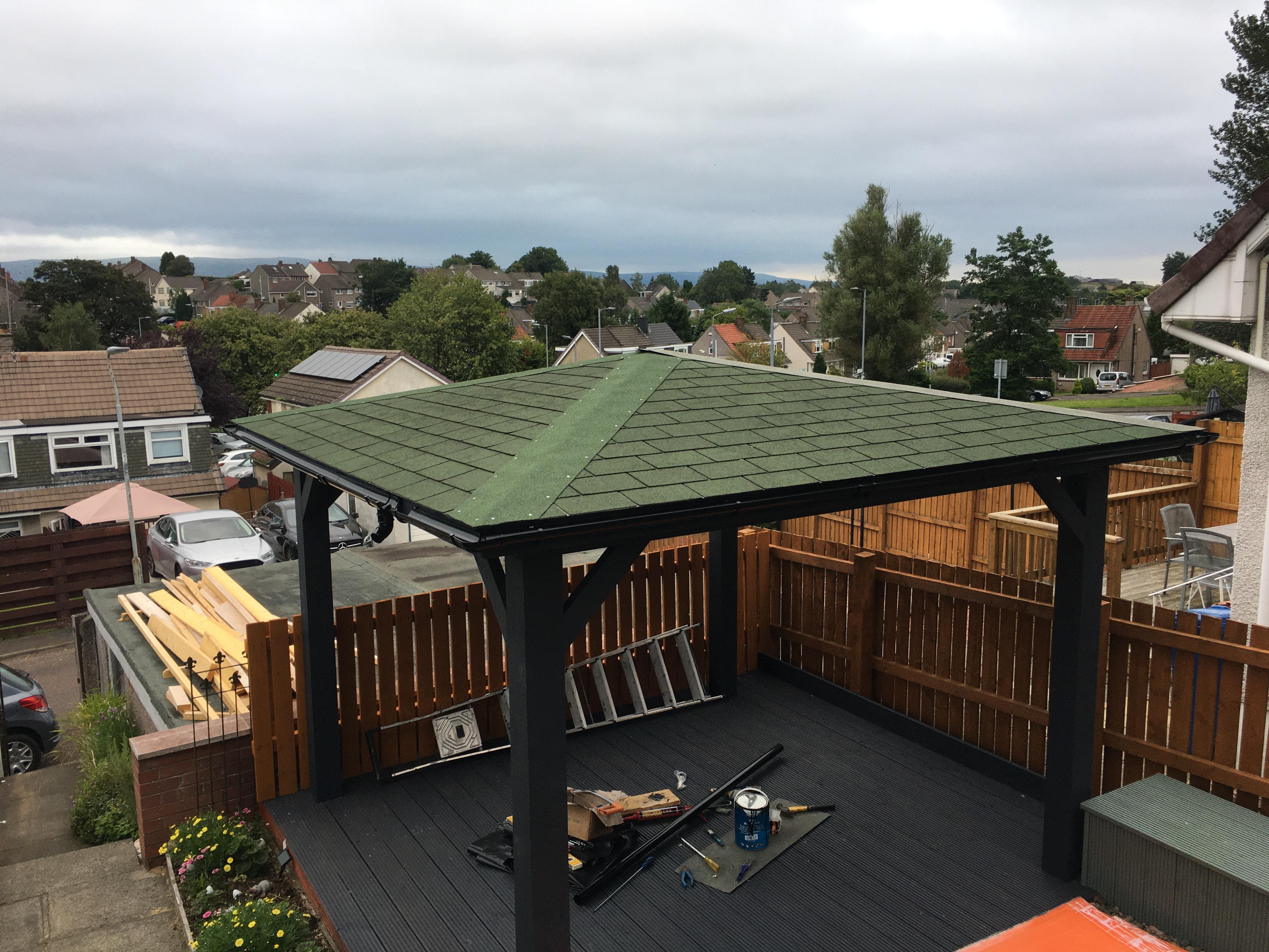

  9. Another weekend so got one side of the roof felt tiles on Should get the gutter on tomorrow but I’m having one downpipe as it’s only 13 sq/m Do I need a run on the gutter or just do it level, sides are 3.5m?

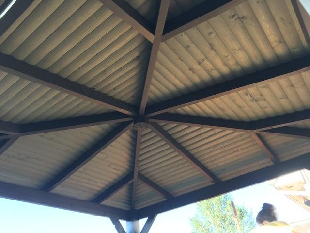

  13. Bon voyage BBQ Sunday so have to get a wiggle on... latest, it’s been pouring proper rain up here stopping progress BTW went for loglap for the roof, painted on the inside face, looks good

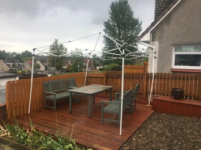

  19. Back from holiday, first time I’ve chosen Aberdeenshire, lovely people, lovely wee fishing village, everyone great with CV19 precautions and so nice to sit outside and have a pint. Anyhow, started today. Decided to drop the posts 500 below the decking, batten and screw into the joists then shutter around that and pour in a cement and stone mix. Think it will withstand the winter gales. Two of the big corner posts in, two more then the wall plate and I’ll post more pictures then
