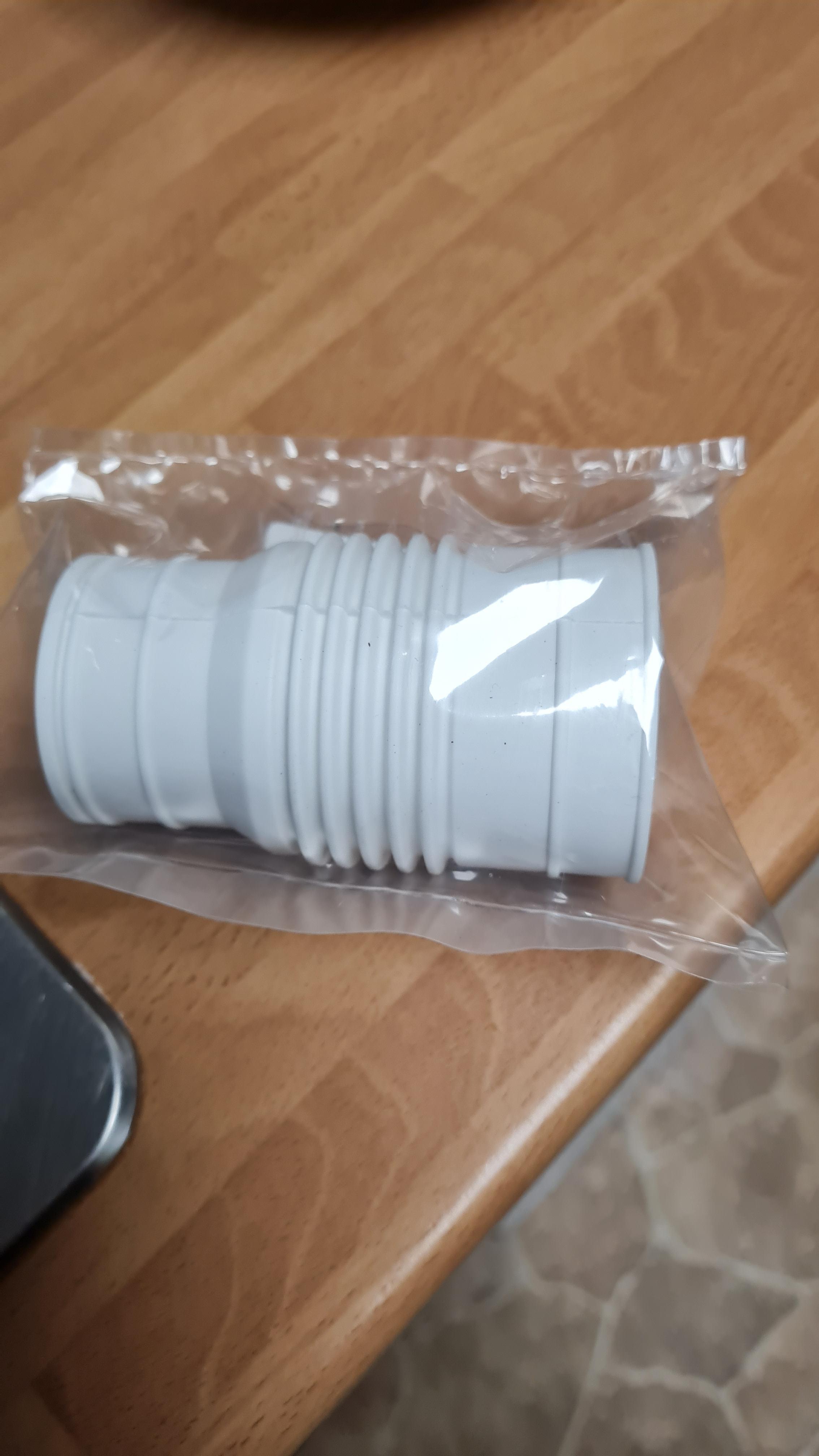

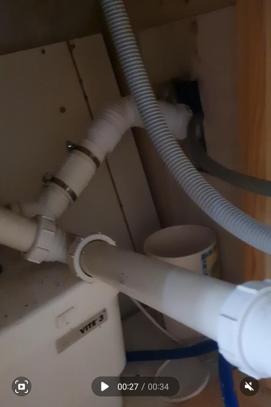

  3. To finish this off, the pipe in the wall had indentations from over tightened previous crocodile rings so solvent weld wasn't looking good. Used the McAlpine flexy with compression fitting and it held very tight. Now out the wall the end of the flexy was jointed to the existing using the rubber joiner from saniflow. Job done.

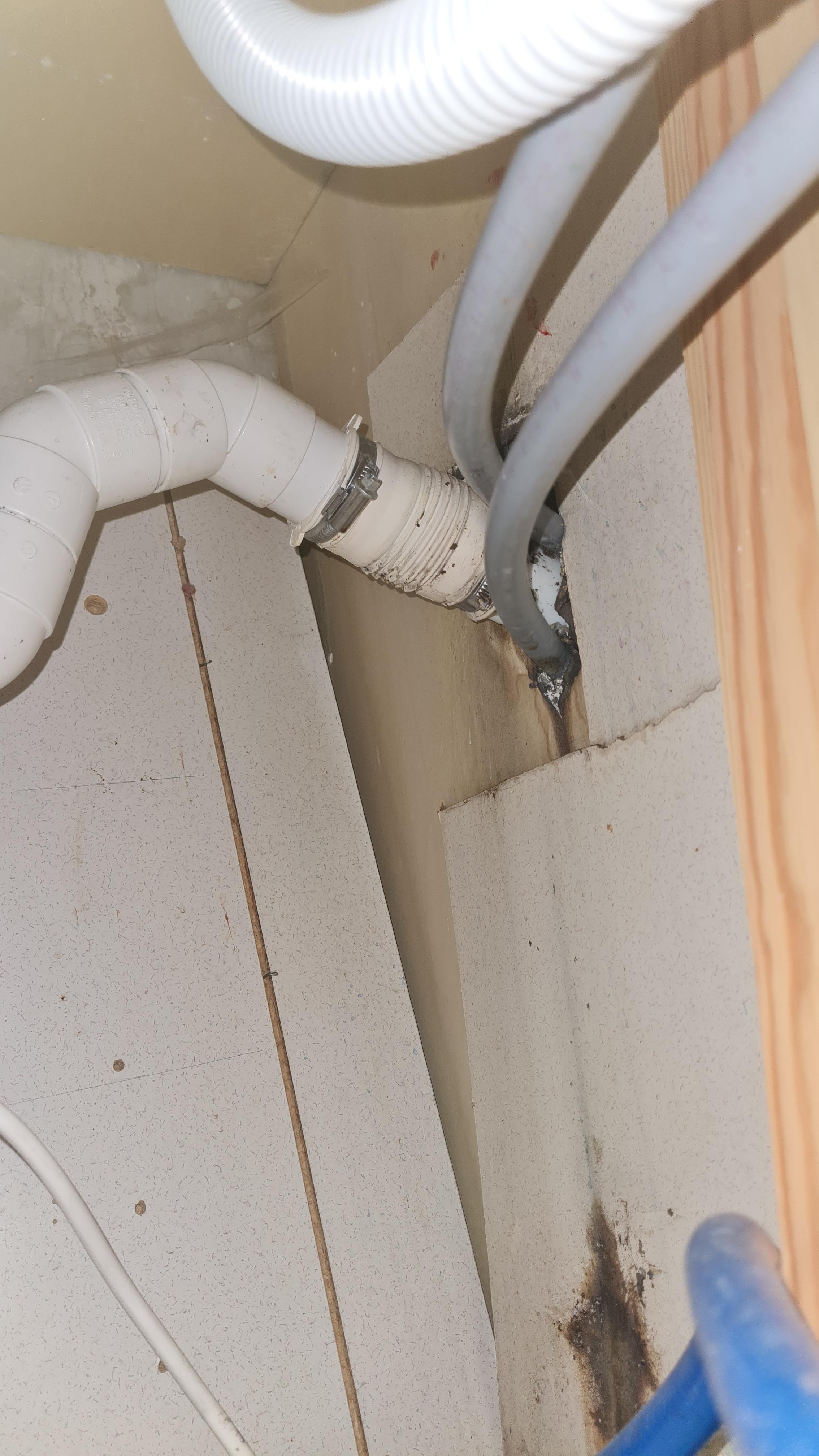

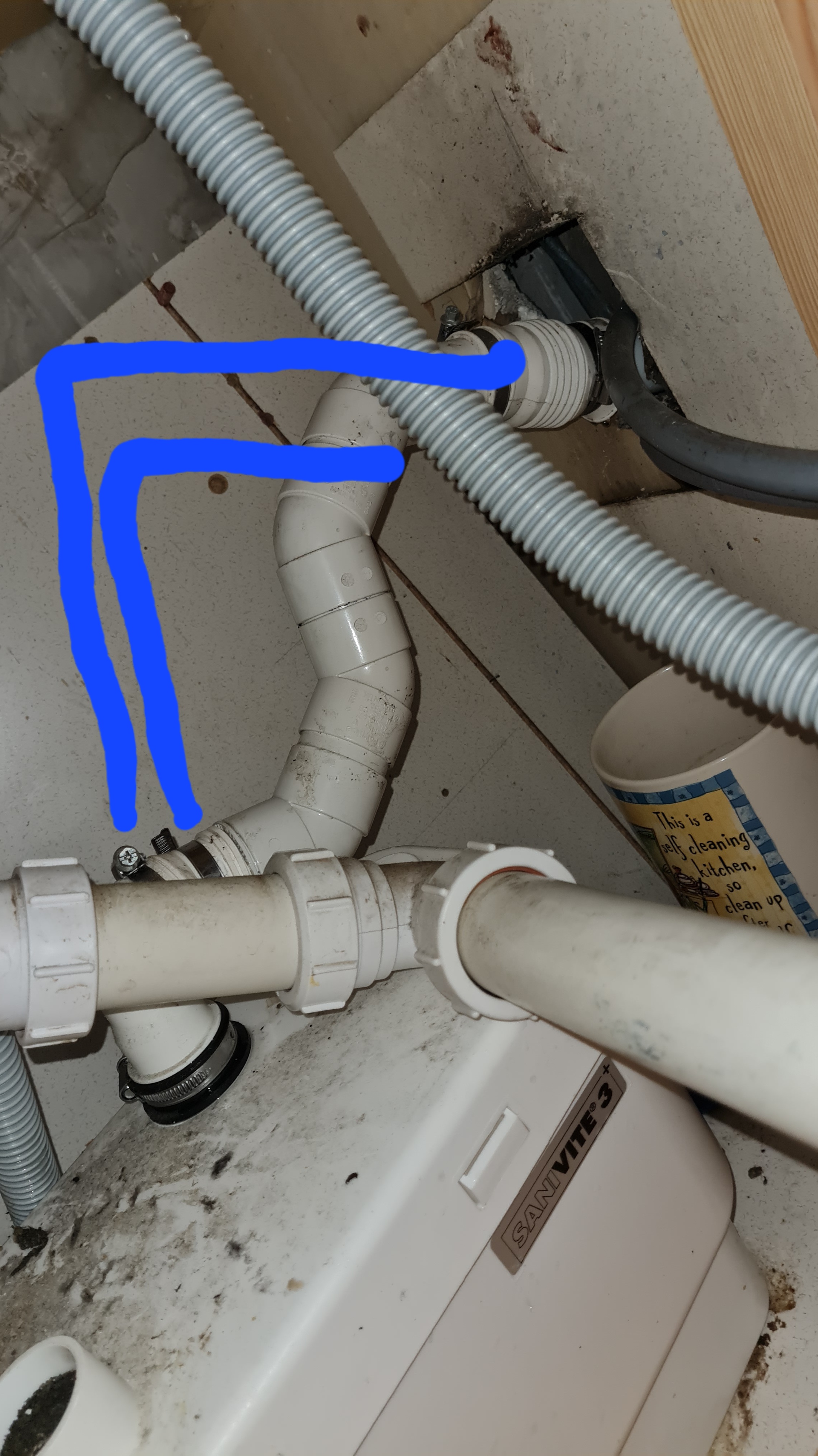

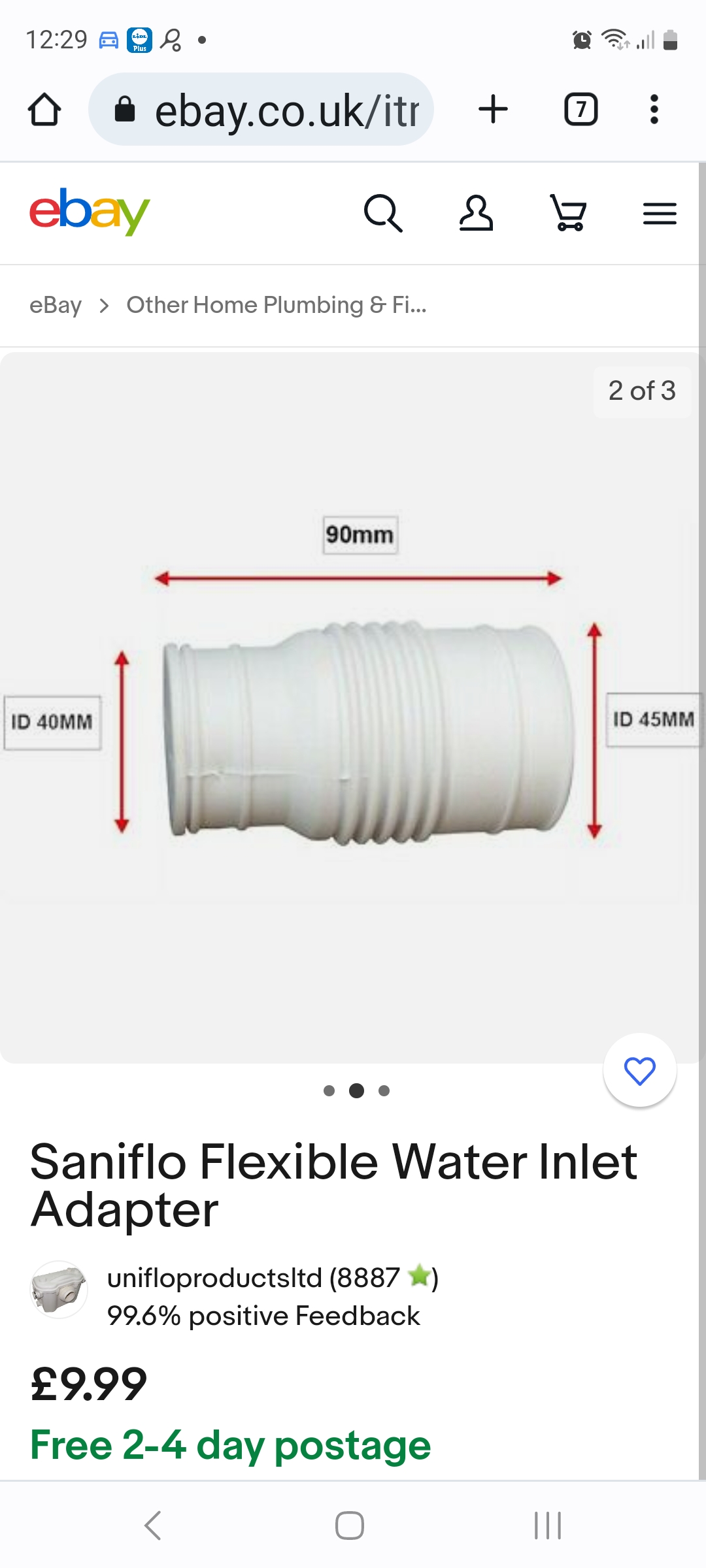

  7. Maybe @Nickfromwales What you don't see is the waste pipe 45mm that the rubber connector is jubilee clipped to. plan A, solvent weld from that back towards the saniflo then drop from 45 to 40mm and use existing rubber connection to the ugly (expletive deleted)er
  8. Well, fitted but it is still leaking. I need advice, can I replace this with solvent weld ?

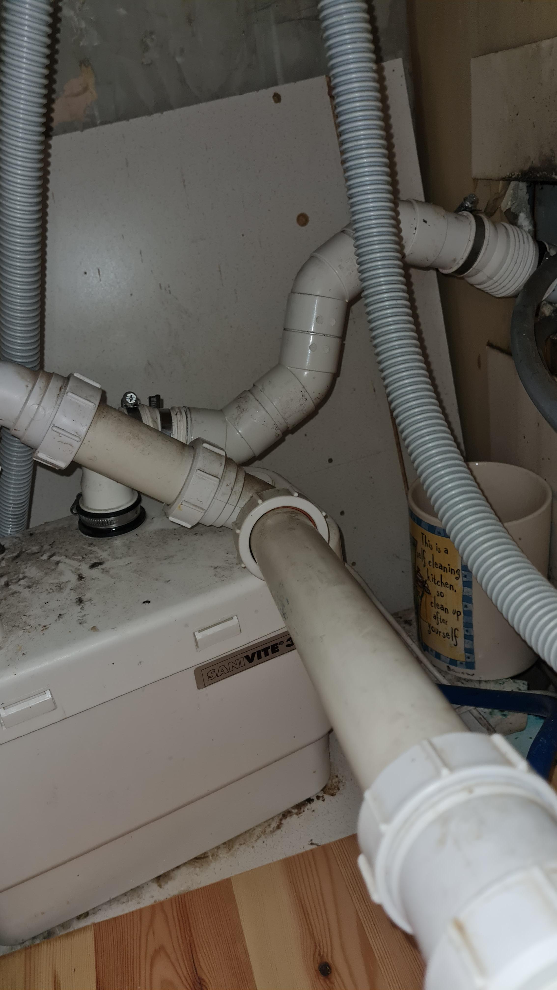

  9. I will update this in case it's of any interest to others...
  10. This is leaking and in operation as the pump burps the pipe moves so guess this is why we need the ribbed flexibility.
